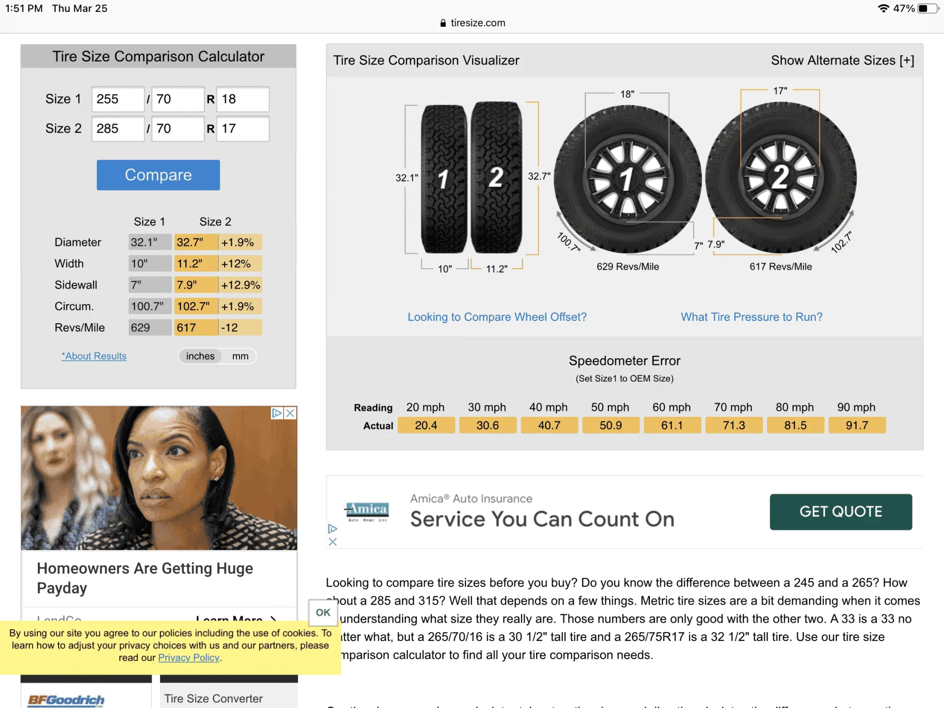

I think it's slightly bigger.
Sport and Sport S = 31.5 inch diameter 245/75R17 tires
Sport Altitude & Sahara = 32 inch diameter 255/70R18 tires
Rubicon = 33 inch diameter 285/70R17 tires

I legit went from stock Sahara, to stock Rubicon wheels/tires..
I believe stock Sahara tires are 31’s and Rubicon’s are 33’s, if that’s the only thing you are planning to do right now I would check your speed with an app like Speedbox or similar to see how far your speedo is off and I’m betting it’s only off by a few mph and if that’s the case I would not invest in anything but if you are say wanting to do LED’s, adjust TPMS limits or turn TPMS off along with a few other things that Tazer or JSCAN can do then it’s worth the coin.
Not much difference
