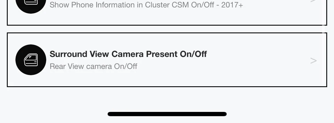

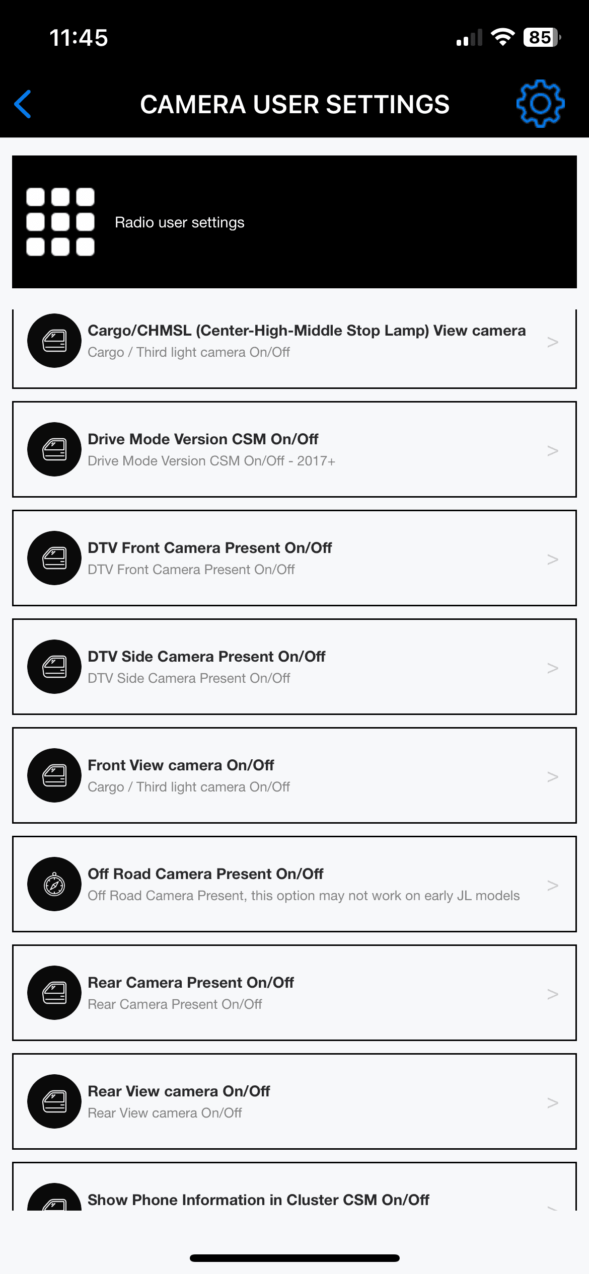

so looking through the jscan menu, there are two that are set to “deactivated”. the off-road cam and surround view camera. all others are set to active. do you think there is any harm in trying to set the off road cam to active in jscan and then proceed with the zauto cam install?
Fool with the settings. See if you can activate the frt. camera. If you can and want to do with JSCAN, do and then remarry / marry theTazer JL. No harm trying..
