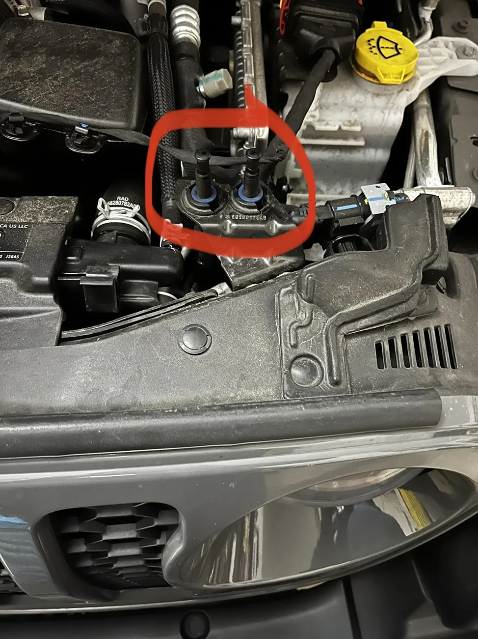

Tazer shouldn't cause faults with the system. The chances are one or both of your batteries are going bad, or it could also be something as stupid as the hood ajar plunger switch being out of position from the bent frame.
My 2016 KL started throwing " Stop Start Unavailable - Service Stop Start System" message on the cluster a few days ago. This is in spite of the fact that I keep the ESS off using an OBD2 dongle that remembers the last set ESS position. Checking the battery with a reputable tester revealed that it was at 65% State of Health, which wasn't surprising since that battery was about 4.5 years old. Changing the battery made the issue go away.
Also, check if the metal mounting plate for the two plunger switches aren't bent. My 2018 JLU with eTorque started displaying the same error message one day, and it turned out that the plate had bent slightly to the point where the plunger switches weren't fully being depressed when the hood was down and closed. That was fixed by replacing the switches and then bending the plate back into proper angle.
