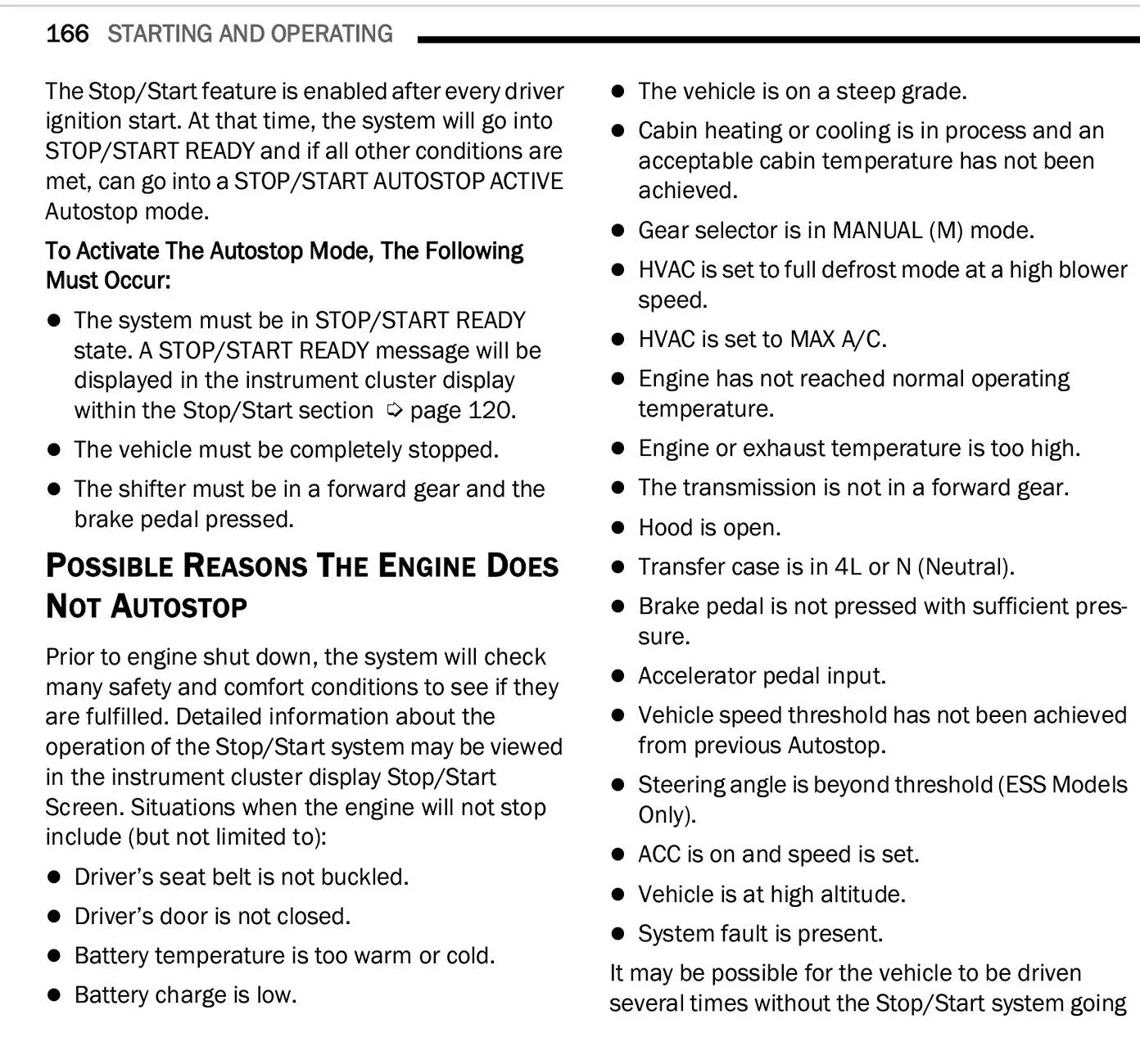

i got jscan and did what you did. but also disconnected the hood switch on the right when facing your jeep. when you turn your jeep on it warns you stop/stop is disabled and needs to be serviced. then display goes normal except for a small icon to the right your your miles display. i covered that warning light with black elec tape and have been happy. below is pic where i have service transmission issue cuz of dumb 19a clutch recall for my manual transmission but you can see the tape on my dash covering that warning light.
