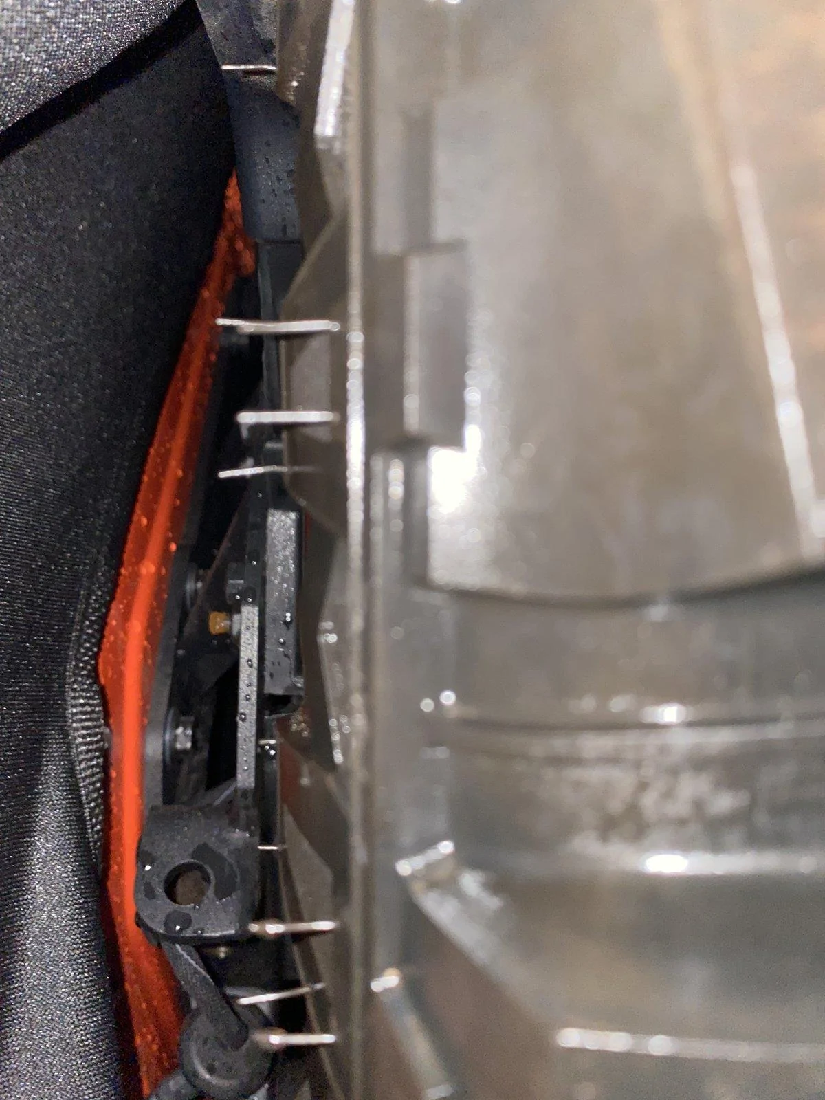

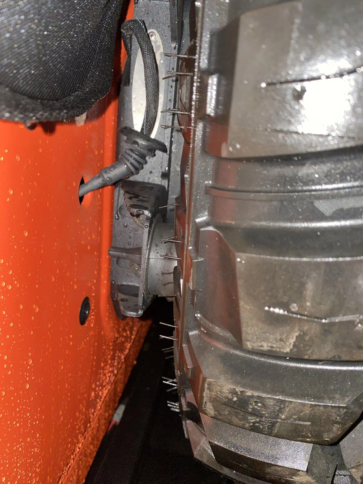

I recently upgraded the tires on my Sport (on Moab wheels) to 295/70R17 and got the Smittybilt relo bracket.
After installing it I tighten the lugs but the bump stops compress and compress, it doesn’t feel like it’s really tightening up against the carrier. I’ve attached a picture (yes I see the grommet for the wiring is loose).
Are the stock bump stops simply too long for this setup?

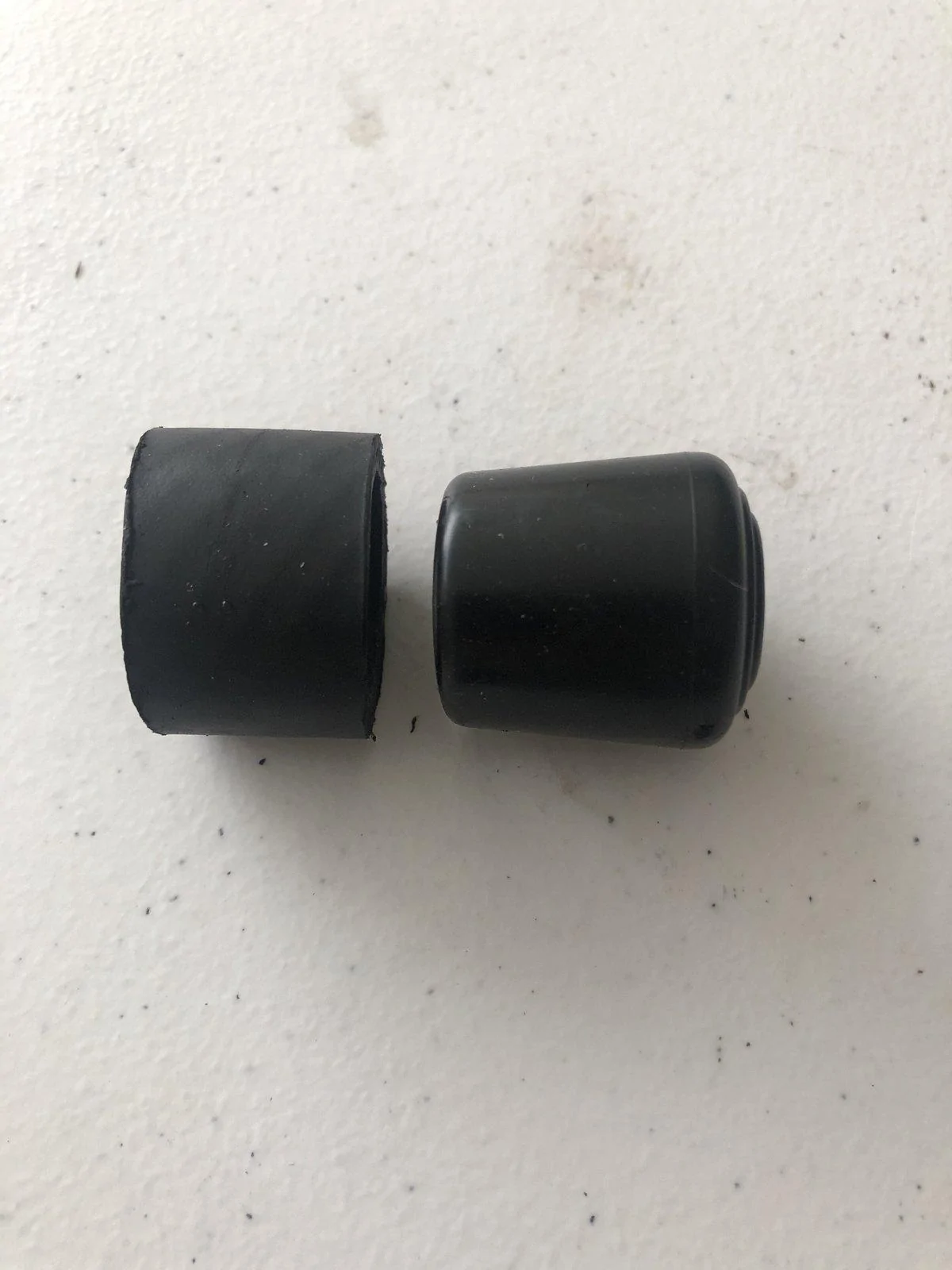

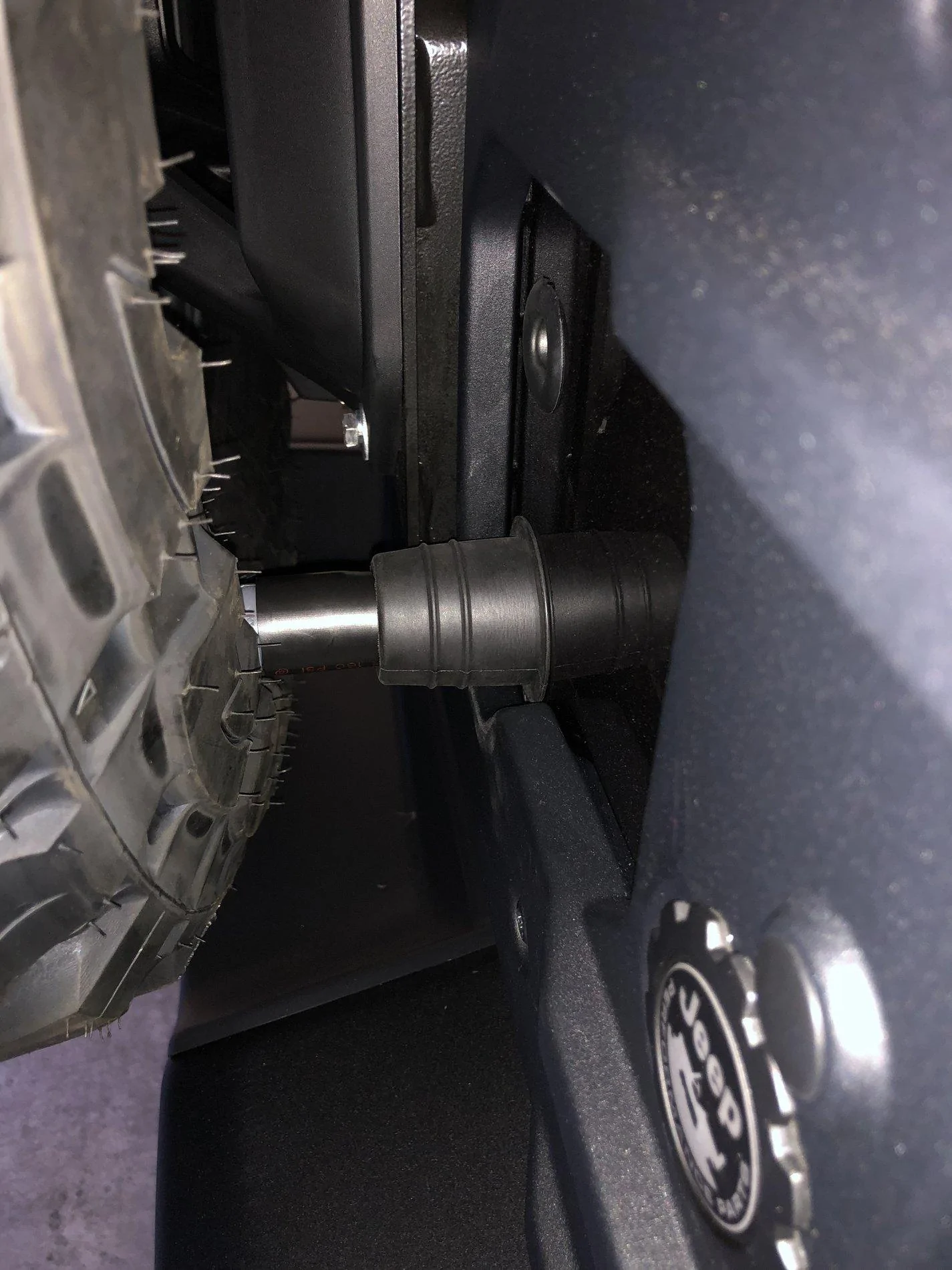

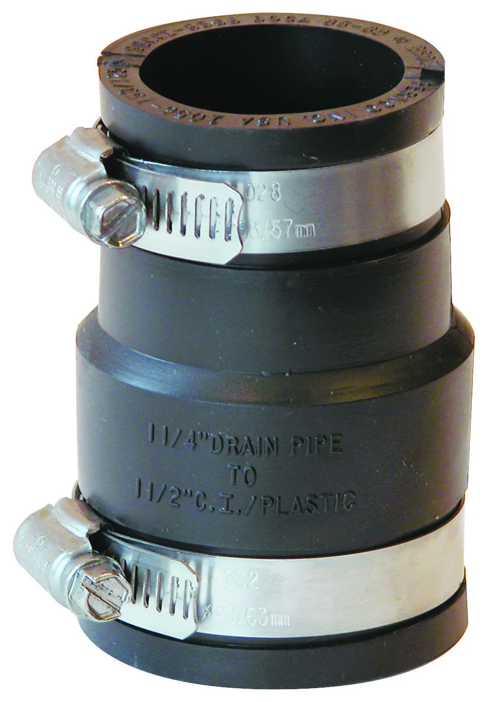

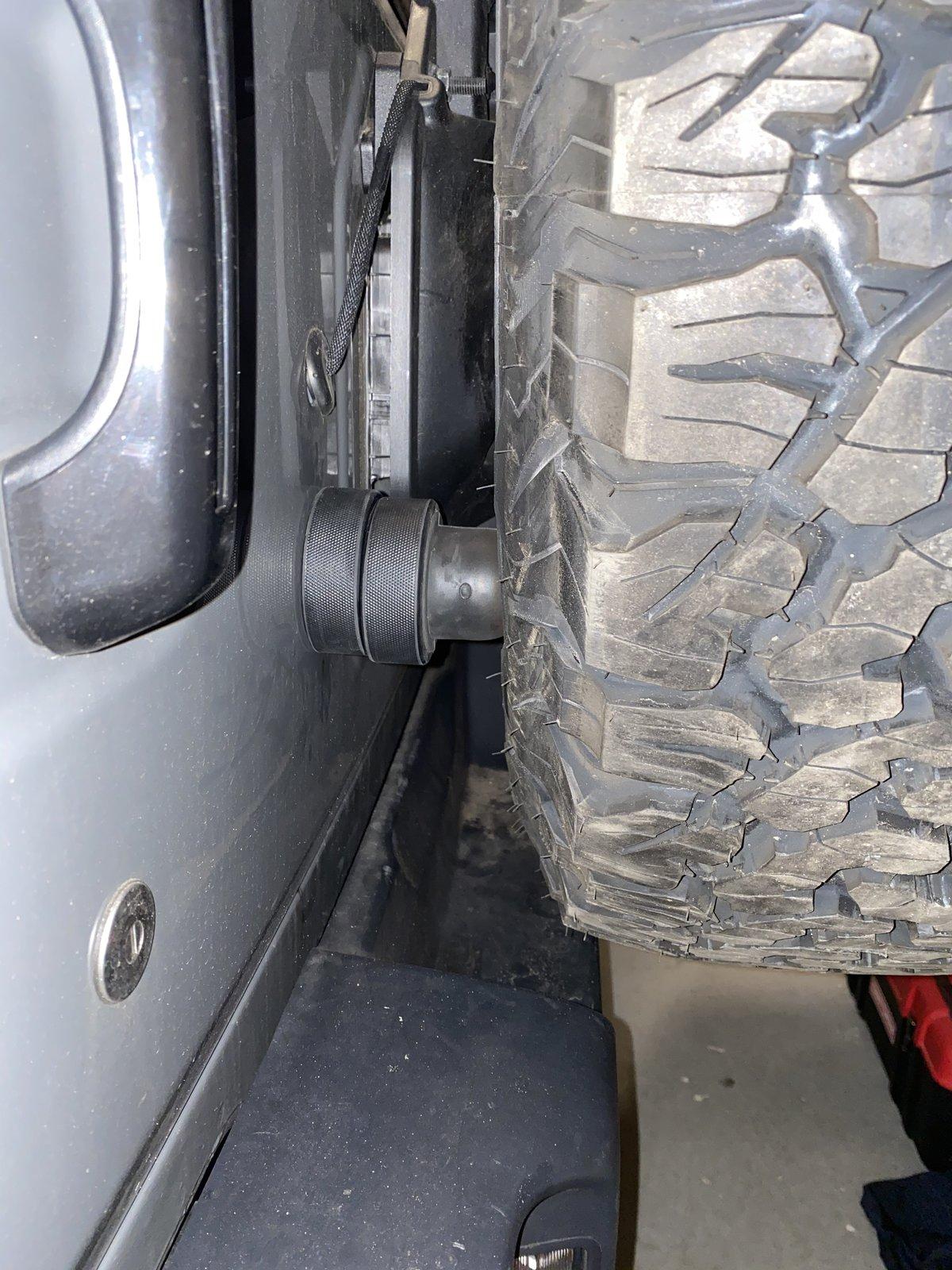

I had the same problem, I ended up using a 1.5" to 1.25" flexible PVC coupling. The 1.5" side fits completely over the original bump stop on the tailgait and it is longer than the original to accommodate my tire/wheel setup. The 1.25" side fits well against my tire. I thought it would be a little long but it compressed well when I tightened the tire on so no cutting needed. Cost me 12 dollars from ACE hardware and about 30 minutes of time from purchasing to installing. You can get a coupling that is just 1/5" on both side but I thought the one that went down to 1.25" appeared stronger. See pictures below:

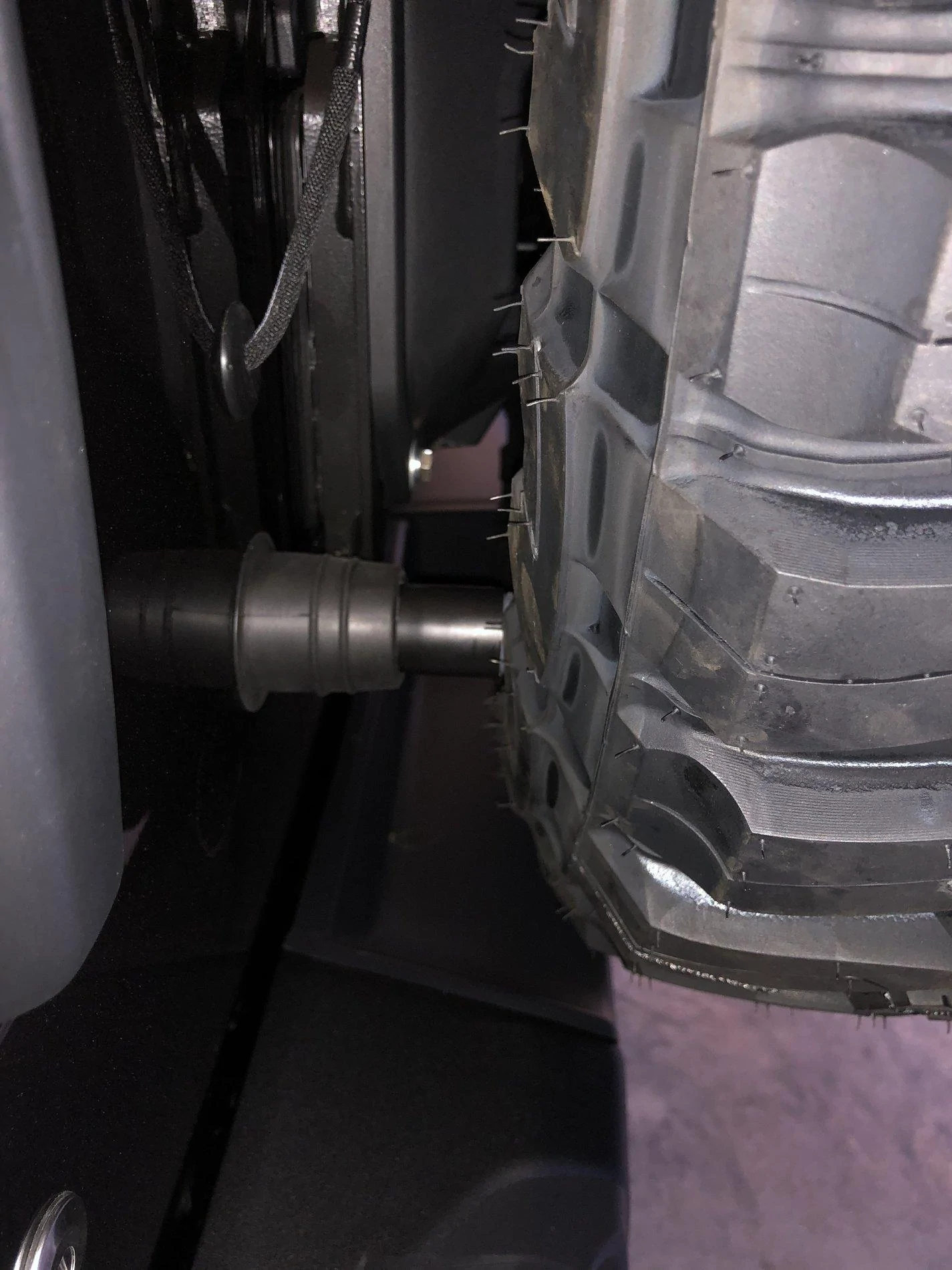

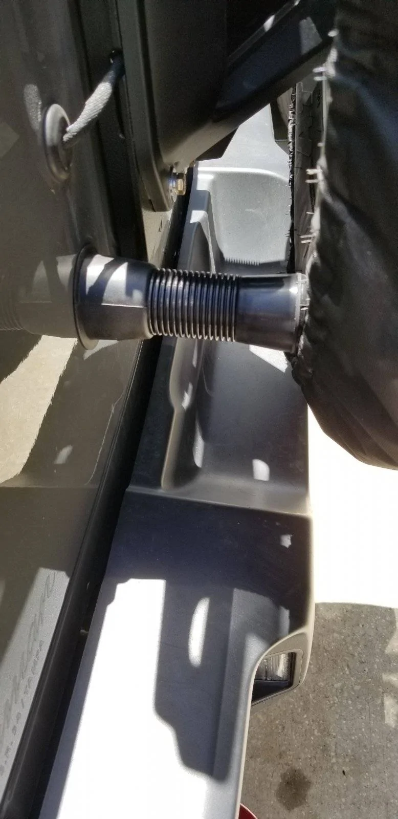

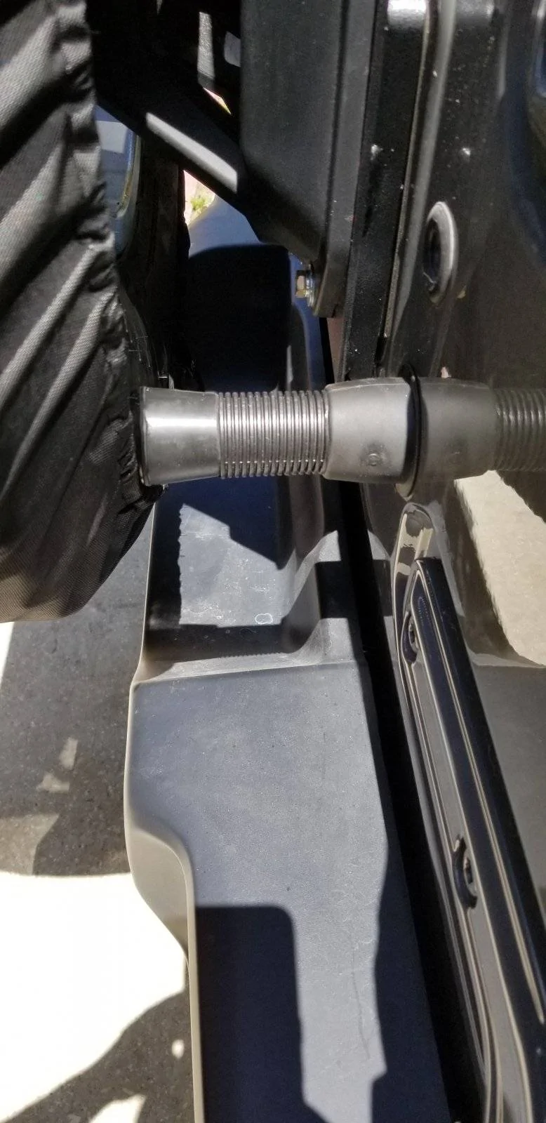

I had a big 4"gap on my spare with -38mm offset and got some 1" pvc and 1 1/4" rubber leg tips and covered the pvc with wire loom. Works like a charm!

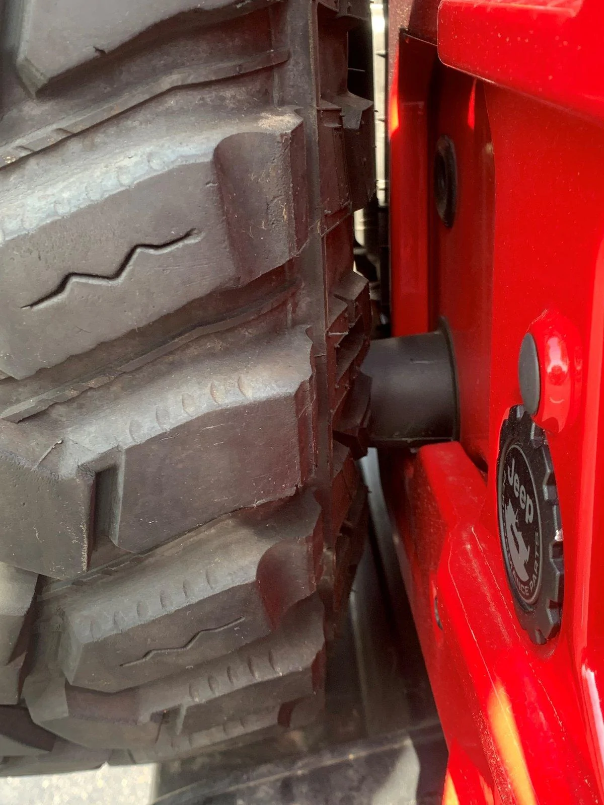

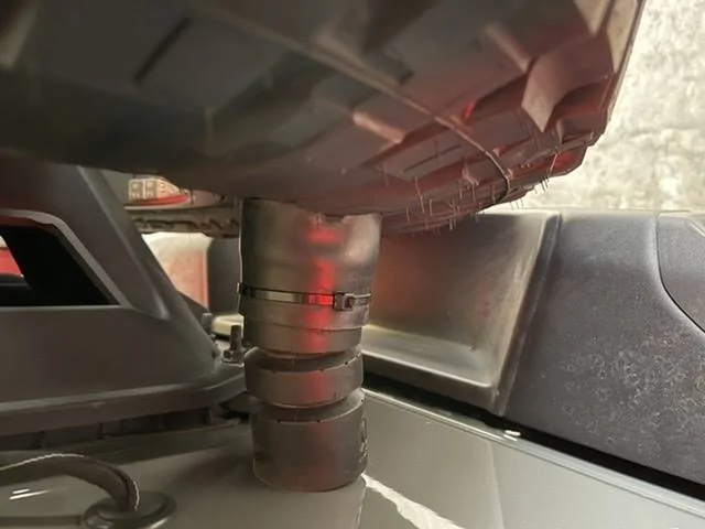

Here’s what I did for tailgate bump stop. Went to Menards and got 2” I.d. rubber plumbing connector. Put it on and zip tied it. Works great.

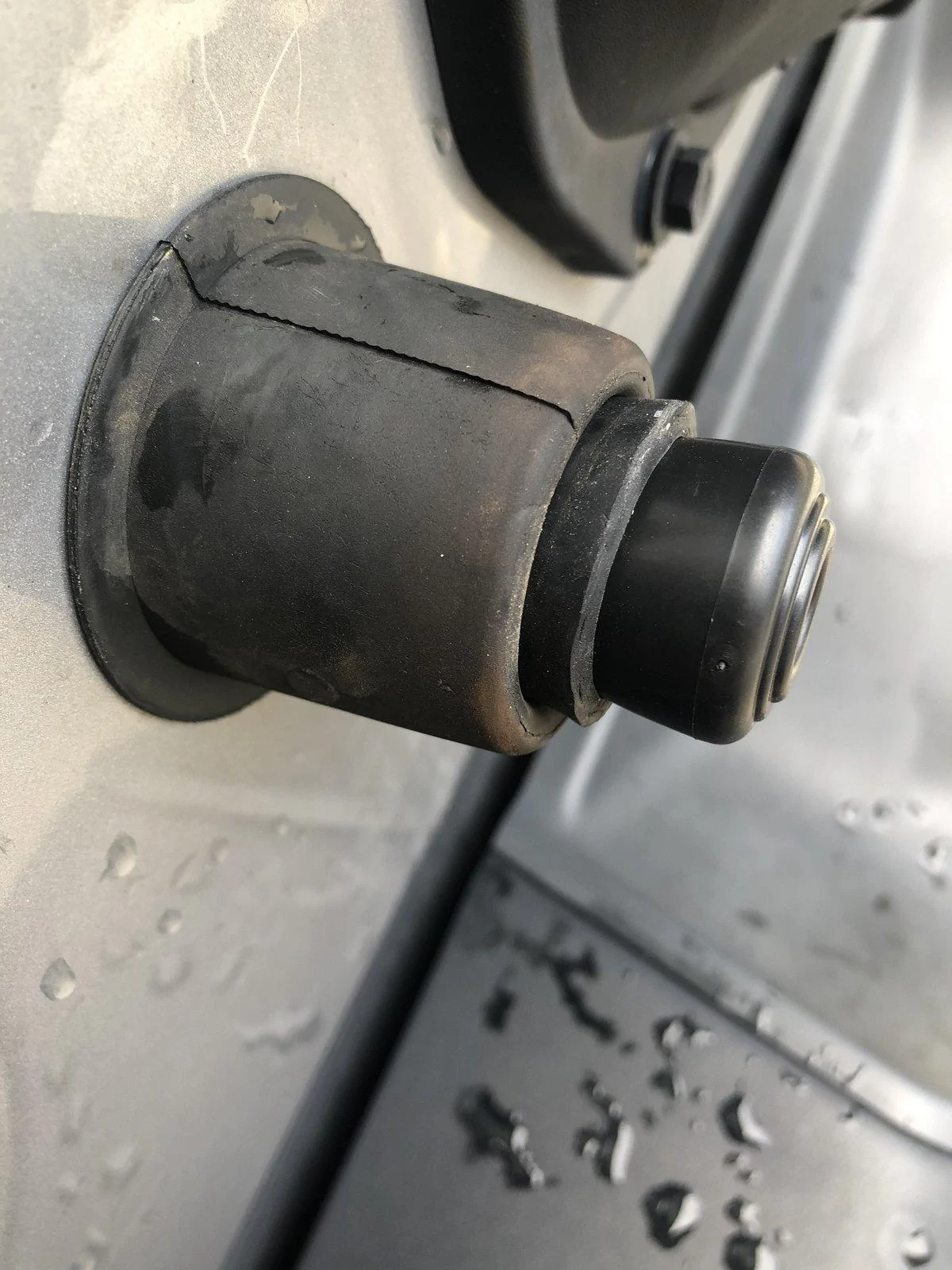

Using these based off your recommendation. I trimmed mine down a tad and also trimmed the insert part to get them on easier!
