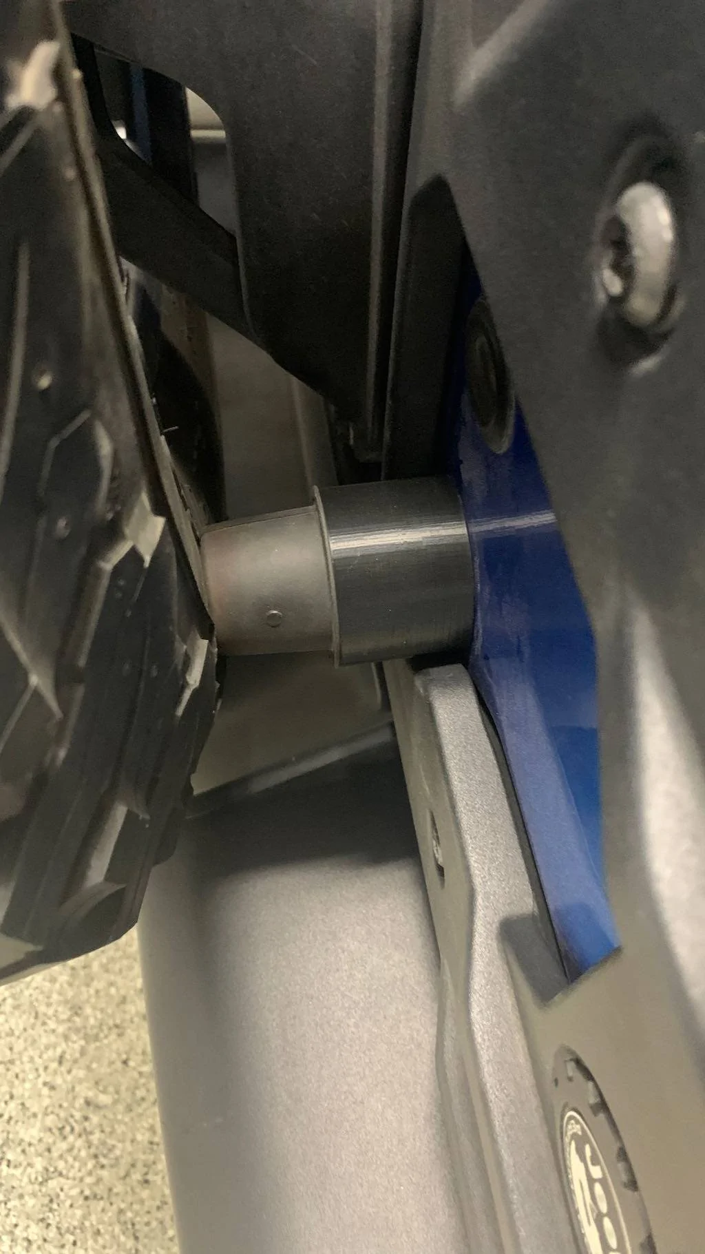

I ended up with this problem too, and 3D printed a pair of spacers that were the correct length & used the existing OEM rubber bump stops. It really didn't take much time at all, and I did a write up in the 3D Designer thread here: 3D Designer Section for 3D Printers
Here is a picture of how it turned out for anyone that wants to give it a try:
You could sell those puppies.

You’re absolutely right, the Teraflex carrier is a huge upgrade in every way. Since I don’t have a really heavy wheel tire combo though, I wanted something better than I’d seen solutions for, and didn’t feel I could justify the Teraflex solution yet. It’s currently as solid as it was from the factory, which made me feel better than leaving it dangle with no lower support.
PS. I didn’t figure the actual cost of the plastic it took to print these, but it was probably in the neighborhood of a couple dollars. That was a big contributing factor in why I went this direction.

Yeah I hear you. I was having problems with my backup sensors triggering off the spare too. It wasn't important enough for me to do more than disable the backup sensors until my wife backed into our daughters car.
It looks great too you did a nice job on your spacer so no digs on you there.
I'm curious how you got it to stick to the tailgate tbh.
That makes a lot of sense, and fortunately I haven’t ran into problems with my backup sensors yet. If I had I’d definitely be looking at a Teraflex carrier or something close.
The spacers are held to the tailgate through the existing holes, and I made a boss on the spacer to locate it in the same place as factory. I did a much longer write up on how I made them in the 3D design section here, and there is a picture showing exactly how they are retained:
