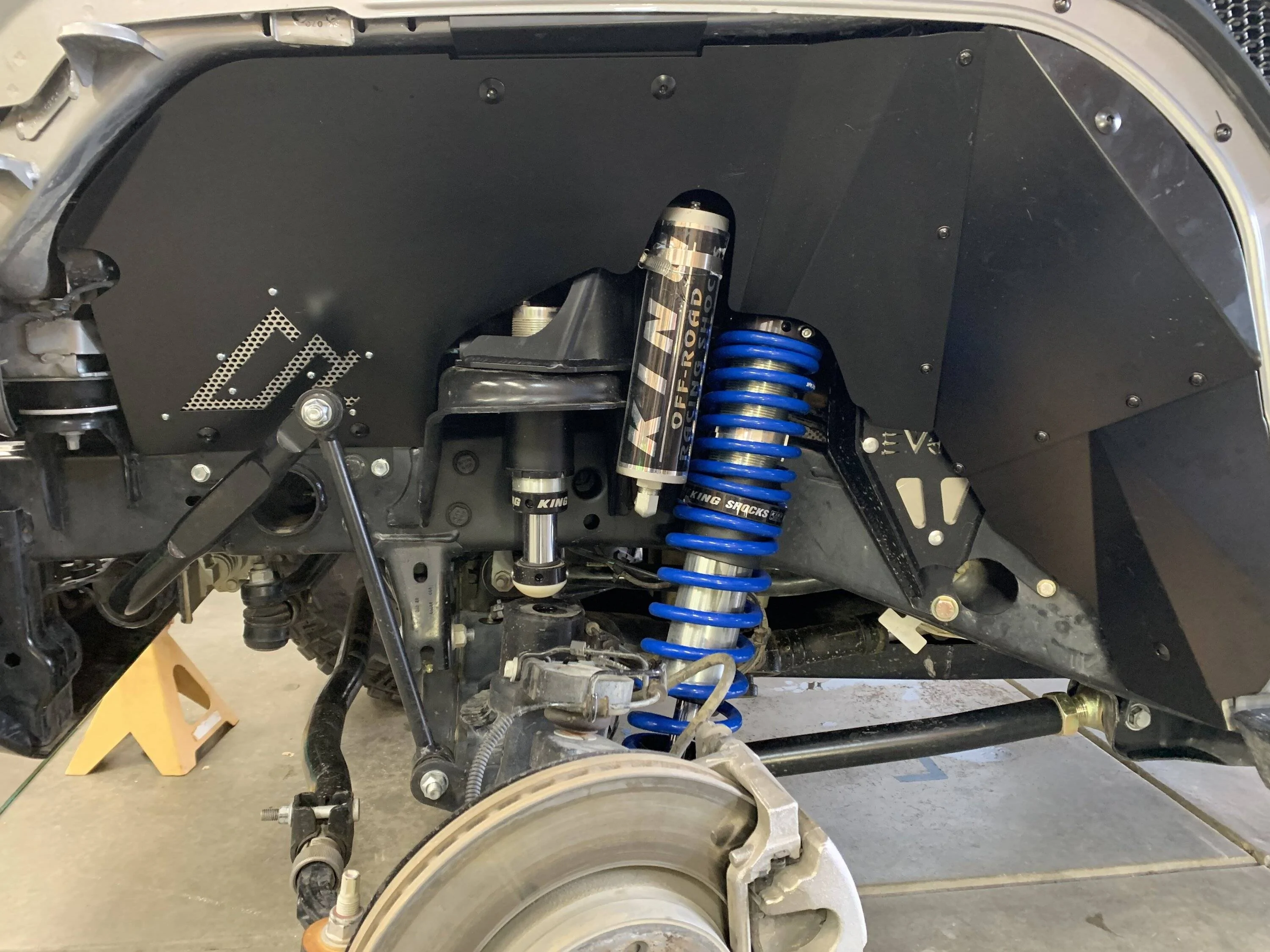

Coilovers are a great route and offer the most versatility. I have an Evo setup on my 392… but be prepared to open your pocketbook if you want to avoid adding limiting straps.
