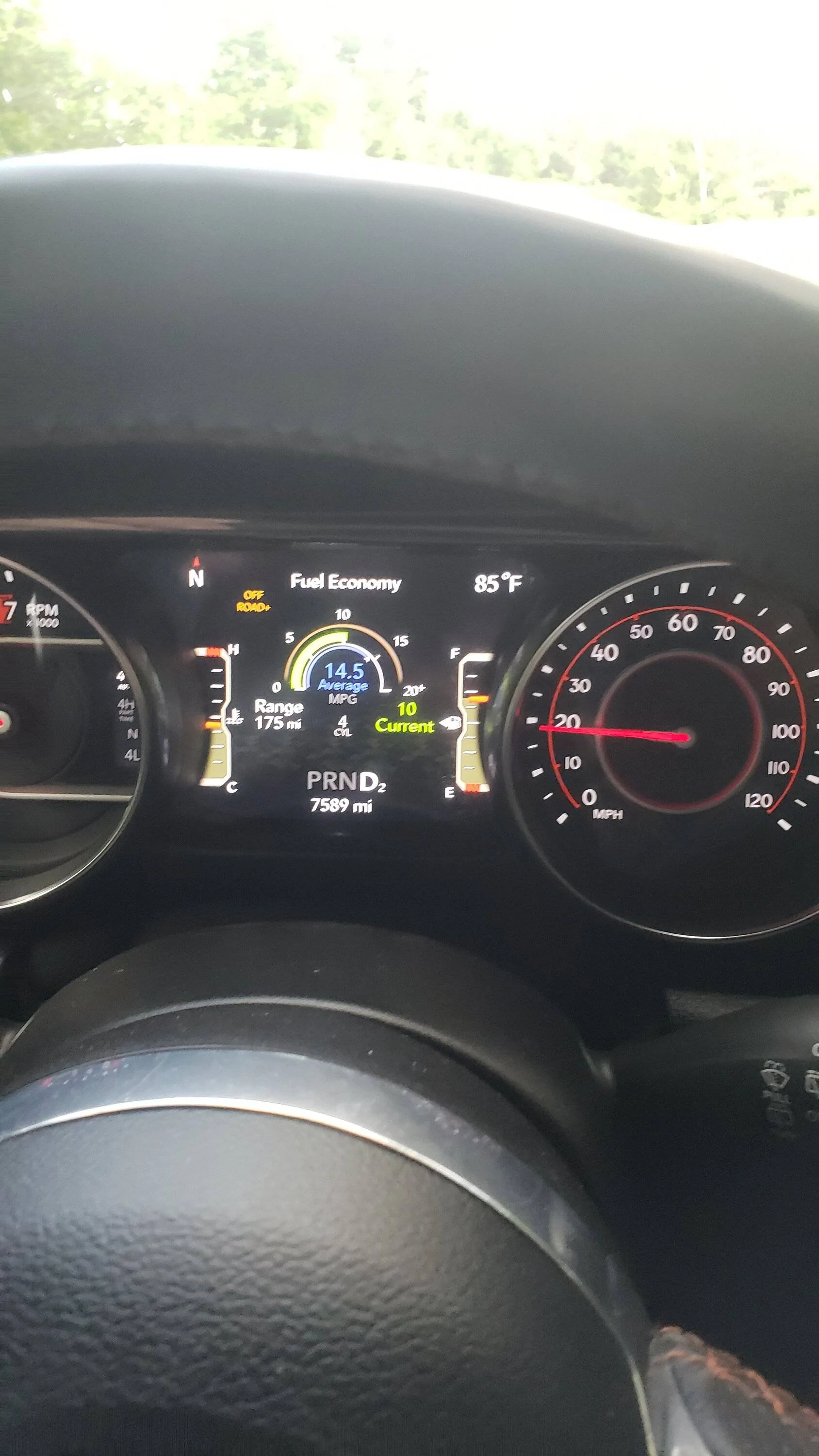

I have seen a few threads where people put mode into off road plus and it disables mds /4cyI. I can attest for me that is not the case. Mine has always been overly intrusive and very noticable audibly as well as physically doing the switch.
For clarity I am always in racoon mode so its much more noticeable.

Manual shift disables- only way l have found

Increases shift points and throttle response in 4-Auto similar to sport mode in my GC, unfortunately doesn’t similarly disable 4-cyl mode.
