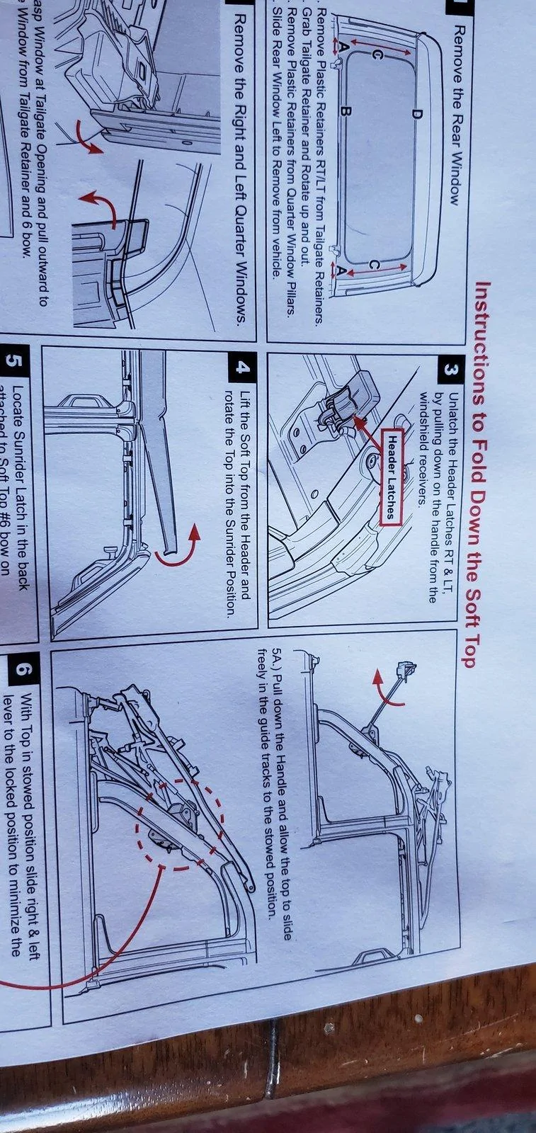

Ok, I just pulled out the owner's manual. It says nothing about this. Page 43 and 48 are listed as the only two pages concerning the soft top. In neither area does it really talk about sunrider position other than to say there are straps to hold it in place in the sunrider position
There is a supplemental that came with the Jeep new that has operational instructions and it says the exact OPPOSITE of this. I will attach a photo as proof.

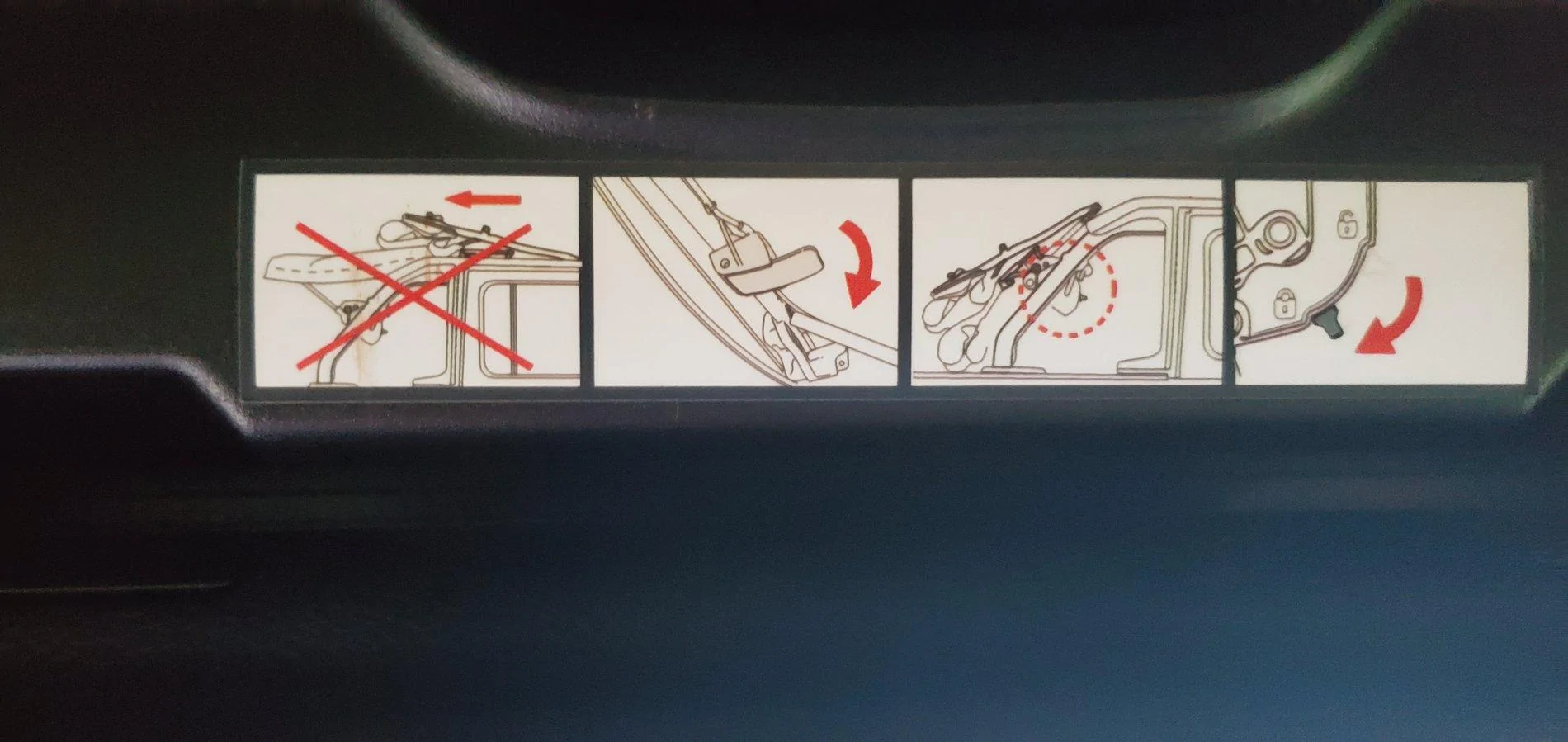

It clearly states in the supplemental " For sunrider feature follow steps 3&4 only." Steps 3 and 4 are to unlatch the front, then push it back. Then it shows clearly above the mirror on the top to NEVER operate sunrider only position without the windows on!
This whole post is nonsense.
Also - never operate the soft top in the sunrider position without the side windows on for one obvious reason, the reason they put that warning photo right there where you operate the latches. When you remove the side windows you are removing the hard plastic C pillars that are structural. The soft top back latch was never meant to hold the whole soft top up without the plastic C pillars by itself with 60mph winds!.
The safari look only works because the latches are on the front to hold it all in place.

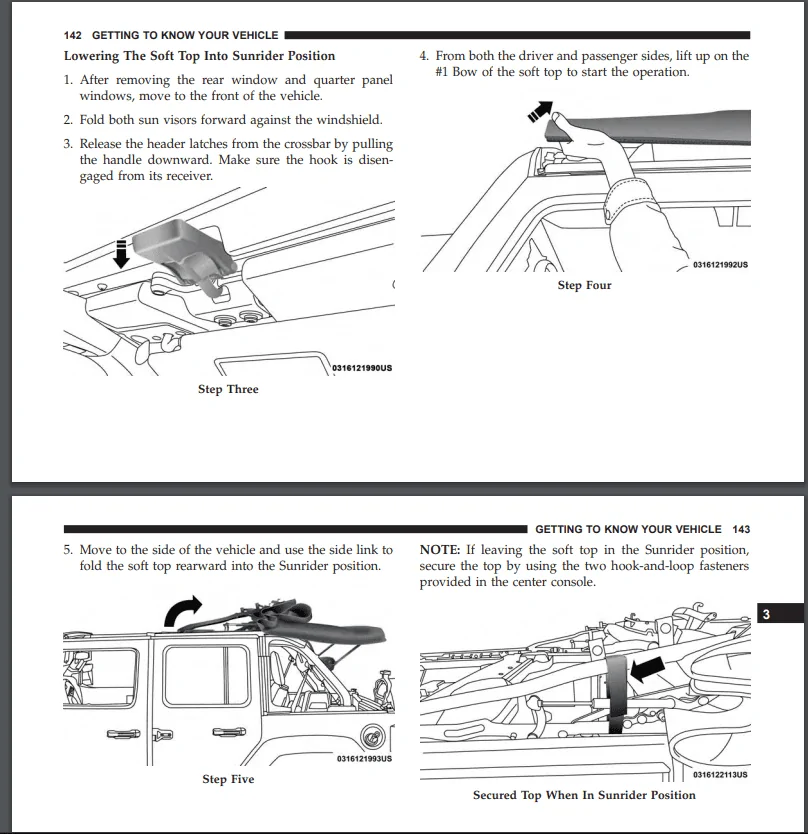

My jeep doesnt have that warning sticker nor does it mention that anywhere in the manual about not running sunrider with the windows out.
Ive done that a few times going 80+mph with no issues. Doesnt mean i should or that it wont break anything, it just means they better warranty it if it does since i dont have those restrictions listed anywhere lol
https://msmownerassets.z13.web.core...ications/en-us/Jeep/2018/Wrangler_JL/9510.pdf

Ok, I posted pics of the supplemental saying leave the windows on, and showed a photo of my brand new, one month old JL with that warning sticker on the actual soft top. Not sure how much more clear it could be. My guess - things were breaking so they put up the warning sticker. Do not run the soft top in sunrider position without the windows on.
Clear as day my manual, supplemental and warning sticker.
