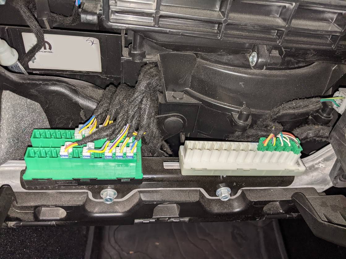

Do we know where they plug behind the glove box, witch terminal. We probably can do something there to at least slow them down.
My ObdII connector is not where it should be anymore, not impossible to reach but zip-tie higher. then have to find it et break/cut the zip-tie. would like to do something similar with the glovebox.
Pull the glove box, IIRC it's a white bus bar looking thing.
It's only 2 wires to connect to the canbus though. Nothing short of encasing that whole area in a metal box is going to slow them down. I wish they'd rollout that software patch.
I moved my STAR connector to a nearly unreachable spot. Will take them time to find/access it. Also have a locking cover over my OBD port. Among many other deterrents.
Found this image on google, from the forum!
Jeep Wrangler JL STOLEN!!! I hate thieves! connectors
I didn't have time to look at mine or the diagram. What I was thinking was to put couple zip-tie and hose clamp over, juste to mess them. They will tool, it will cost them time. Same thing with securing the glove box so it won't open easly.
Does anyone have any schematics of the connections? Can I use any of these to access can bus? I'm just trying to see how I could lock this down.
Edit: So it looks like it would be the high canbus system we would be looking at. I feel like @jmccorm might have some insight of ideas that could help with this
