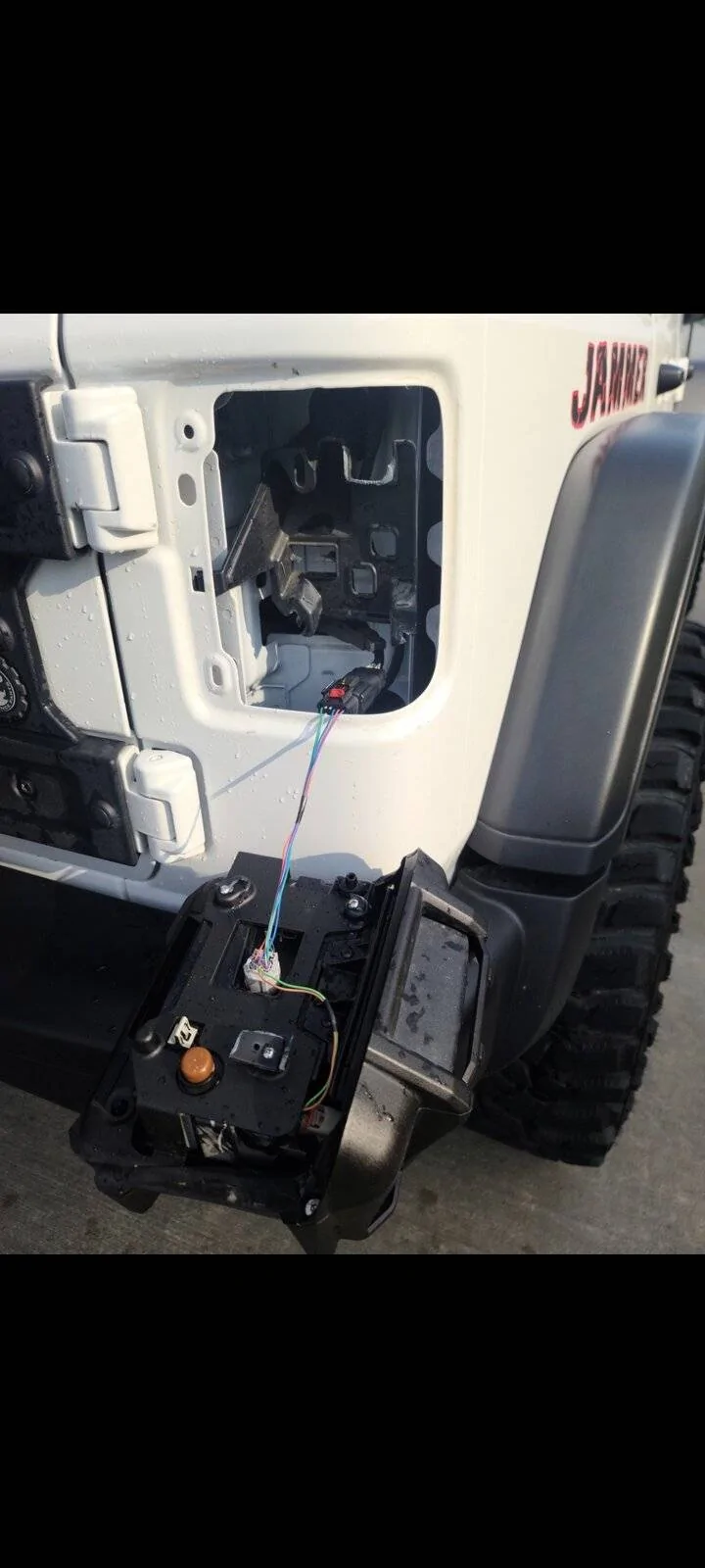

In case anyone is interested, the JL's tail light is secured to the JL with a single white plastic bolt that screws into the hole on the plastic piece, on the backside of the tail light, that is circled in the pic below..
The thief just prys on the rear tail light enough from outside of the JL... prys/tweaks... just enough to break the piece circled in blue.
Once the circled piece is broken, the tail light comes right off of the JL.
Is there an alternative for this piece, perhaps a metal option? I'm sure not but given this flaw there should be.

My dream car has been violated!! Thank you to the low life who stole my tail light. Also, they decided to cut the wire instead of just disconnecting the harness. I ordered the tail light ($760) , the harness ETA is end of FEBRUARY!!!! I rigged up a trailer light for now. I hope the motherf’er is happy. :angry:

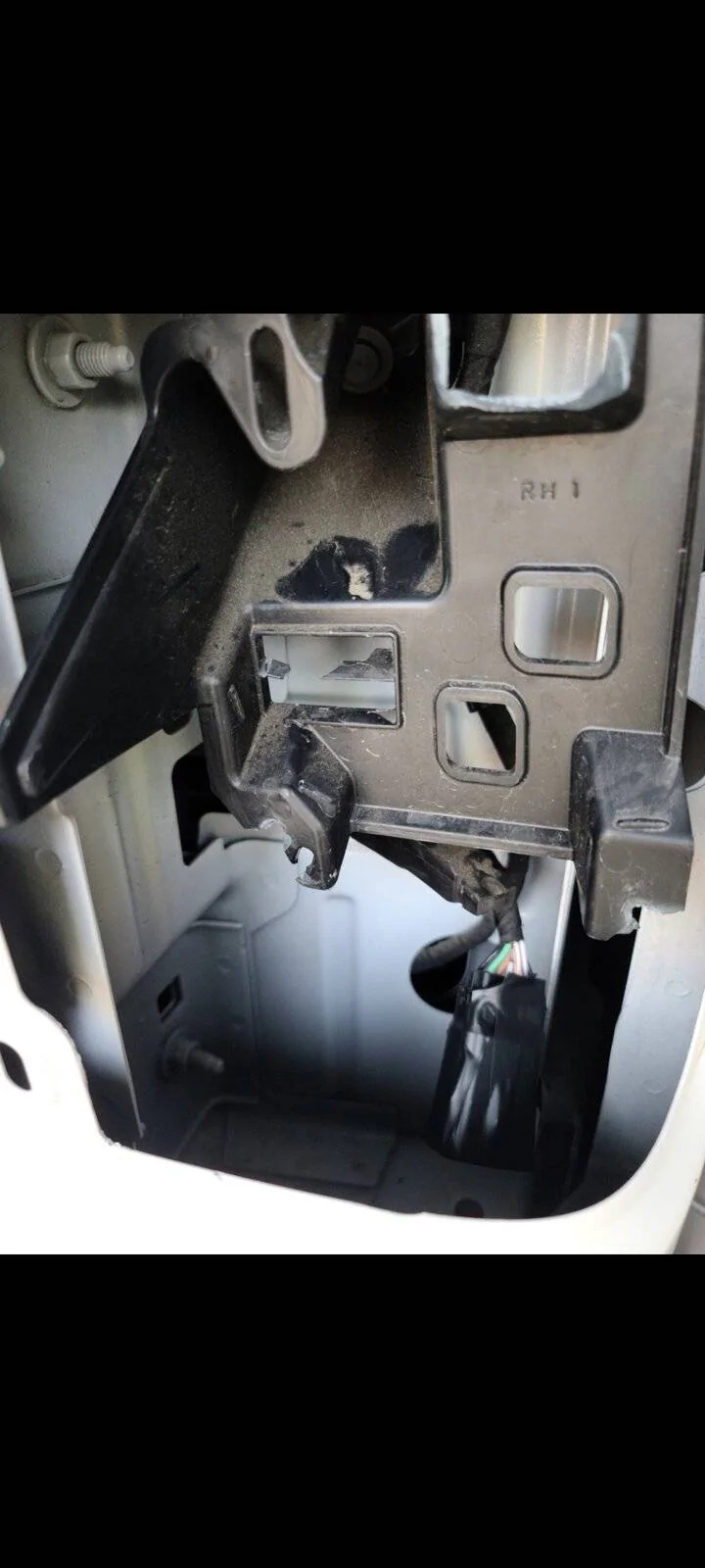

I guess you are right I do remember the car wash ripping mine out this is at the car wash. But I did have the rugged ridge metal guards on them and that's more or less what it caught on and ripped it out and it was metal but I took the metal guards off and did not put it back on.Been going there for 3 years once a week sometimes twice a week with my unlimited washes for $12 a month. So I'll probably been there a hundred times or more and the one time it caught on something and rippee it out. I bought that plastic piece for about 15 bucks at the parts counter at the dealer and a friend of mine that works there put it on for me it was that plastic piece inside luckily I undid the wire and your situation they cut the wire too that sucks
