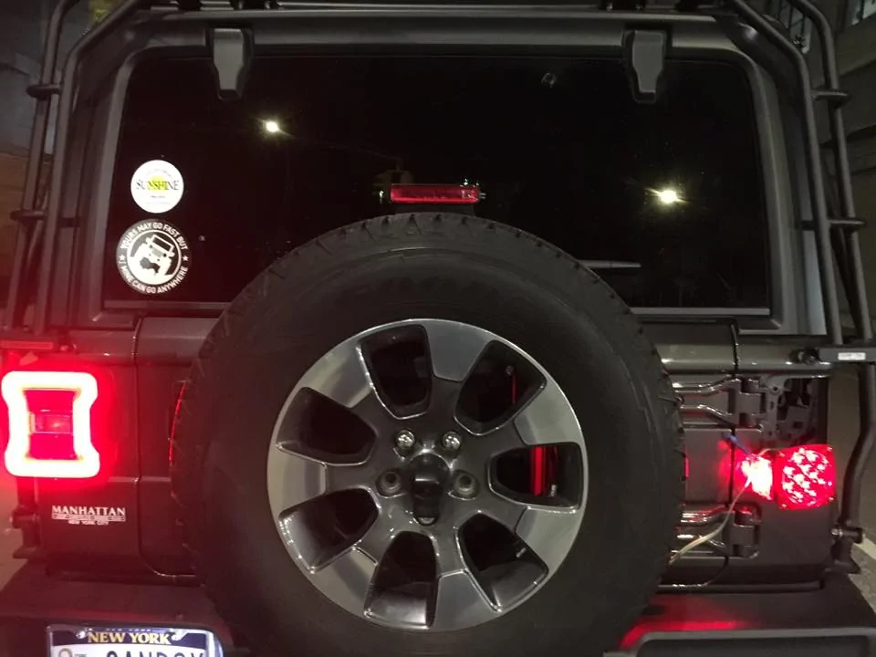

**TAIL LIGHT UPDATE** The wiring harness came in super quick and got it all fixed last week. Total was $1500 including the temporary tow light I rigged up. Funny story, of course with the dealer. Service rep calls me and says, "it looks like somebody stole your tail light so i's not covered under your warranty" :CWL::CWL::CWL::headbang::headbang::headbang:

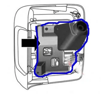

In case anyone is interested, the JL's tail light is secured to the JL with a single white plastic bolt that screws into the hole on the plastic piece, on the backside of the tail light, that is circled in the pic below..
The thief just prys on the rear tail light enough from outside of the JL... prys/tweaks... just enough to break the piece circled in blue.
Once the circled piece is broken, the tail light comes right off of the JL.

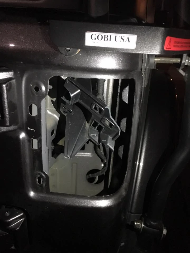

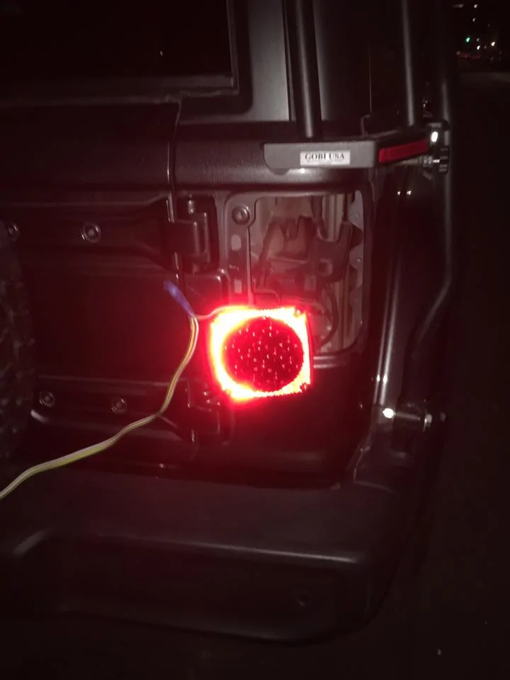

My dream car has been violated!! Thank you to the low life who stole my tail light. Also, they decided to cut the wire instead of just disconnecting the harness. I ordered the tail light ($760) , the harness ETA is end of FEBRUARY!!!! I rigged up a trailer light for now. I hope the motherf’er is happy. :angry:
