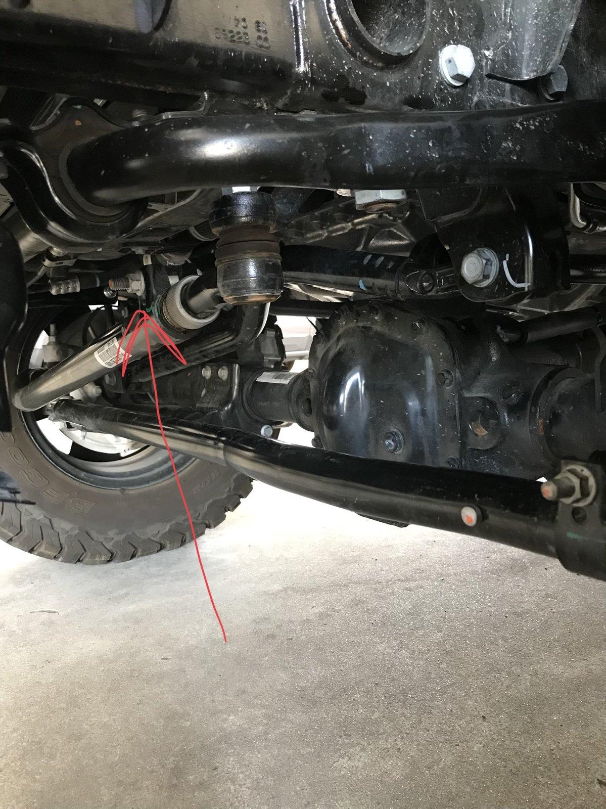

Easy fix without going to an alignment shop, you just need to adjust the drag link. Take a 15MM wrench and loosen the clamp on the drag link. To move the steering wheel to the right, rotate the adjustment clamp down. Have someone watching the steering wheel until it moves back to center, then tighten the clamp back up.
I did this myself after a lift. One bolt- you can do it by just laying under your front bumper. Super easy.
Here’s a pic of where:
Yep, super easy and I'd recommend getting a large set of pliers to turn that collar with. You can do it by hand but it takes a lot of force and it's easier to move in small increments with the control of a set of adjustable pliers.
Go slow because small adjustments make big changes at the steering wheel.
It may take a few attempts and drive tests to get it where you want it.

I can attest that adjusting the drag link is extremely easy. I have never done anything like that in my life and I just did it. Piece of cake. I put a bright piece of tape on the center of the steering wheel where I could see it from the front of the Jeep, and then adjusted it until it was in the middle. :)

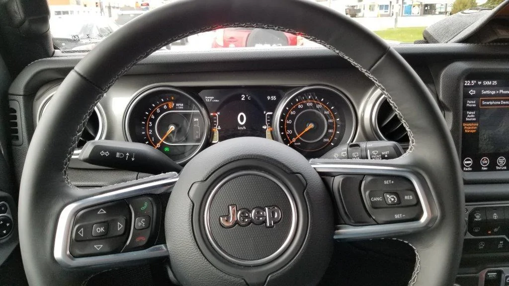

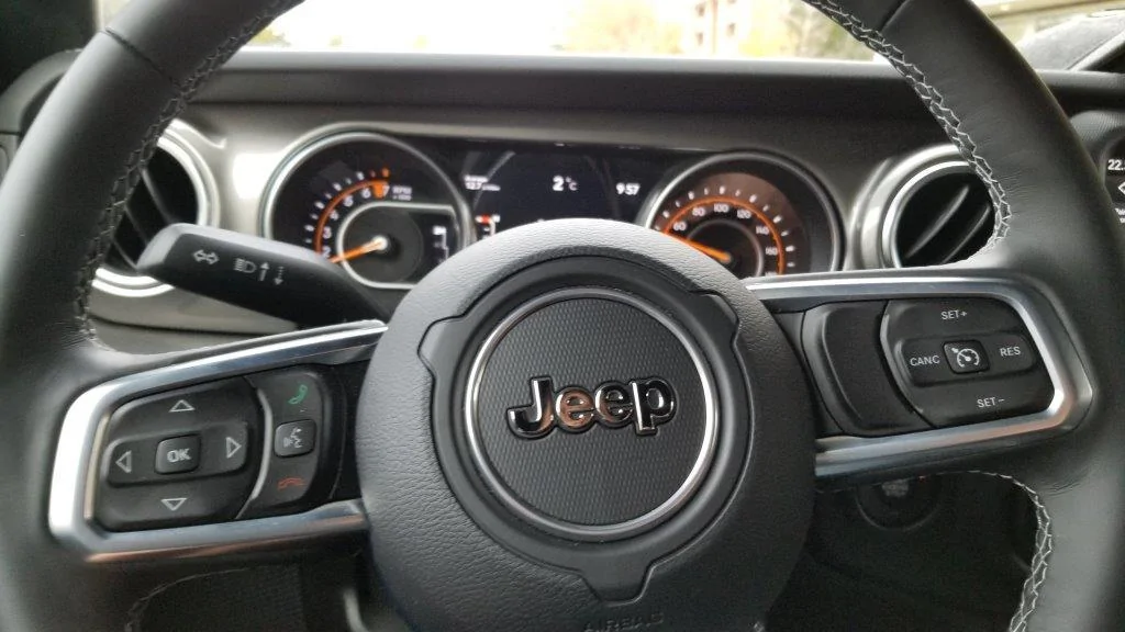

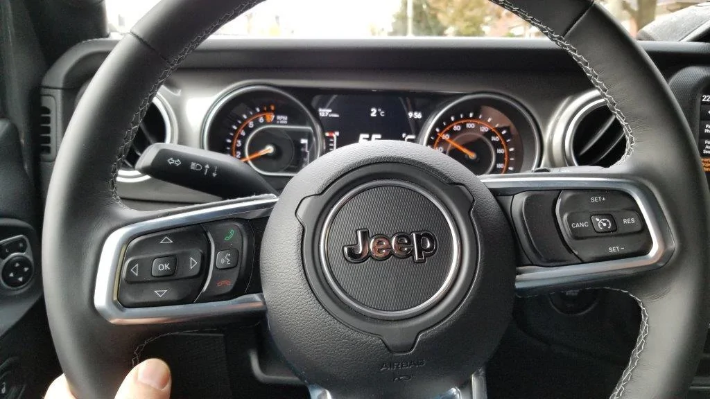

First of all, this is not about loose steering. I don't have the loose steering like some. My Jeep steering feels quite good. The vehicle tracks nicely down the road and will gradually veer to the right, as it should depending on the amount of road crossfall the lane has.
This may just be my OCD.
I have included a few pictures to show the position I need to hold the steering wheel in order to drive straight. Is this the same as the yours?
In the pics I am driving in the right hand lane with a typical crossfall.
If I drive in the left lane (opposite road crossfall) I then hold the steering wheel horizontal.
The dealership checked everything this morning. Alignment, tire pressure and test drive. They tell me it's within spec and couldn't find anything wrong.
Again, this is not a big deal. the Jeep doesn't pull. Tracking is ok and tires are balanced.
Live with it or get a second opinion?
Thanks
