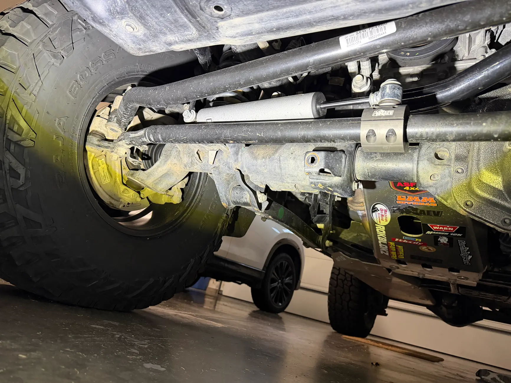

I had no issue with oem one but decided to go for some extra bling and did the AEV (bilstein) and truly no difference. OEM was great AEV is no different...if you could do a blind test and drive both without knowing which was which you would not be able to detect a difference...I have zero pull with either..I have used the 3 sets of tires with the AEV stabilizer and can report no difference between sets of tires either.
Jeep Wrangler JL steering  stablizer tempImagejBjTrB
no hands video..
