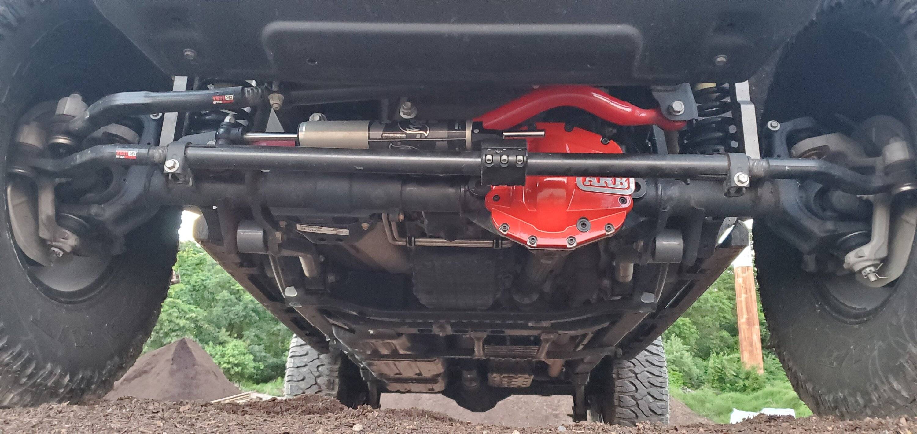

I personally use the SteerSmarts relocation bracket for the axle end. It's a double sheer design for added strength, and it allows the bushing to work radially as the tie rod moves fore and aft vs it misaligning like with the Synergy mounting stud. Here's a link and a pic of the Fox TS that has been serving me very well for 63k miles and two sets of steering linkages...

Jeep Wrangler JL Steering stabilizer relocation on a JLUR XR question 20200613_202559
Jeep Wrangler JL Steering stabilizer relocation on a JLUR XR question 20211013_132423
