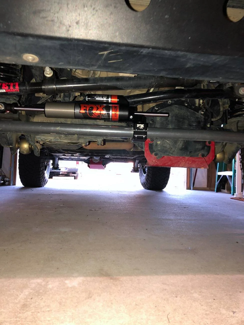

That’s what a lot of guys are doing, including me….. just make sure to get the right size clamp if you have an aftermarket tie rod…
Old pic for reference, running a different setup now…..
That's kind of what I thought. Thanks for confirming. Did you need a special bolt at the drag link mount or did it come with it?

Mine came with a track bar bolt years ago…. You can use any axle side bracket you want though… I wouldn’t recommend MC , it’s designed to work with its own tie rod clamp…
