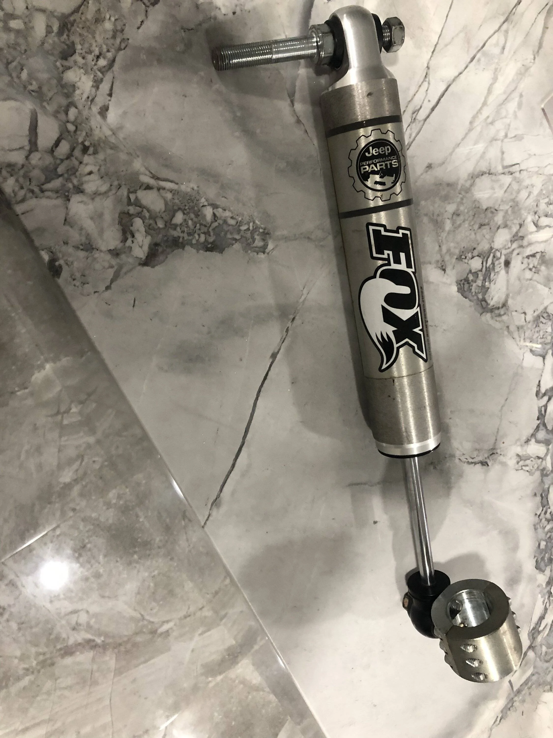

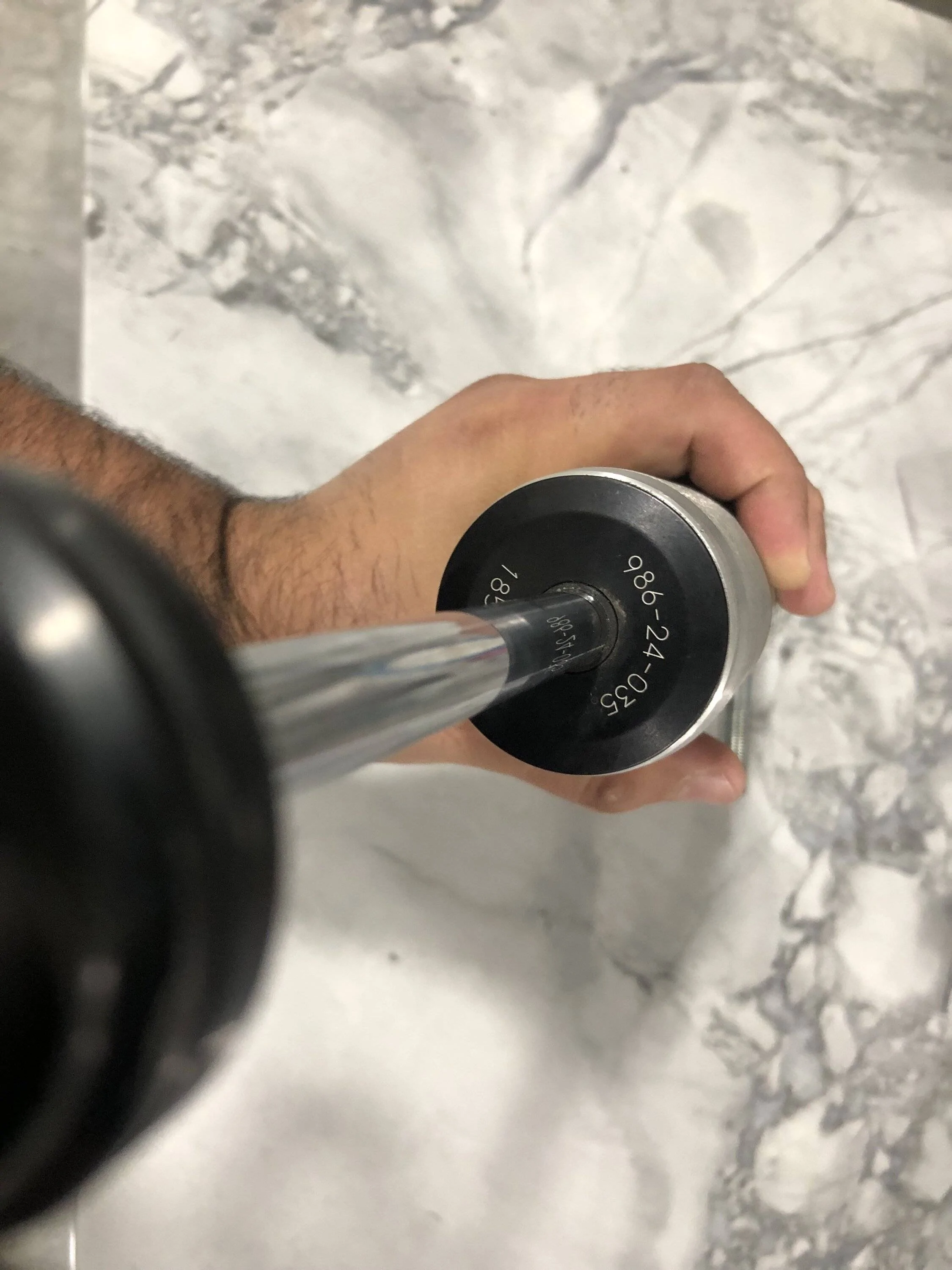

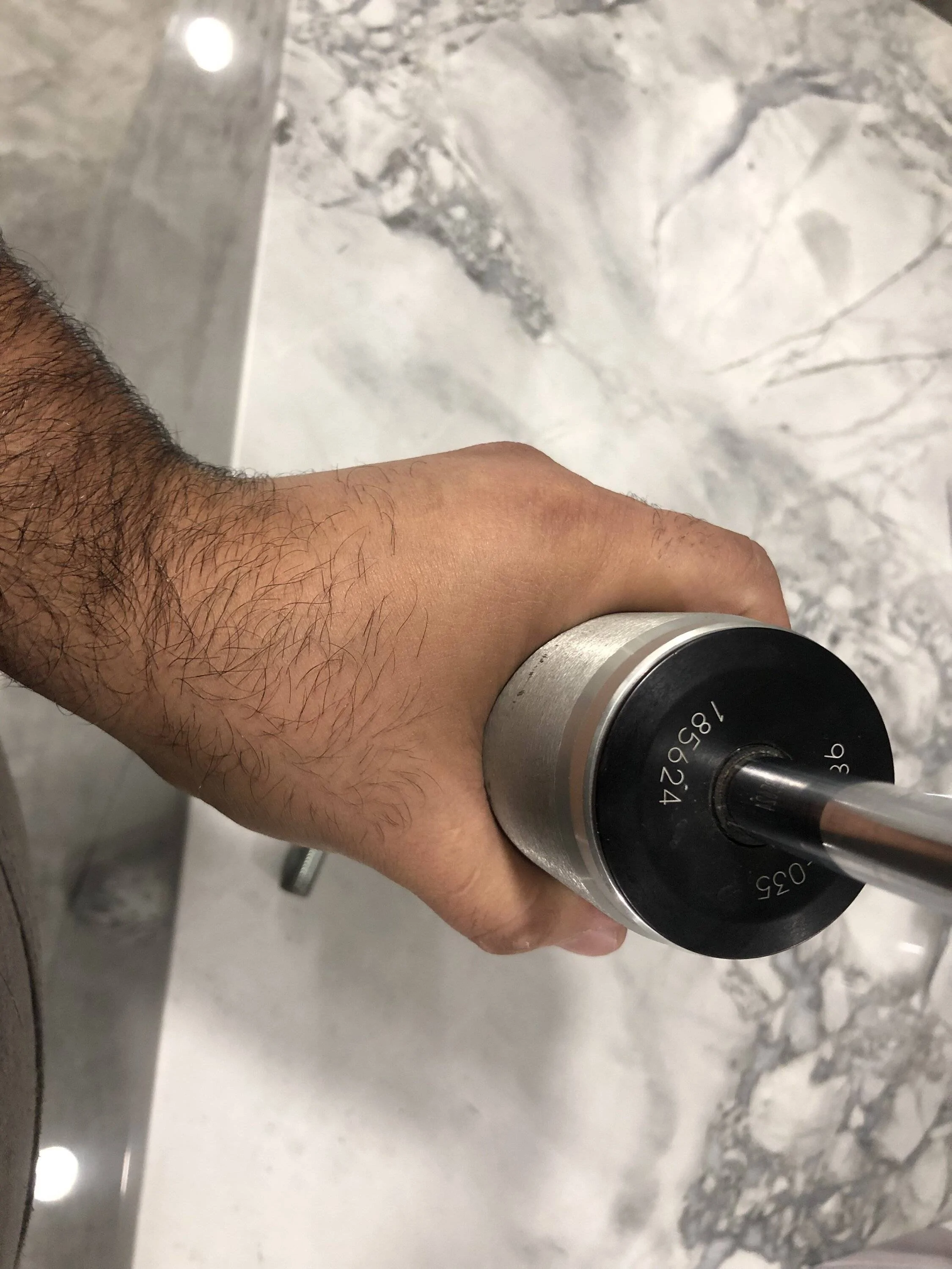

Hi everyone I’m trying to get some information on this fox steering stabilizer 2.0 that I picked up today used , and dumb me saw the box that said 18+ wrangler JL on it… after I got home I looked at the number on the ss and compared to the box and it’s different. The SS number is 986-24-035… does anyone know if this will work on the JL or I’m out of luck

Are you sure that’s the correct number? I can’t even find a reference for that part# on Fox’s site.

Here are some pics of the SS

Looks like it should work if the tie rod clamp is the right size.

It’s just very strange I can’t find any info on this particular stabilizer , the clamp does fit the synergy tie rod I bought from him as well, thank you for reassuring me
