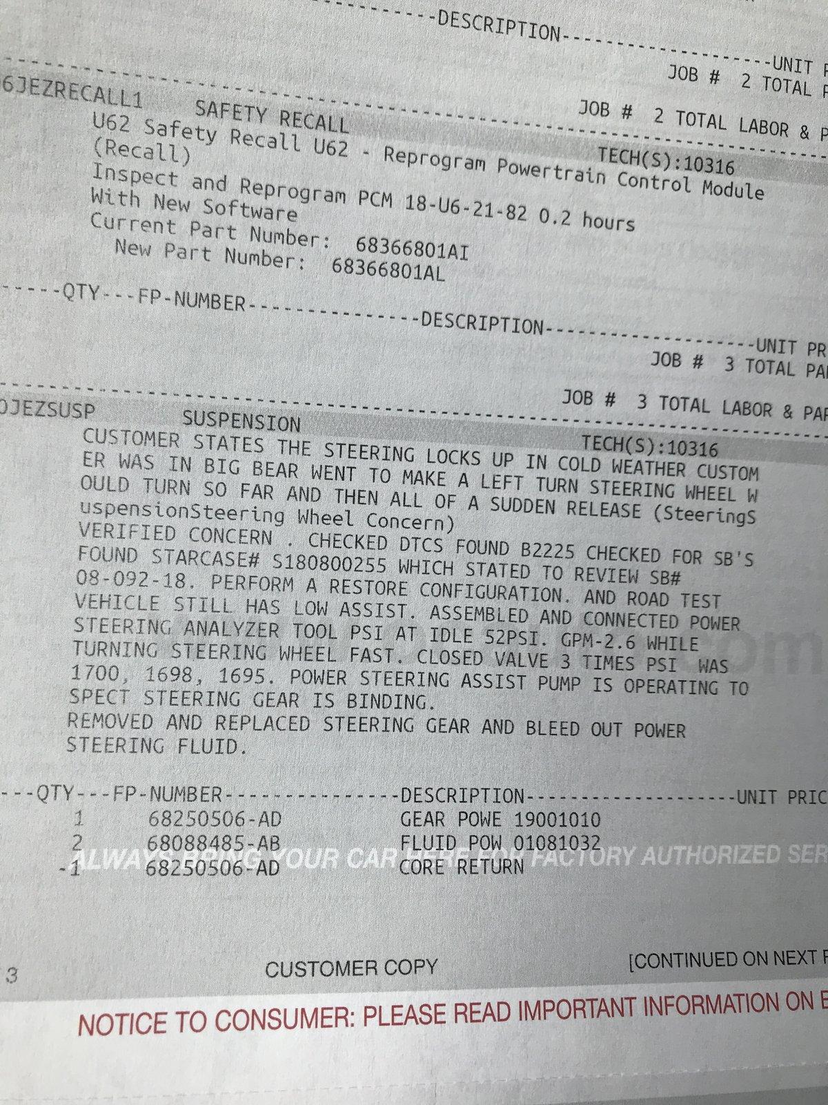

I will ask about that tomorrow. Last thing they said was that Chrysler engineers had no fix at this time and just wait for a fix to come out.
Heres the new part number bottom of page
I guess not new part number, but my steering is 100% better. Minus the shotty draglink and untorqued tie rod ends/draglink ends, and finger tight ball joints.
Jeep Wrangler JL Steering locked up at 70mph. 06A007E8-95AF-4A42-A76C-76D4744713CD

Man your dealership rocks. They actually took the time to see it through and not tell you to drive an unsafe vehicle until they think of a next move. I will discuss this tomorrow with service dept

Its interesting that yours actually threw a DTC. Mine has always been clear of any codes

Yeah i didnt know it did either, never showed anything

So it went back in the shop yesterday. FCA had them check wiring for the power steering pump which was fine so that is getting replaced this week. I strongly believe it is the gear box and the dealership agrees, but since FCA is involved they have to work on what they think it is.
I was assigned an executive referral manager and I emailed her stating I have lost all confidence in the vehicle and am just over it all together, but I have not heard back.

Was there ever a final solution. Just had it happen for the second time. I have a stock 2019 Sport S with 1100 miles.
Cojeepers
Rob
Aug 11, 2018
Jlu sport s
Steering pump was bad causing it to loose pressure intermittently. Still pissed it took so long to get it fixed and all the hassle from wind noise issues and radio intermittently power cycling so I traded it off for a new Ram 1500.
