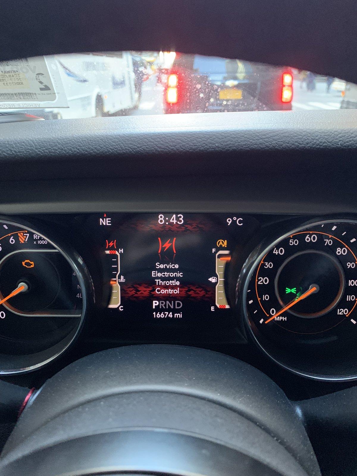

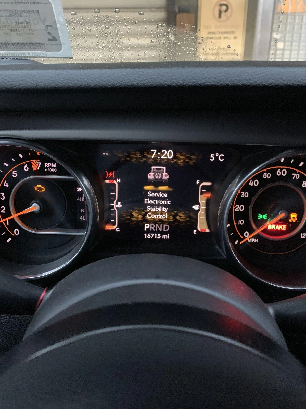

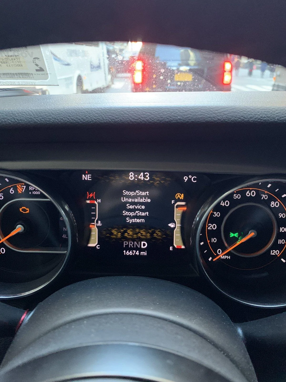

Hey guys,
So I got these three messages over the last couple of days. Started with the Start/ Stop not working then progressed to shaking and lurching when starting the vehicle. Can you guys confirm ordering the vacuum pump resolved this?
Jeep Wrangler JL START/STOP & ELECTRONIC STABILITY CONTROL SERVICE MESSAGE EC745643-CA44-4AAF-9195-BFEF15A88737
Jeep Wrangler JL START/STOP & ELECTRONIC STABILITY CONTROL SERVICE MESSAGE 4F1F322C-800A-4014-BB4B-1674F6CB0CBC
Jeep Wrangler JL START/STOP & ELECTRONIC STABILITY CONTROL SERVICE MESSAGE F676DF7B-E447-4BE8-B2FB-B0212A2BEF34

Hey guys,
So far it has for me. Although I never got the first light that you're showing, which probably explains the shaking and lurching.

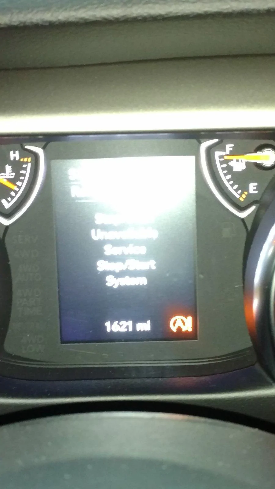

Mine goes to the dealer on Monday for this too. I was just there Friday getting my rear shocks replaced because they started leaking. Thanks for all the info. I'll let the dealer know.
Update: mine was a loose wire that only acted up at long stops. At short intervals, it was fine, but at longer lights, it would trip the code. Hopefully, no more issues with the ESS :like:
