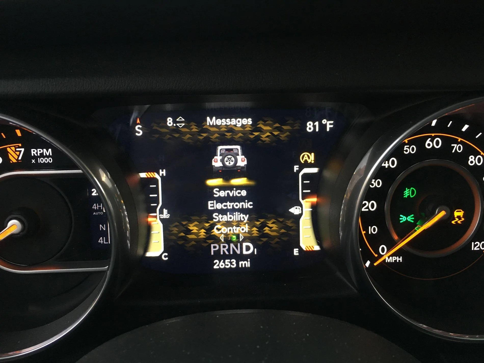

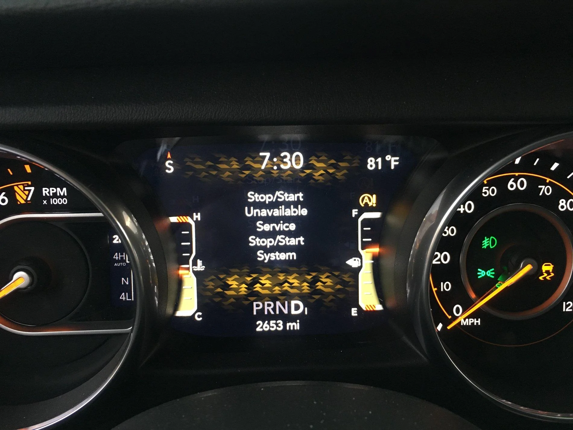

We just got this message "Start/Stop Unavailable Service Stop/Start". Also when in reverse, the backup camera only showed a blue screen, no picture. I only have about 1300 miles on it. First time Jeep owner, and first time I have ever had an issue this soon with a new vehicle.
My wife was driving at the time, stopped at a stop sign. The car turned off, showed this message, and would not turn back on. After sitting there for a few seconds, she was able to push the start button on/off several times, and it finally turned on. Kind of scary for her at the time.

That is terrible, I know how you feel. Hopefully they can fix it quick for you. I was told mine was fixed and the service lights would go away after a 'drive cycle' of 60-100 miles. Well, 189 miles later and the service lights are still on. I still have my Jeep Wave case open and the specialist there said they are assigning "Tech Specialists" to work with the service department when I bring it back.
You should call the Jeep Wave folks so they can help in dealing with he Service Department. Good luck!!

Finally picked up my JL and it's finally fixed and picked up on 06/08. It was a vacuum pump - same fix as baggio16. I first brought it in on 05/08 and finally it's fixed. I cannot stress enough to NOT bring your Jeep to Bay Ridge Service Dept in Brooklyn. The Jeep Wave folks helped me out a bit and were able to contact the service dept. on my behalf to try get answers but Bay Ridge is SOOO bad. I can provide details if anyone is interested but the good news is that I finally got my ride back :)

We rented a 2018 Rubicon with 400 miles on it in Ouray last week and twice I got the Stop/Start Unavailable and Service Electronic Stability control messages..went away with a restart.

It's one of the vacuum pumps. I had the same problem, took it to the dealer and now it's fixed.
Did the faulty vacuum pump cause your "service electronic stability control" warning light to come on or the "service the stop/start system" warning light to come on?

Got my Jeep back today. The dealer said there was no leaks but there was frost in the throttle control. First time hearing this as a possible issue so we'll see if it acts up again.

I just got mine back for the same issue. It wasn’t a pump, but the vacuum harness. Had a small leak in a line. The part was backordered, so there it sat for almost 3 weeks. I’ve had it back for about a week now and no more codes.
Sorry, didn't see this until now. But it both lights came on. The alert on the radio said "Electronic Stability Control System Malfunction".
They first fixed a hose or something, then it happened again. The second time they replaced the pump and haven't had that problem since. Actually, I did have it one time coming down from the high mountains in Colorado in June. If you want, I can see if I can locate the work order.
