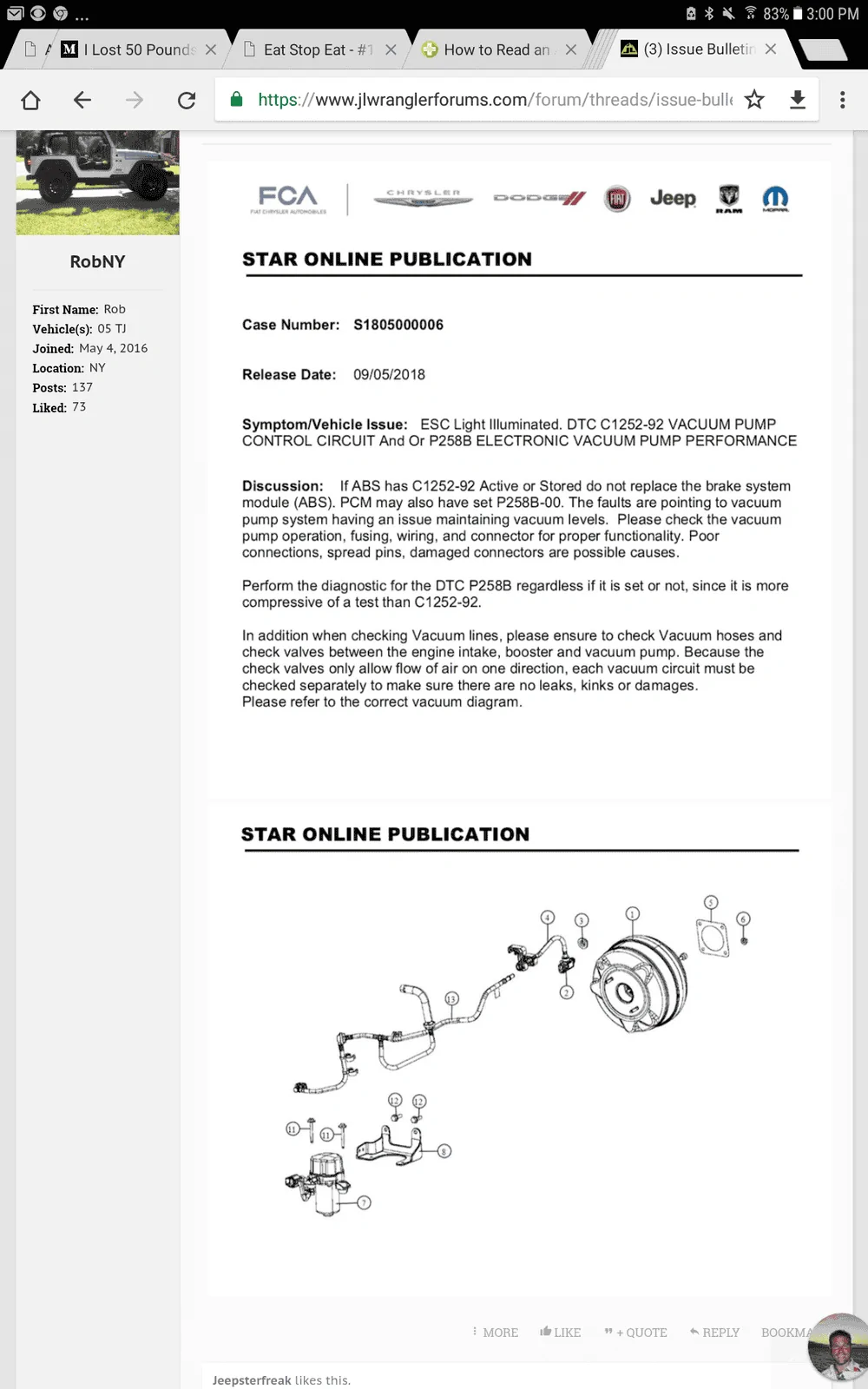

I know your post was intended for Trauma PA but I would appreciate it if you can post the work order on here so I can help my service adviser out with specifics. Thanks.
My Jeep is now at my dealer for the 3rd time in an attempt to finally resolve this issue once and for all. Here is what I provided my service adviser with:
Jeep Wrangler JL START/STOP & ELECTRONIC STABILITY CONTROL SERVICE MESSAGE Screenshot_20181209-150012

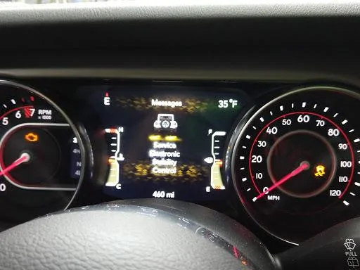

I have gotten this light twice now. Service electronic stability control system. I’m so tired of my Jeep being in the shop so much!!! I can’t take it to the dealer as we leave for Colorado on Christmas Day. What terrible timing for us. This will be the third time I have had to take it in for warranty work.
It's really embarrassing that we are having these issues, or any issues with brand new vehicles. Chalking it up to "it's a Jeep thing" is not a real solution.
Furthermore I've dealt with Jeep Cares and they offered zero help or support. They offered to pay $45 a day for a rental well guess what, a rental in my area this time of the year is close to $200 a day.

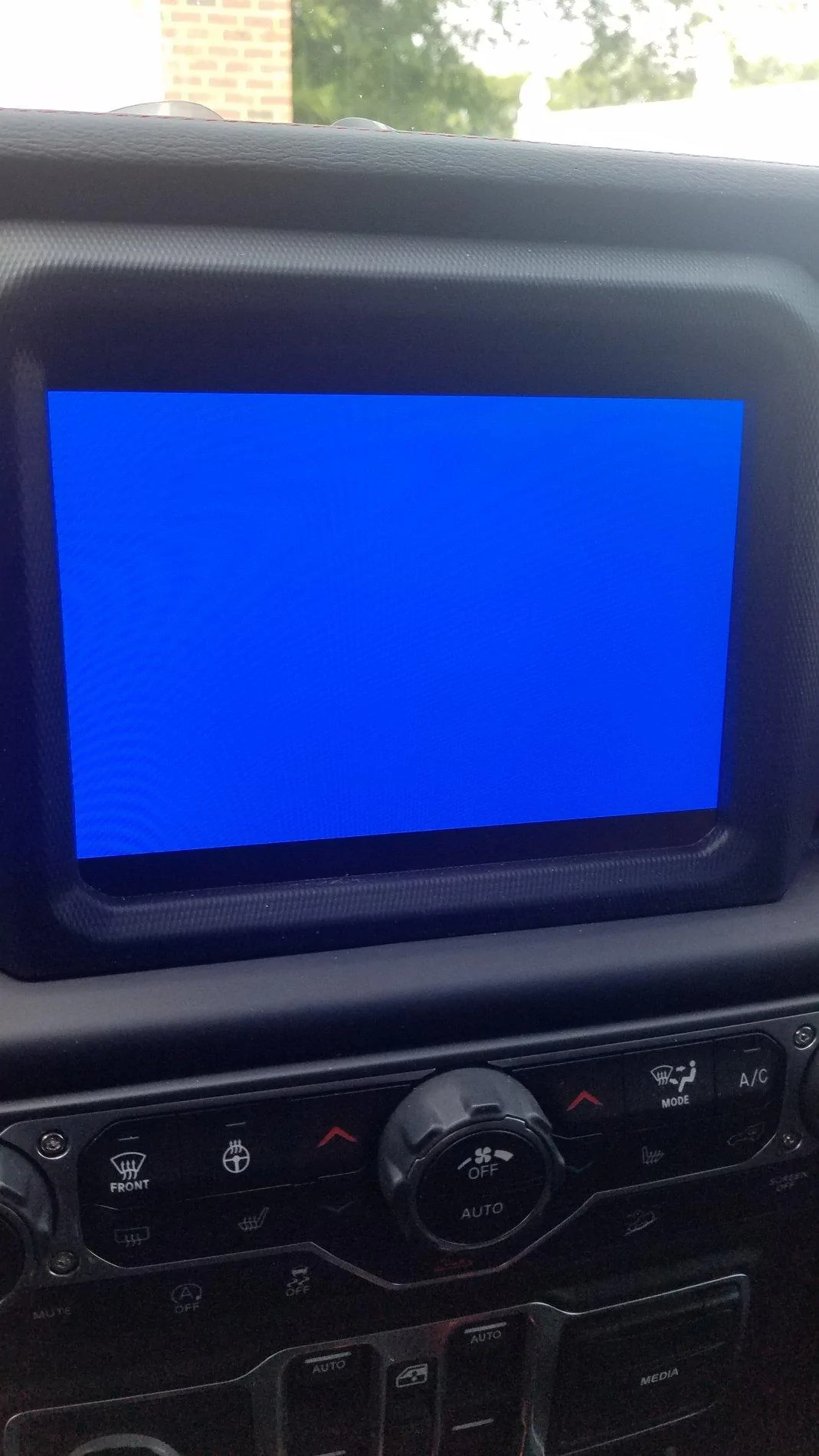

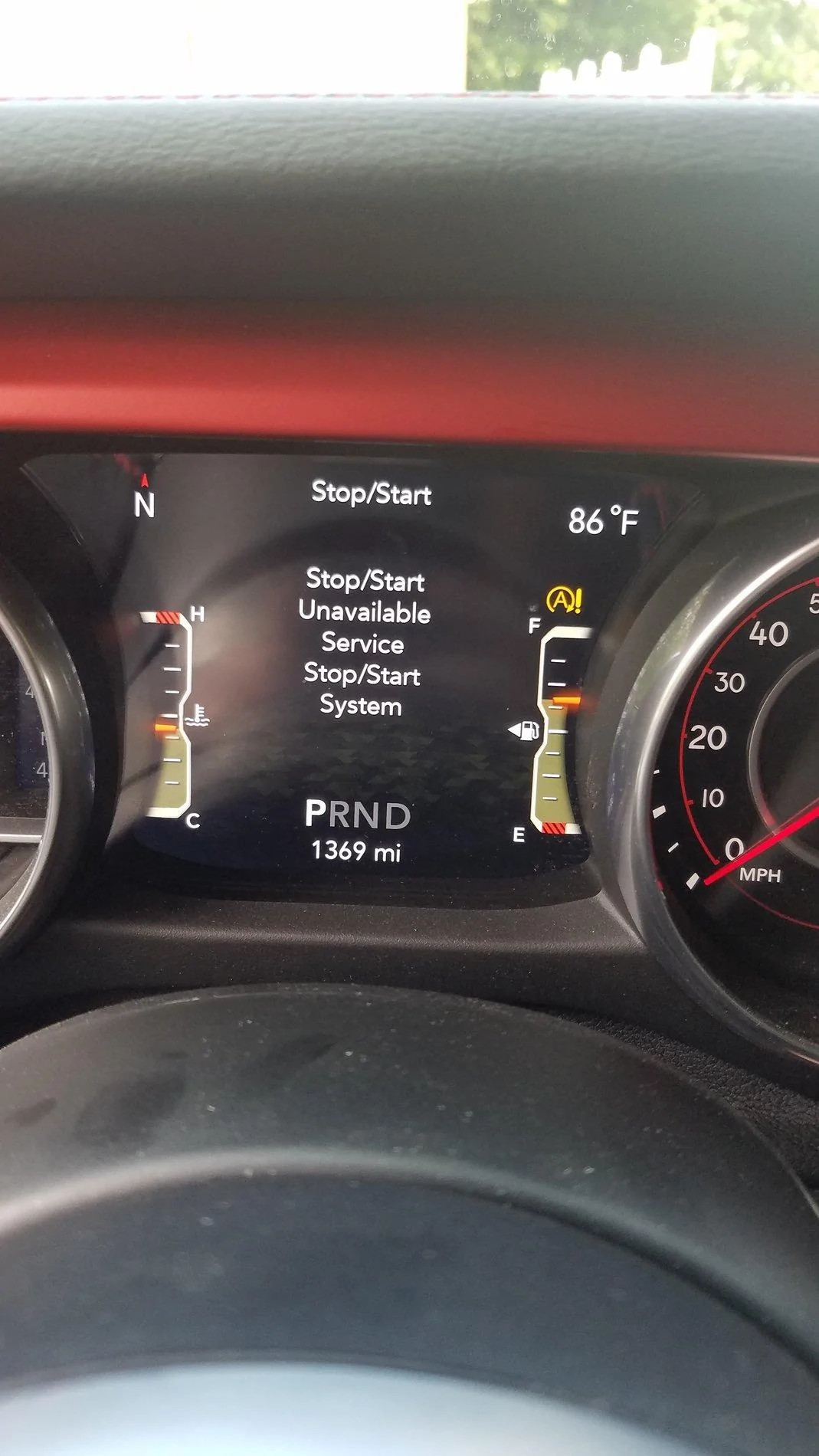

We just got this message "Start/Stop Unavailable Service Stop/Start". Also when in reverse, the backup camera only showed a blue screen, no picture. I only have about 1300 miles on it. First time Jeep owner, and first time I have ever had an issue this soon with a new vehicle.
My wife was driving at the time, stopped at a stop sign. The car turned off, showed this message, and would not turn back on. After sitting there for a few seconds, she was able to push the start button on/off several times, and it finally turned on. Kind of scary for her at the time.
I called our local dealership for appointment to fix this, and service department is booked out 2 weeks!

Just got my Jeep back (third time attempting to fix this issue), this time they replaced the vacuum pump instead of just the fuse. Hopefully this fixes it! Thanks @JeepCares for stepping in and helping out.
For anyone with a similar issue, get JeepCares involved. They open up a STAR Case which gets a FCA tech to assist them with the issue.
Thank you for sharing this. Dropped mine off yesterday and shared this and they didn’t have to waste time guessing.

I hope it worked out for you. If I hadn't provided this to my service advisor I'm sure it would have been another wasted trip. But since I did, he gave it to the mechanic assigned to my Jeep and they figured out it was the vacuum pump and they had the part overnighted and by the end of the next day it was fixed and I haven't had an issue since.
