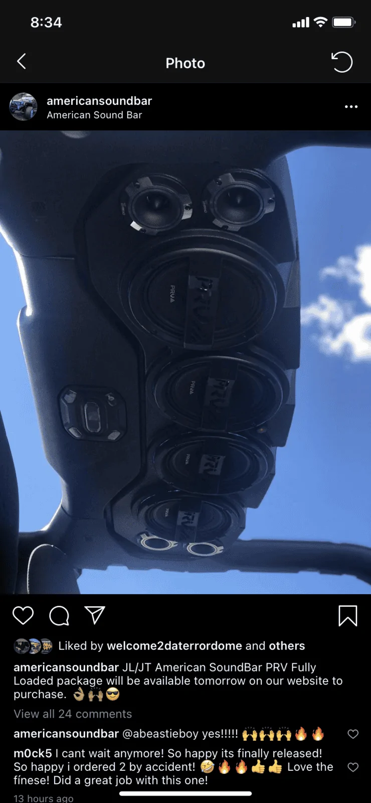

ive been waiting on this upgrade for about 5 months now. Since i first saw the jk model in person! Heres the american soundbar jl model! They kicked it up a notch from the jk adding another tweeter!

Love the concept, but the sound engineer in me is wondering where the hell all that volume of air is coming from to allow those 8"s to properly perform?? Don't get me wrong, I love overkill but does it actually sound good in performance? Are those things really midbass drivers?

Its so loud you wouldnt notice the difference. Sounds like a live concert and at 15 out of 30 its hard to sit in The back seat and thats in the jk. This has 2 more bullet tweeters so im assuming its going to be somewhat louder. But ds18 and american soundbar make them. What you put in them are shallow mounts that dont need a huge box and massive amounts of air to perform.

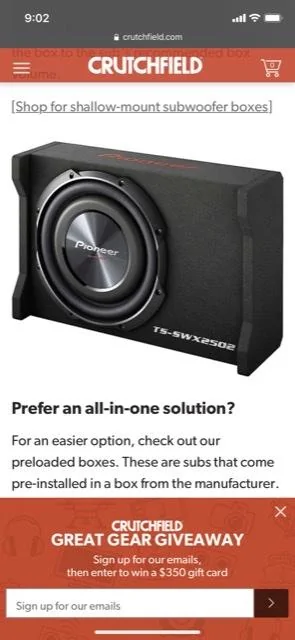

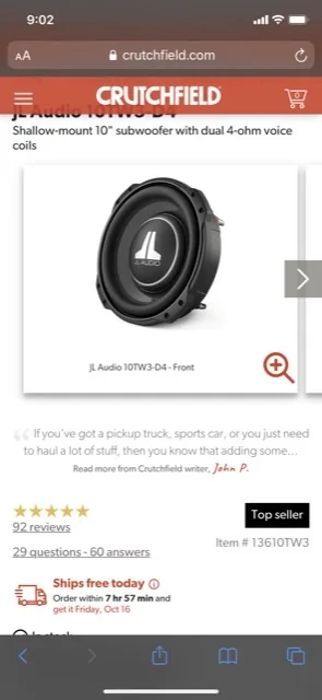

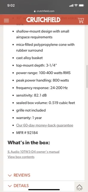

So idk if this helps. But i know jl audio hits pretty hard with any of the speakers ive tried. Pioneer aswell. So this shallow sub only needs about .5-.6 cubic ft of air in a shallow box. Its just the wave of the future.
Jeep Wrangler JL Speaker replacement upgrade E145AB77-7B86-49C2-8EB3-AC0B4EC3B311
Jeep Wrangler JL Speaker replacement upgrade DA32E60D-CFD8-48FD-A78B-AFE09967F06C
Jeep Wrangler JL Speaker replacement upgrade 002AF35D-B129-423F-A020-8248DB5B2090

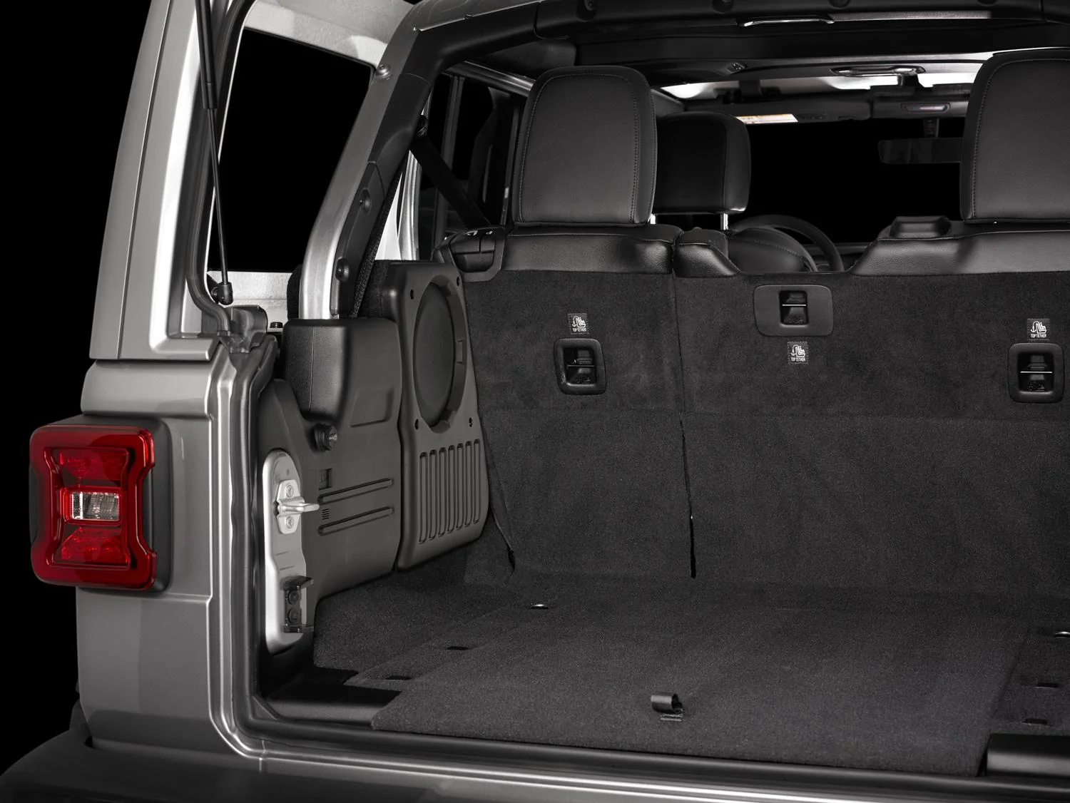

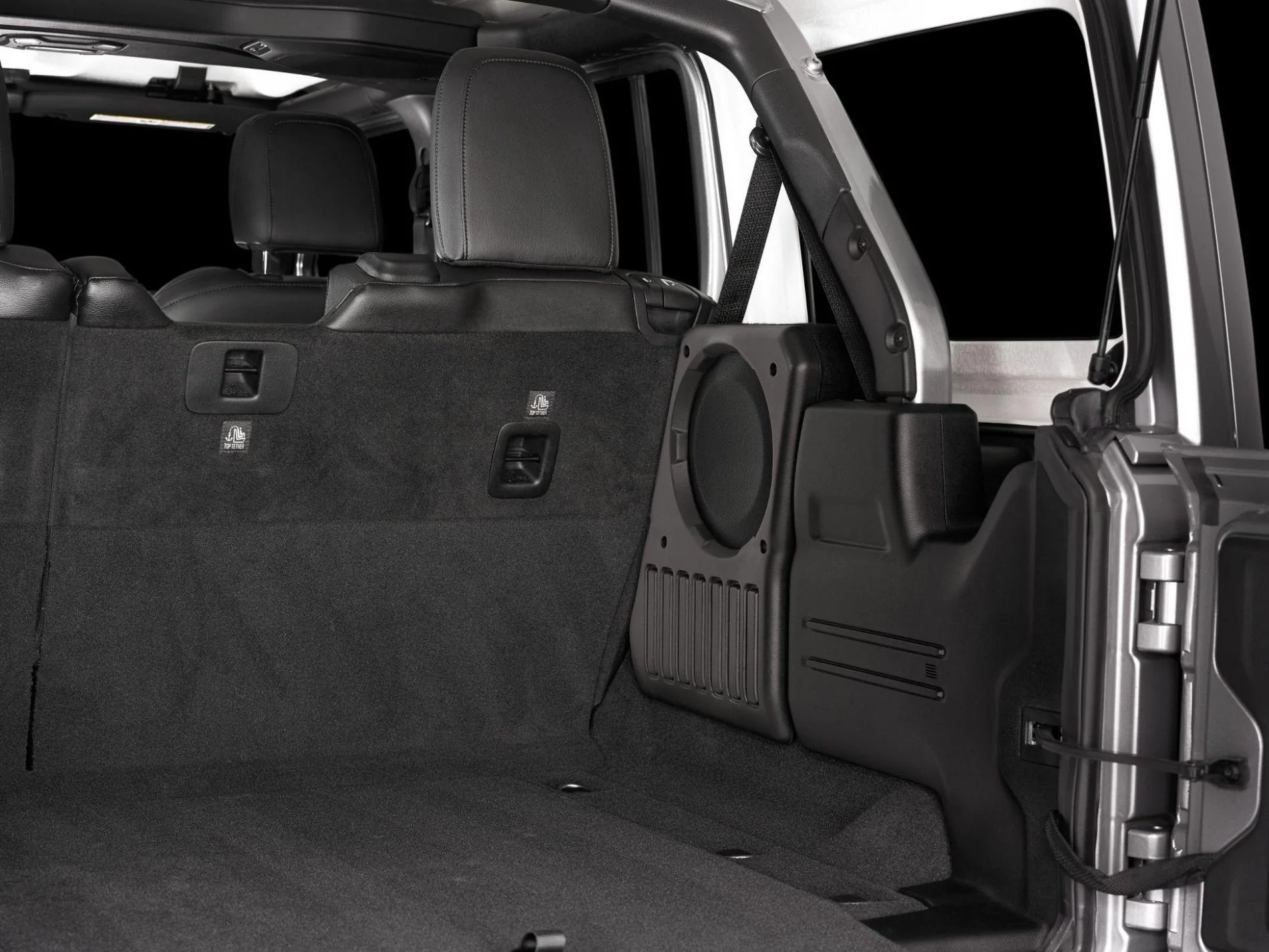

Oh snap! Is anyone running the JL?! Love JL products!

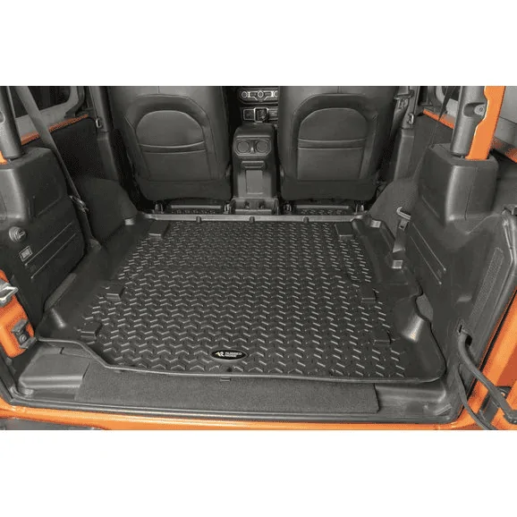

They will not fit the 2 door. Which is why this isnt an option. Its jlu only. If it fit id have 2 plus my speaker!

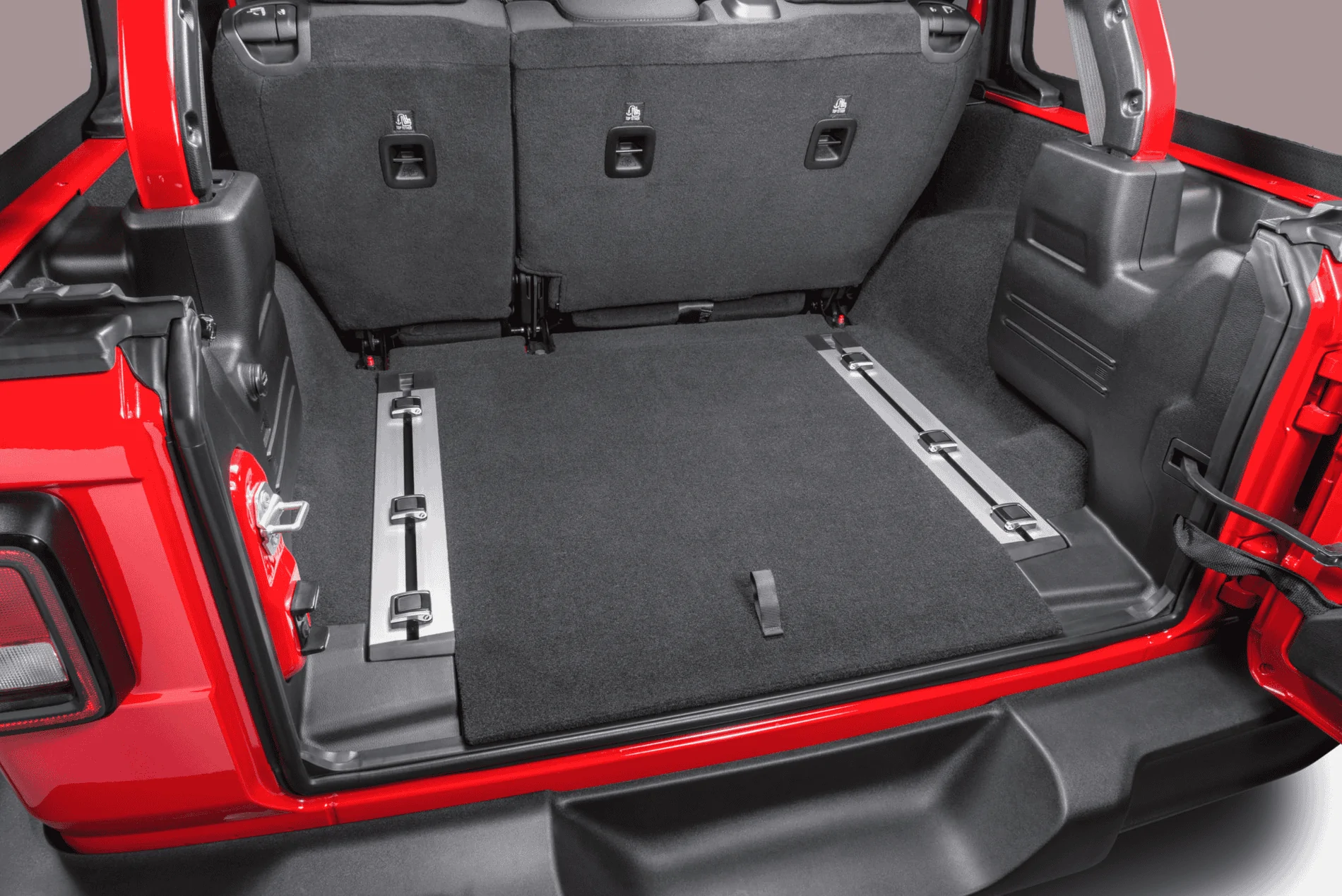

I know it isn't listed to fit the 2-door, but I want to know why. Is it because it's incompatible with the the rear seat, or is there some sort of actual mounting point that's different in the 2-door? Obviously the upper roll-bar is different, but it looks like the wheel well & rear interior paneling are identical.
2-door without rear seat:
Jeep Wrangler JL Speaker replacement upgrade 1602776631681
4-door
Jeep Wrangler JL Speaker replacement upgrade 1602776850395
4-door
The rear seat would be the issue. As this speaker location requires you to drill a small whole in the rear wheel well then mount it directly between the wheel well and the rear seat. Good thing about a 4 door is you can have 2. But i did not see this working for me at all. My 2 door is often carrying 4-5 ppl. Thats why its for 4 doors. With the seat in place it would be ontop of the speaker. Look up lightbritestudios youtube on the stepchild! They have a full jl audio install video.
