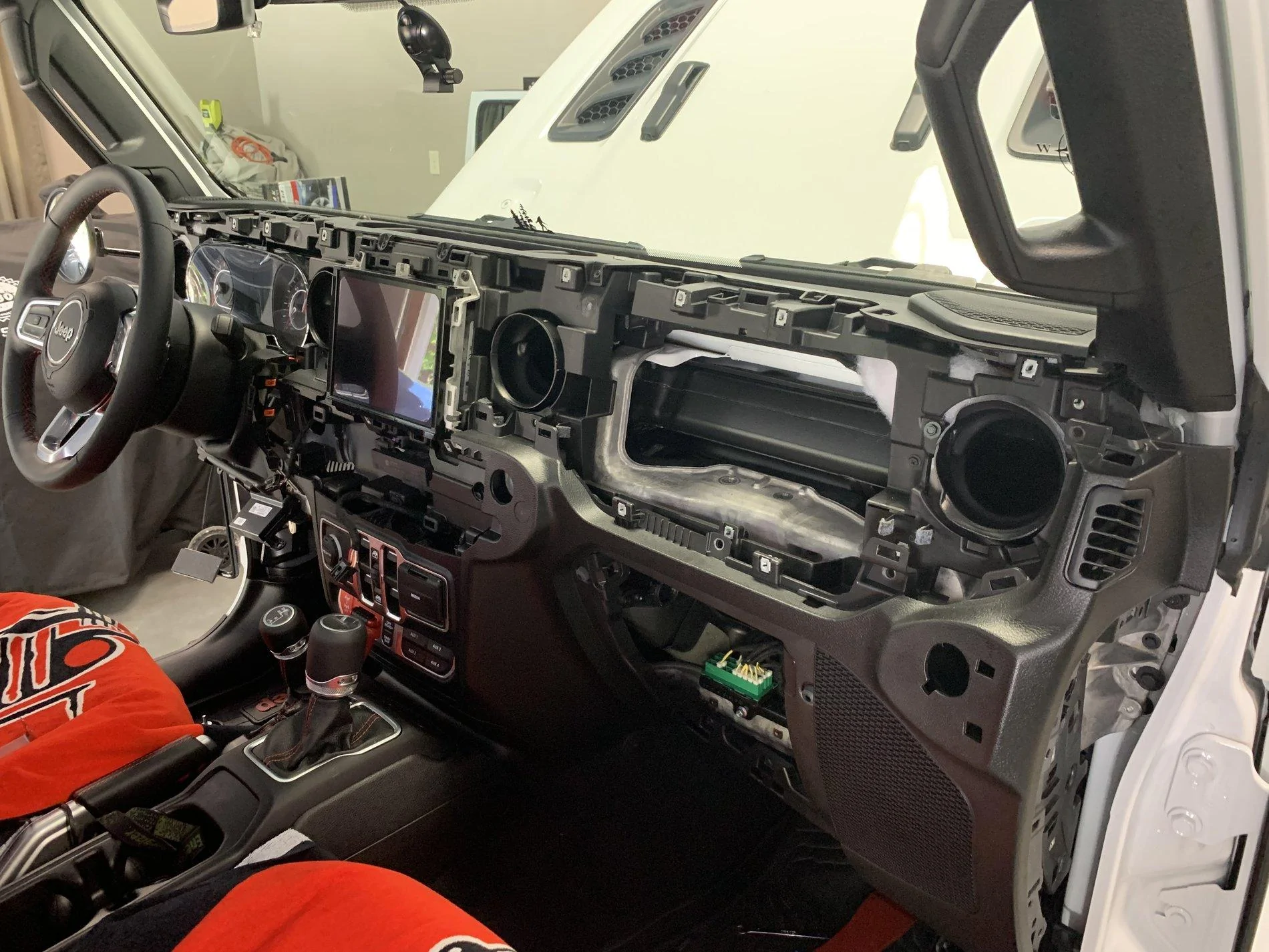

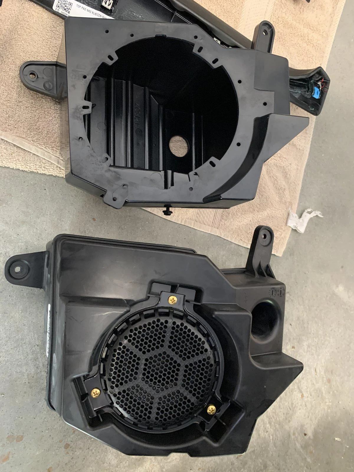

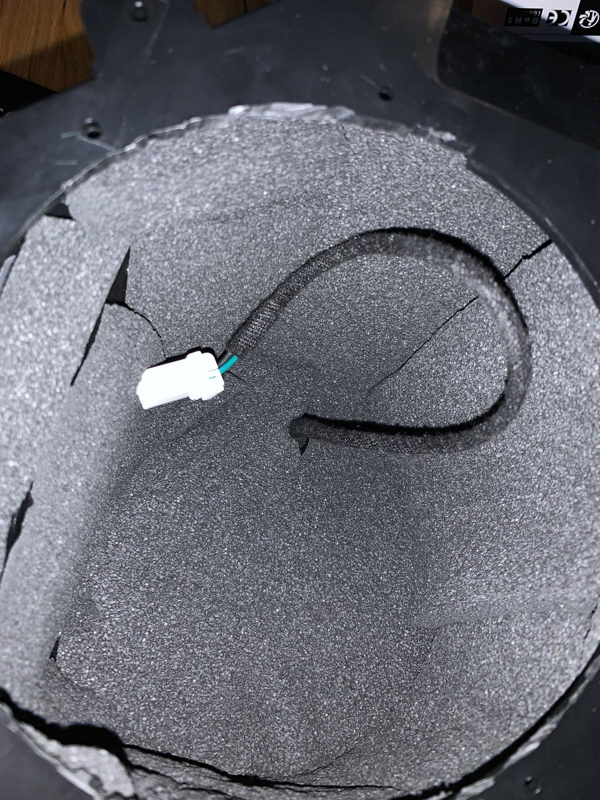

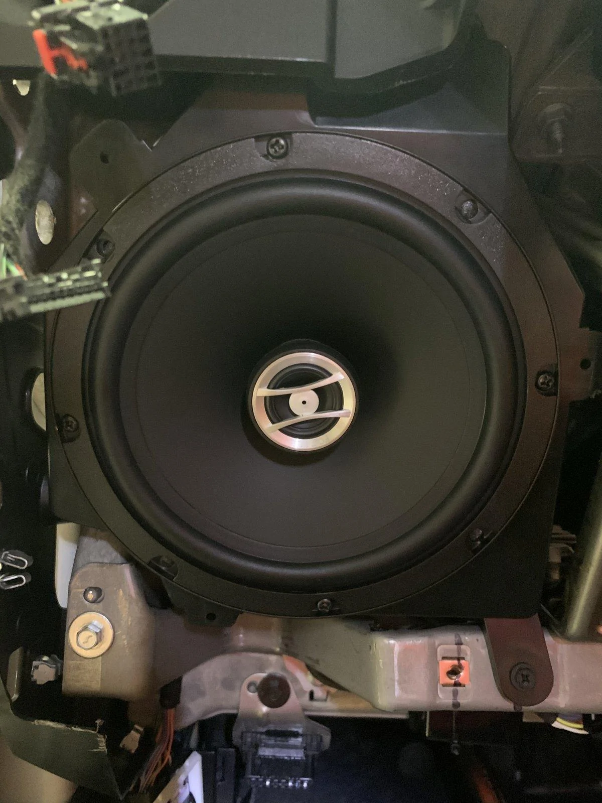

I just couldn’t be happier with the night and day difference. Finally added the Metra JP-1014 6.5ā€ pods and Focal RCX-165 6.5ā€ speakers in the dash knees. I agree it was a bunch of work disassembling the dash, but so worth it. I also added Hushmat & polyfill inside the Pods. It sounds so much better. Think I will hold off on the PAC preamp and Amp upgrades for now. Might swap the 8ā€ sub for a 10ā€ next and see where it goes.
Thanks again for the motivation Kidcia. And the 7mm wrench suggestion was a big help on a couple of those tight spot screws you mentioned.
Hey so coincidence, I already had those Focals laying around from a previous build. I had also ordered the metra pods. Went online tonight, and crutchfield was running a sale on those dash speakers for like $65, so I picked those up as well. I'll get it all installed this weekend or next week, I appreciate the recommendation. I'm going to really seal up those pods in hopes that I can pull a little tighter midbase from the system. In the future I want to do the heigh10 head unit swap and do a full build out, but if I can upgrade the current system for free (I had enough crutchfield rewars money to cover the 3.5s), why not do it? Did you notice more volume with these?
