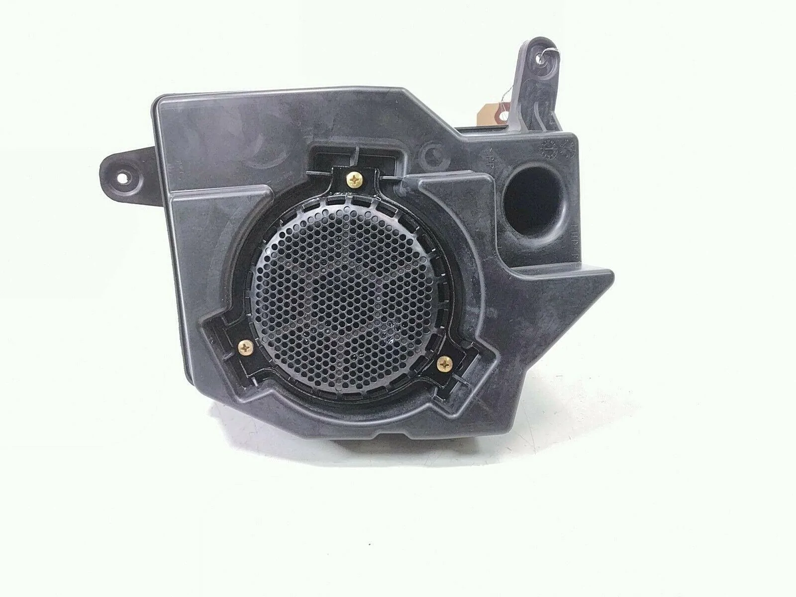

Did anyone figure this out? Someone asked on an earlier post if it would be possible to fit a 5.25 in the existing pods with minimum modification? Limiting the choices to only 4" in the knee panels is kinda ridiculous if a dremel and some quick clips would allow you to fit something bigger and open up our options. I came from the era where we had to use a hacksaw blade on the dash to fit a single din radio in the dash so this should be very doable IMHO.
Can someone confirm this is what the pods look like on a JLU?
I ordered a 68283474AB (Alpine, left hand drive, passenger side) and that's what it looks like. At first glance, the passenger one looks to be the harder one to modify. For around $50 I thought I was ordering just the pod, but the part includes the pod, the speaker grill and the speaker - which gives some idea how 'premium' the Alpine speakers are.
I sat pondering it at the weekend and I've come to the conclusion that I'll probably try the Morel Hybrids in there first rather than modifying it. Aside form being lazy, I originally thought I might be able to get a 5" in there by just trimming off some of the plastic, but I decided even that's too much work for me to do a good job with. The pipe for the port wraps around behind close to the speaker so that would have to be trimmed too. What it's hard to appreciate from photos is that the whole front of the pod is slightly curved and slopes away from the speaker, so just trimming the plastic would leave you with a surface that may be hard to get anything larger than a 4" to sit flush against. The right thing to do is probably to cut off the whole front of the pod and fabricate a custom flat surface. Like I said though, I'm too lazy.
