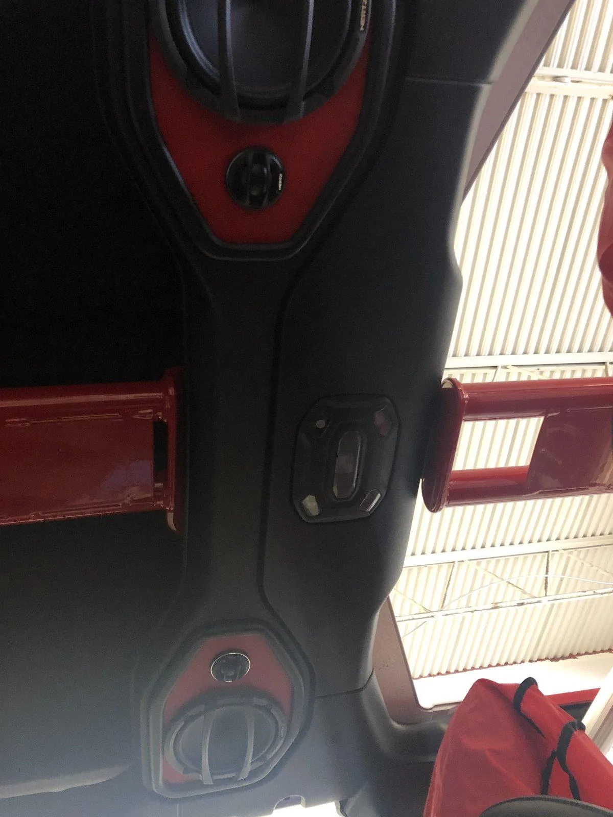

Anything can be done if you want to go for it. These are just a few shots from a build that should wrap up today. Was able to squeeze the Hertz mille legend 1650.3 in the factory holes with some fabrication.
You have a build thread on these Soundbar modifications? I'd rather put actual components instead of the crap that's there now
