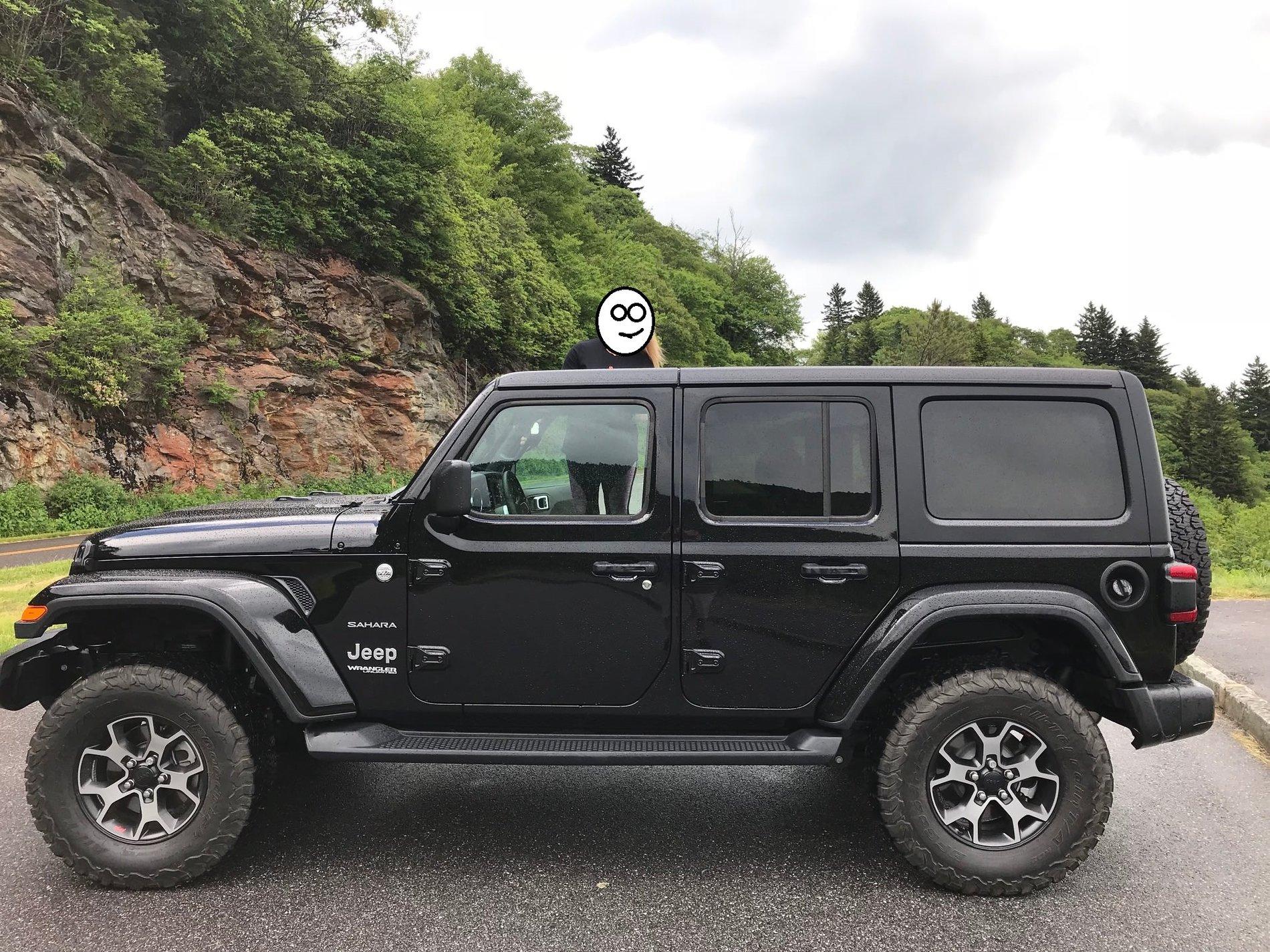

OK, I'll be a nice guy and share with you what I did (2.5" RC lift), why I did it and what I regret.
This is my wife's rig and we learned really quickly we should have got the Rubi because of how hard we are riding this Sahara. We will be hitting Moab in July and I actually put a call in to the dealer to see how upside down we would be on a trade in for a Rubi. All of that being said here's some info that may help you.
Step #1 - Bought Rubi rims and tires.
Step #2 - Put on the RC 2.5" lift by myself. It was a great learning experience and took me waaaay longer because I was a noob to lifts and wanted to understand and do it correctly. It wasn't hard at all, just time consuming. This lift will raise your rear 2" and your front 2.5" so it will take out the rake up front and it's really a 2" lift.
PROs - Cheap, gives the Jeep a great stance.
CONs - the sway bar links SUCK up front and one came loose (at least this was my experience). You have a lift but still don't have full shock travel because of the brackets. Track bar relocation brackets are not needed nor are new control arms.
Step #3 - Barricade Aluminum front bumper and Rough Country 9500 winch. The bumper is crazy light thereby putting less weight on the front suspension. Some people poo poo Rough Country but at $400 for a synthetic rope winch with pretty much a lifetime warranty we went for it. So far it has done three tough winch outs with no problems.
Step #4 - Sahara side steps suck off-roading and can't take a hit. Solution = ACE Engineering rock rails. They've gone up $150 since I bought them but they are SOLID and they are FRAME mounted. These things can take a full on hit and drive away. Great investment and they look freaking cool.
Step #5 - Dang we really should have bought a Rubi.
Step #6 - Now here we are 7 months and a lot of knowledge later and I bought full length Rancho RS5000X shocks (need to put on still). These will give a more stable ride and take advantage of full travel. I also put on JKS sway bar disconnects. HUGE plus because now I can disconnect and articulate better off road.
Rancho $200 JKS $140 from John @OffRoadWarehouse ; he will hook you up.
Step #7 - Dang should have bought a Rubi, have call in to dealer, waiting to see what they find.
Step #8 - 35" tires BUT not advisable if you're going to be more than a parking lot princess or mall crawler on these axles. Since we off road hard we risk snapping an axle with 35s on the Dana M200 and M186 axles.
Solution drop $4k on Rubi axle takes offs. Nah, will most likely build up the axles with chrome-moly shafts and possible new gearing and then we can go with 35s and a locker.
So you need to ask yourself how you want to run this thing. We went off-roading and were addicted. I mean addicted to the point that I went out and bought a '04 LJ and now we off road together. And to brag on the Mrs.... she understands everything I have typed above :)
You may want to consider a full on lift with new springs, shocks and links. It will be pricier though. When the 35s go on we will most likely do a full on regular lift but this is a few years down the road. For now we can do some serious off roading as we sit and just know our limits and what we can look forward to.
I hope this helps. Here is what your Sahara will look like using your original suspension and putting on a RC 2.5" lift. Here are also some fun pics :)

@mgroeger Great progression! Thank you for sharing all these little details. I love the stance of your Jeep, especially on the first photo. These are 33's, right? Bumper choice and side steps make a lot of sense.

You're welcome and I'm glad I could help. Hey, as long as that Jeep makes you smile you got the right vehicle for you. Notice how I didn't call it a car; don't call it a car, God kills a kitten every time you do... lol.
In terms of going higher... we started off "let's put a Rubi suspension to give it a little boost". Then my wife comes home from a mountain trip, doesn't even say hello to me, the first words out of her mouth were "I need a 2" lift!!! I look like a sissy next to those other Jeeps!" Yes you do give up some stability the higher you go, but we regret not going higher. I don't think many regret it the other way around :)
If you keep your mods simple based on your needs you will be one of the few people on the forum with money in the bank still LOL.
