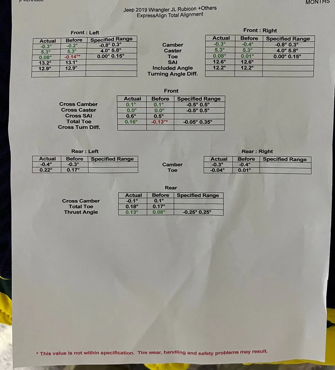

2019 jeep wrangler jlu. 2” mopar lift. 315/70/17 mastercraft mxt’s(new tires just got installed with alignment). Drove straight as an arrow steering wheel perfect center with old tires. I am attaching my alignment report …all looks great I think? Right from get go steering wheel clocked left 20 degrees and hard right pull. Very reputable place installed. They worked it and finally said it was a bad (new) tire. Any thoughts and help very appreciated.

The only thing that was changed in the alignment was front toe. If the steering wheel is off center, then they did not adjust the drag link. You can do that yourself - it is very easy. Drive the vehicle straight in a flat area and come to a stop. Loosen the sleeve on the drag link and turn it until the steering wheel is now in the center. Tighten sleeve pinch bolts.

for the record the alignment numbers look good. It should have one finger steering....
