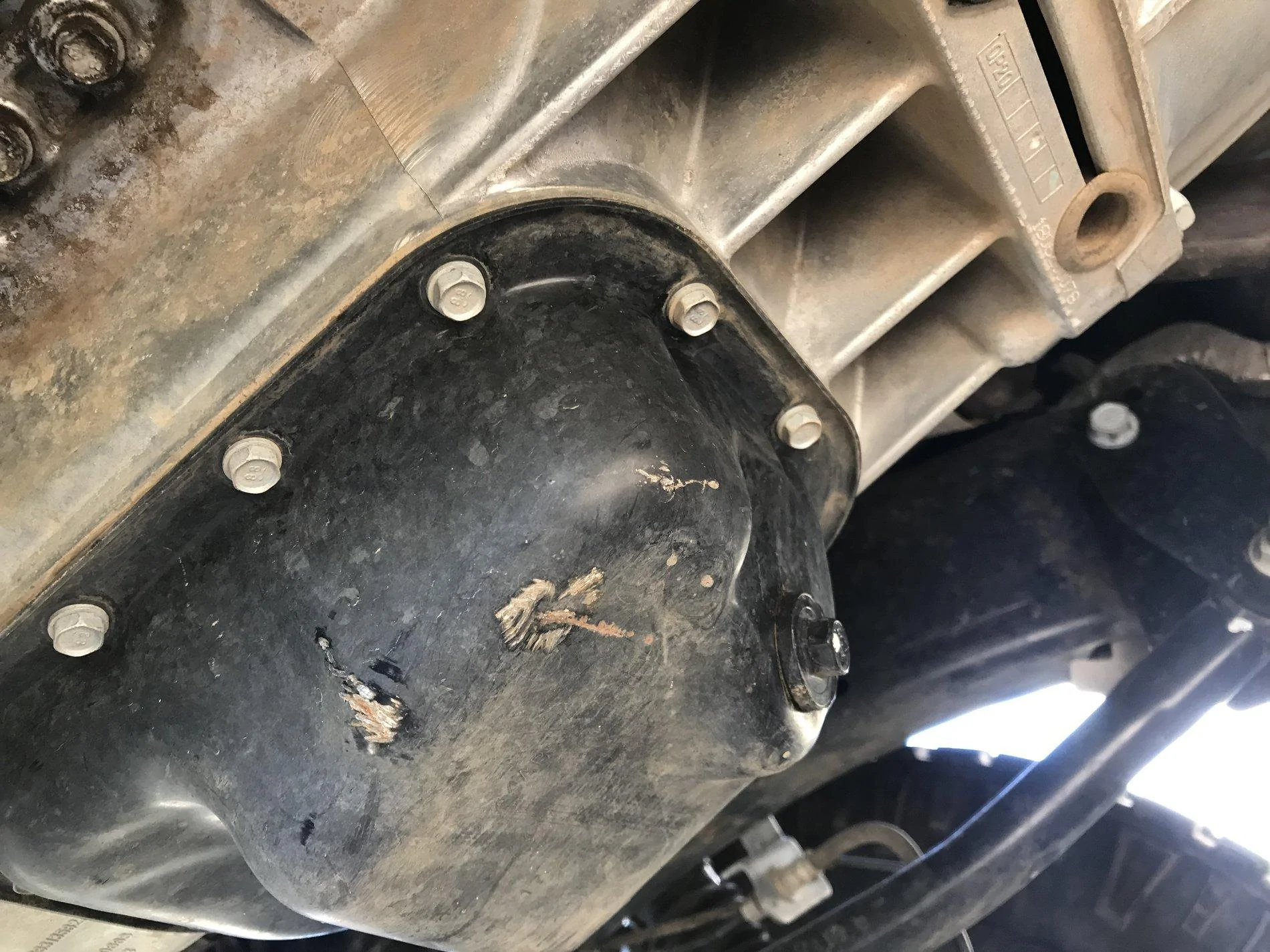

Whats the consensus on oil/trans skid, which one do i get?
After pushing the limits of the jeep on a difficult trail......
I doubt you will get a consensus. It's pretty much personal preference and mounting method. Out of whats listed in this thread: Rock hard is too spendy IMO. The MORE is priced well if you like steel and don't mind the mounting method. It's kinda difficult to get to the motor mount bolts. You have to droop the suspension ,use long extensions, and an impact is helpful. Tnt looks good and looks like it attaches to the motor mount brackets without having to remove any bolts. Way easier to install but costs more. Also has to be custom ordered from the looks of it. Evo and Quadratec have to be modified to fit.
Good Job, this is proof you are using it, I like it !!!
As to your question, I echo others, figure out your mission, and go with the appropriate battle armour.
Maybe a little too much proof, luckily i was at home when i saw this so no issue. But yes i was using it.
