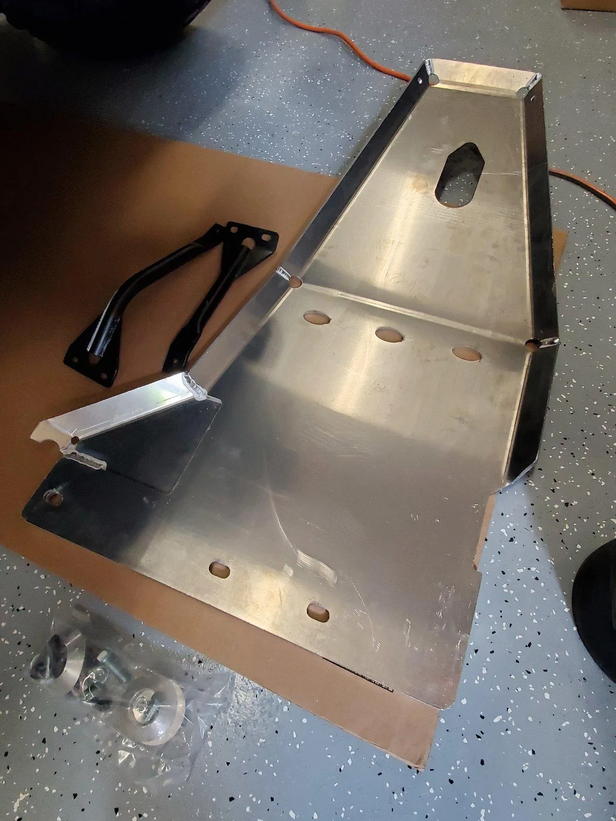

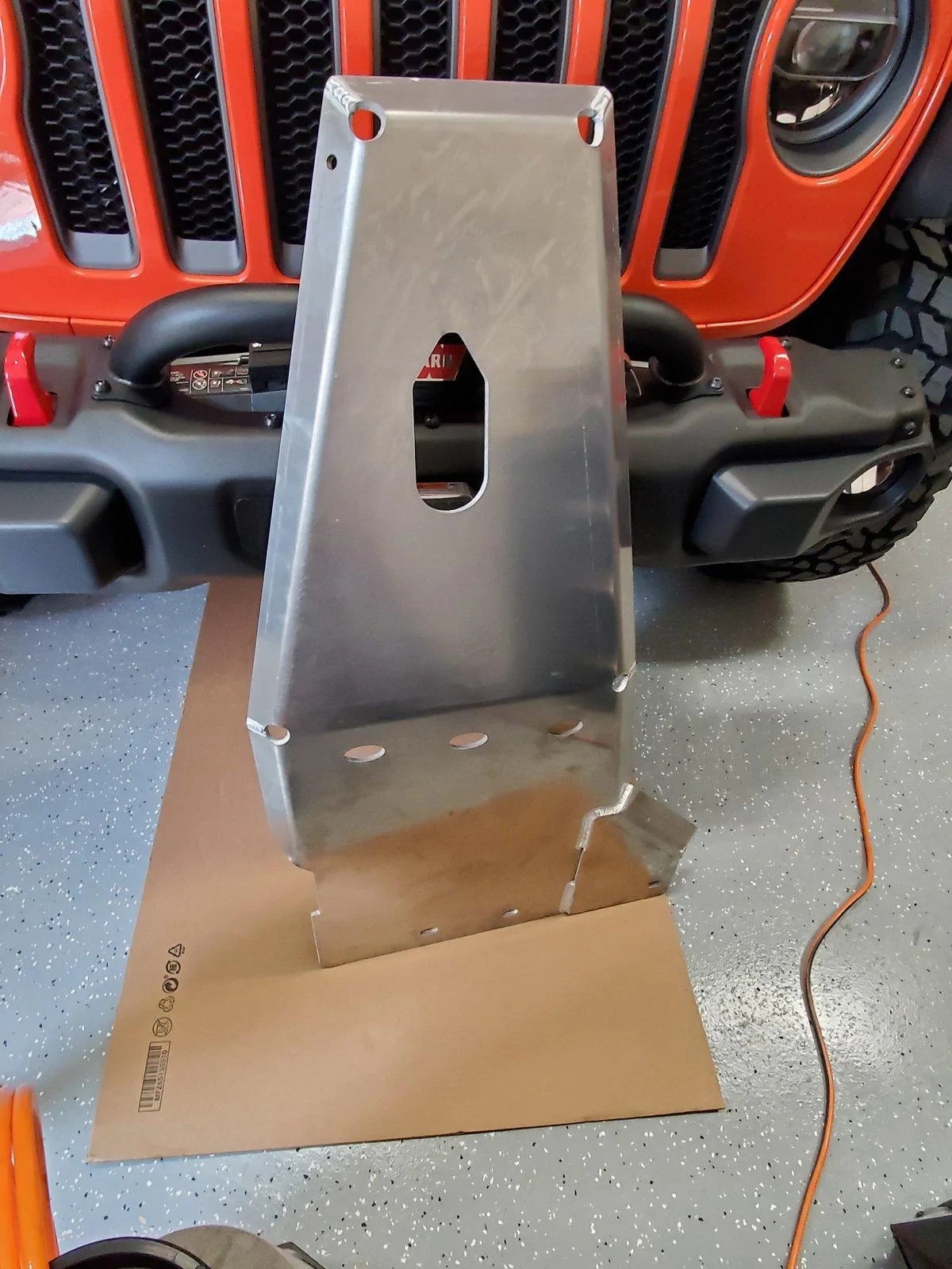

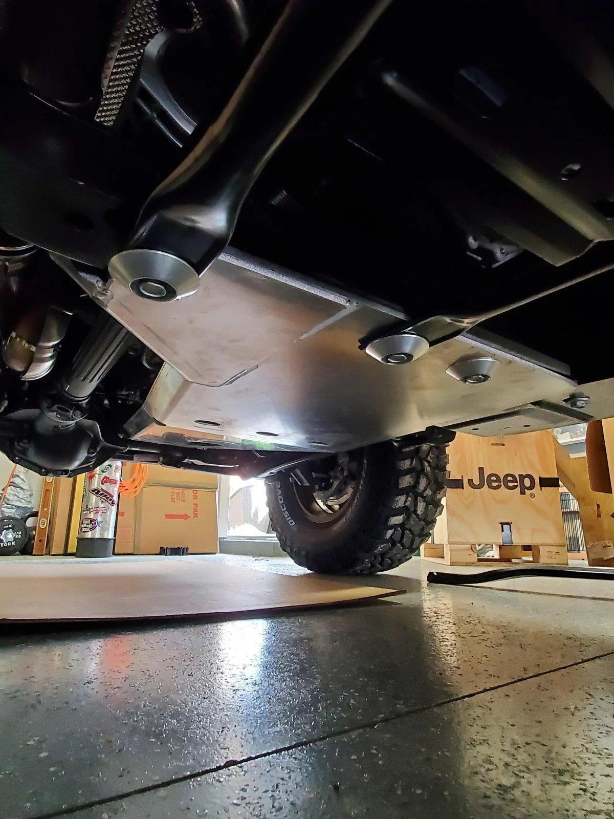

Here's the TnT Custom's aluminum engine skid for the 2 door. It bolted right up.
pokey02,
Would you mind grabbing 2 more pics of yours?
A horizontal shot from the side showing the belly clearance. Is it fully flush with the frame rails, does it dip in the front near the exhaust pipe?
And a shot where it meets the gas tank skid. Is the factory gas tank skid mounting modified in the front? Doesn't it attach to the the cross-member that is removed?
I can only find 4 door pics online except what you posted.
Have you got to test it out in the last 4 weeks? How do you like it?
How did I miss this? That's looking really good! Did you happen to get the weight?
Looking great! :like:
No, didn't get the weight. I will see if I can find the UPS shipping email. It is light, but not sure by how much.
I used it today at a jeep jamboree. It's doing its job!

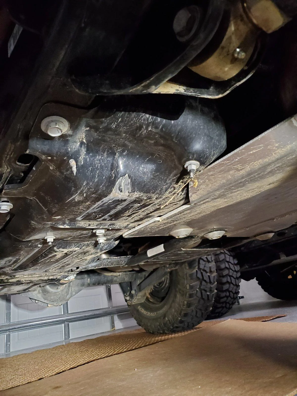

pokey02,

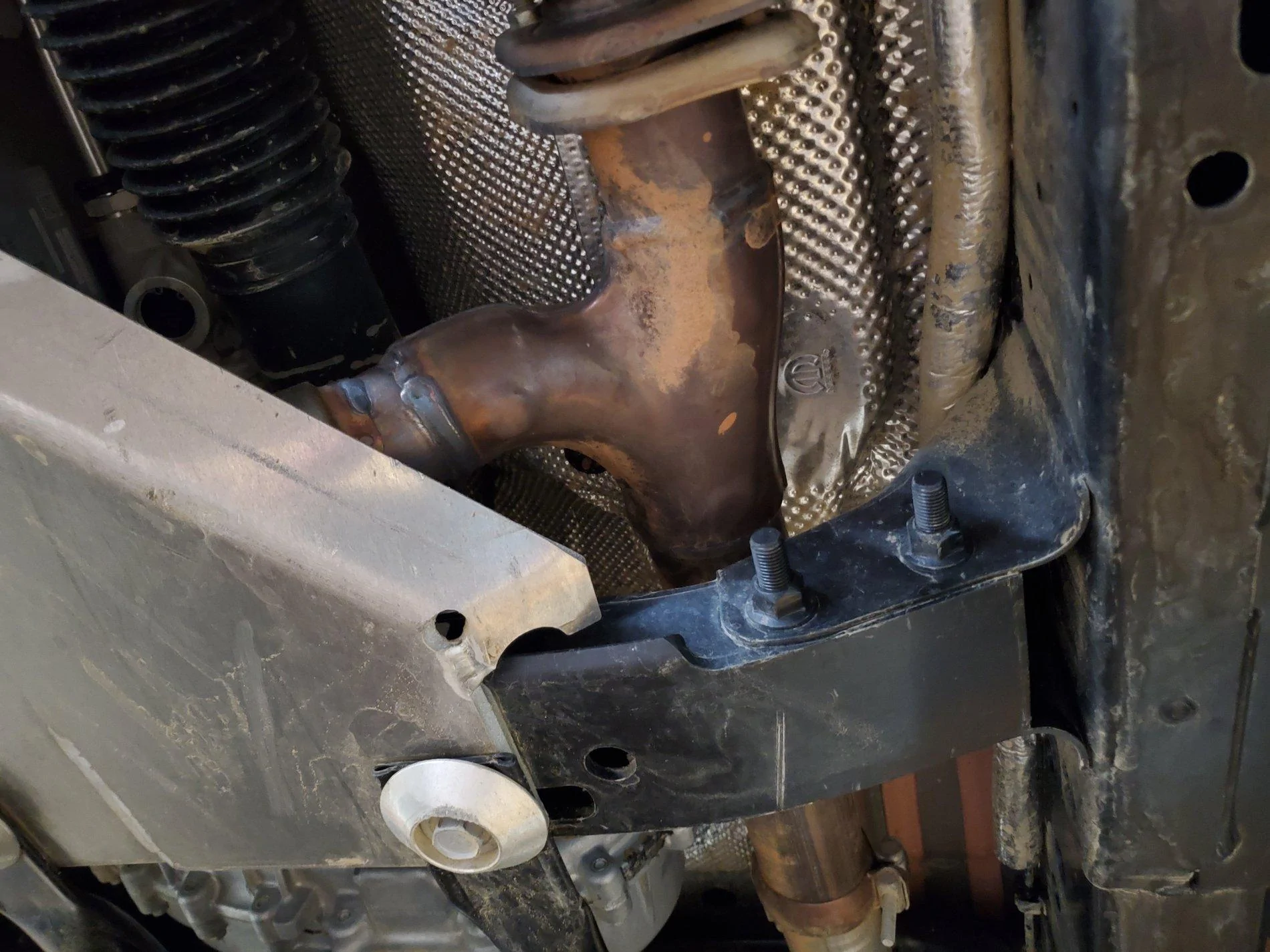

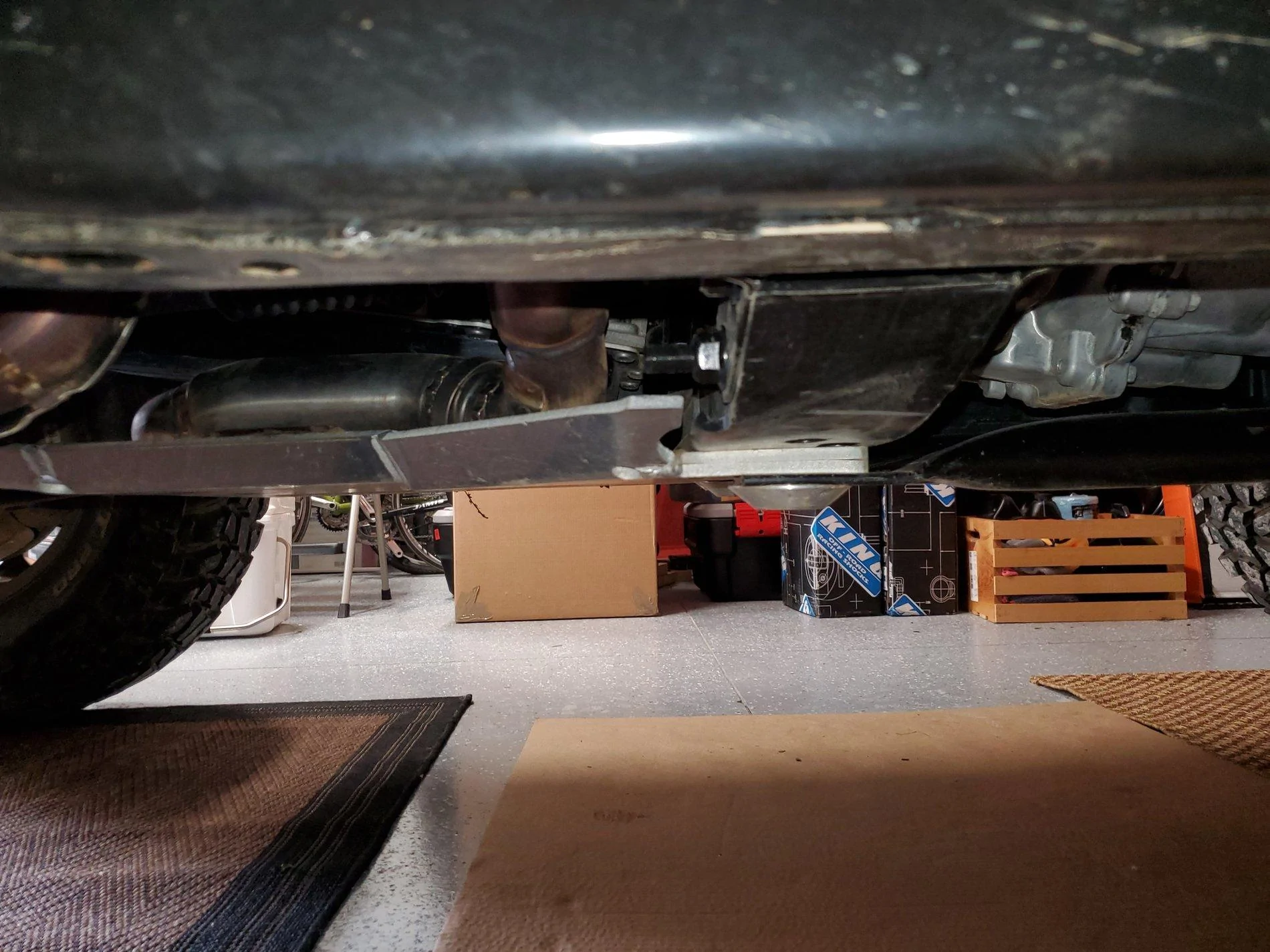

Here are a few more pics.
The skid stops at the gas tank. I am waiting for TnT to come out with a gas tank skid and xfer case skid. The JK version of their skid system, everything connects together.
The skid sits flush and does not cover the exhaust loop.

pokey02,
My order is delayed a little as TnT doesn't have any 2 door ones in stock and they are waiting for the material to make mine now.
Thanks,

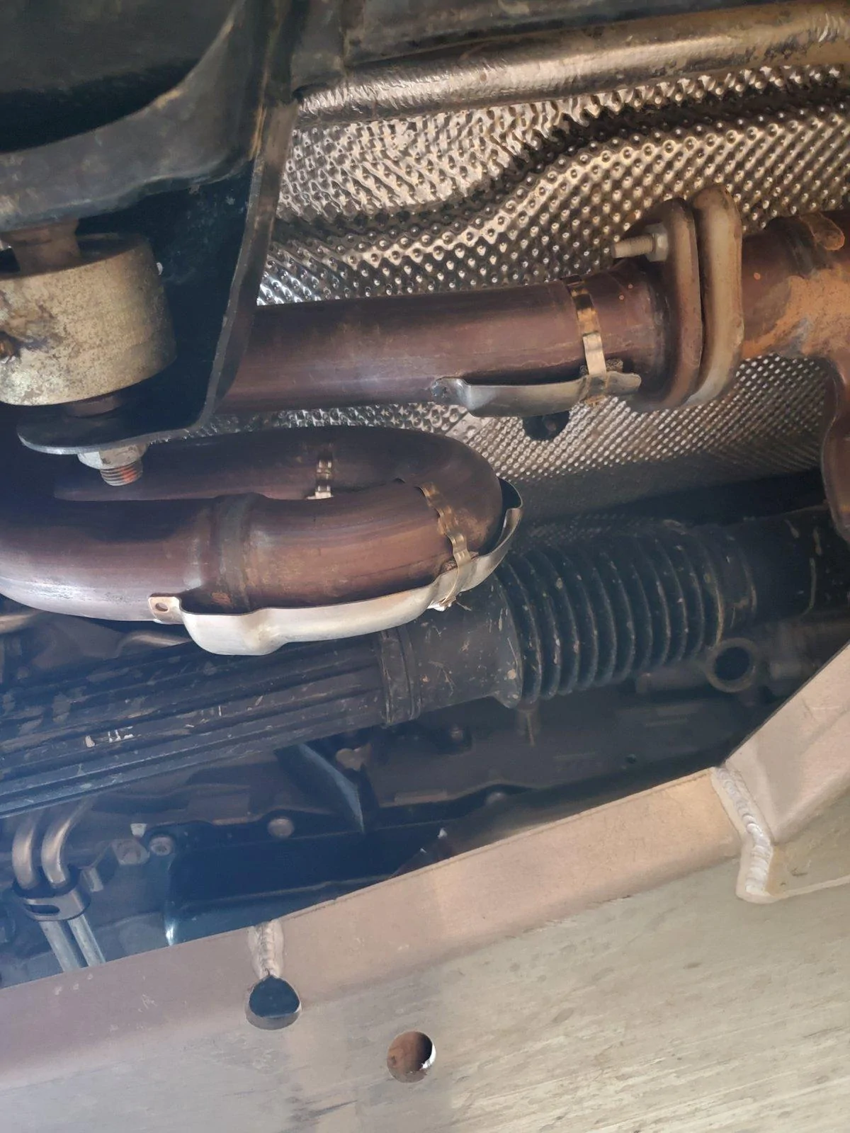

Here is the exhaust loop side
Fantastic. Looks great.
Glad it's working out for you.
I hope mine gets built and delivered quickly. I need time for a shakedown run before I head out west.
Thanks for the pictures. Now I can rest easy knowing I am getting what I hoped for.

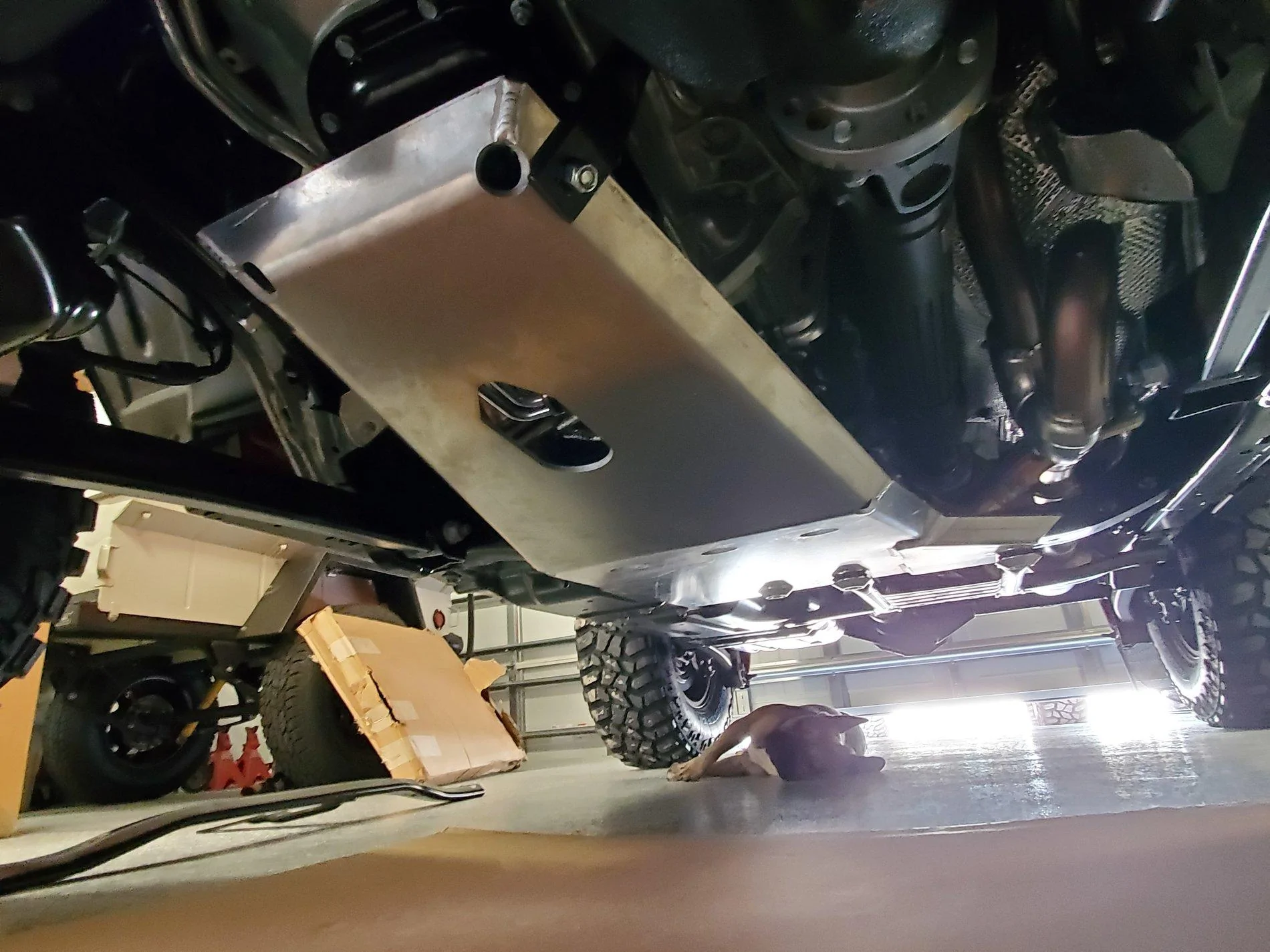

TnT Customs has come out with a transfer case skid. I ordered it last night. Unfortunately, I'm going to have to trim a bit on my engine skid to get it to work. But it looks solid and provides good coverage and it's 1/4 aluminum. That's the issue with purchasing early production stuff.
I will be excited to get it mounted up.
Not sure this new skid is on their website yet ... I've just been pestering them a bit so they emailed me when it was available.
Pic is not my jeep, just the image they sent me of what it looks like.
