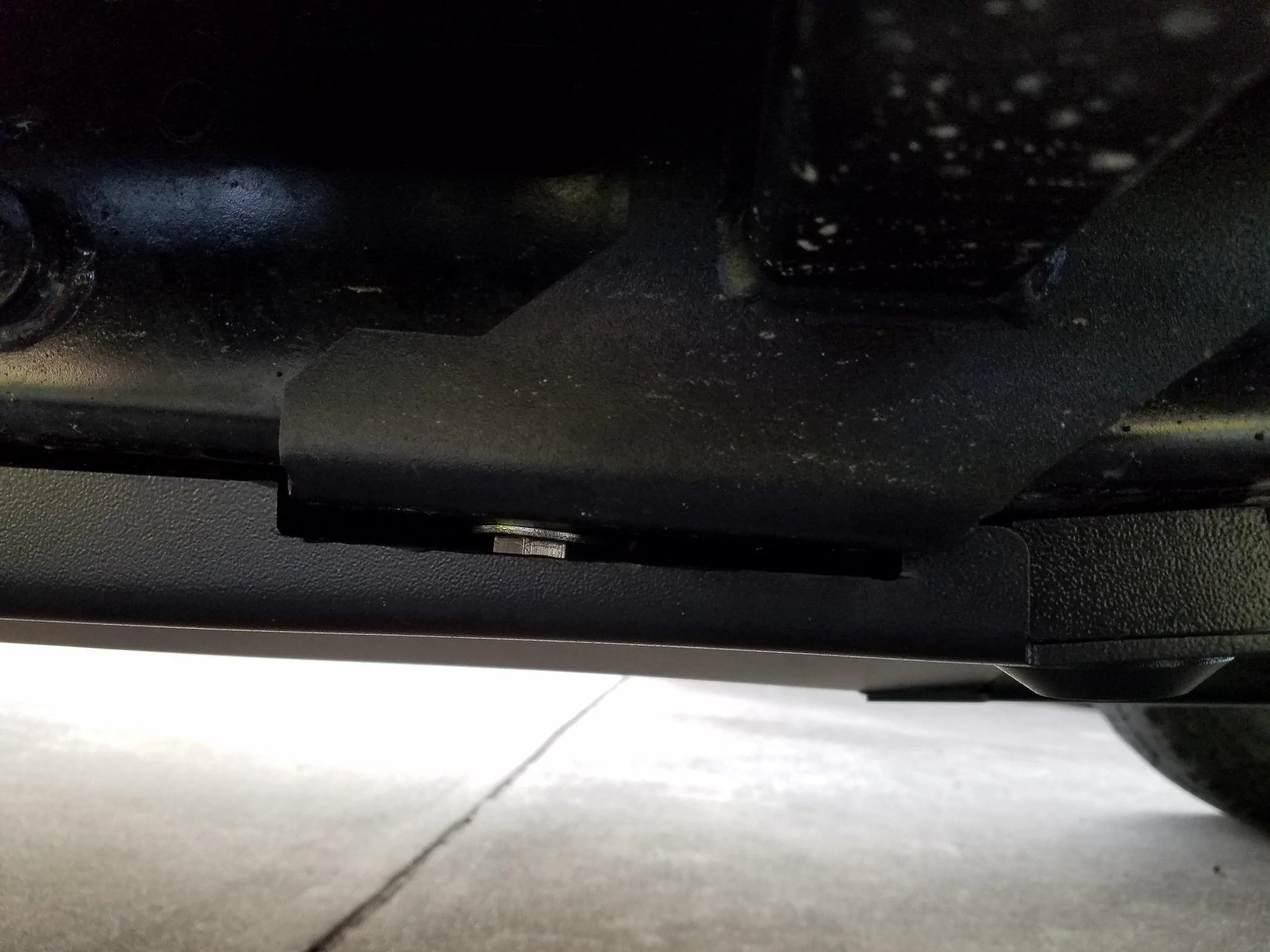

They absolutely interfere with each other. They neglected to include the brackets for the fuel tank skid but I have all the rest of it installed. I had to cut some notches in the belly skid to fit over the front mounts for the LoD sliders. My concern now is how the tank skid is going to go since it uses the same mounting location as the sliders. Stay tuned for that. The system is extremely rugged but a huge PITA to install. They could have designed more form fitting brackets for the oil pan skid, I had to call them because it wasn't lining up with where it connects to the belly skid, but I had to alter the belly skid first anyway, but it was still a struggle. There are a few fasteners that are all but impossible to get a nut on and one has to be a contortionist to get them on, and then trying to get a wrench on it. I'd like to kick whoever is responsible for those right in the ding-dong.

Jeep Wrangler JL Ordered skid plates 20180618_184951
Jeep Wrangler JL Ordered skid plates 20180618_185016
