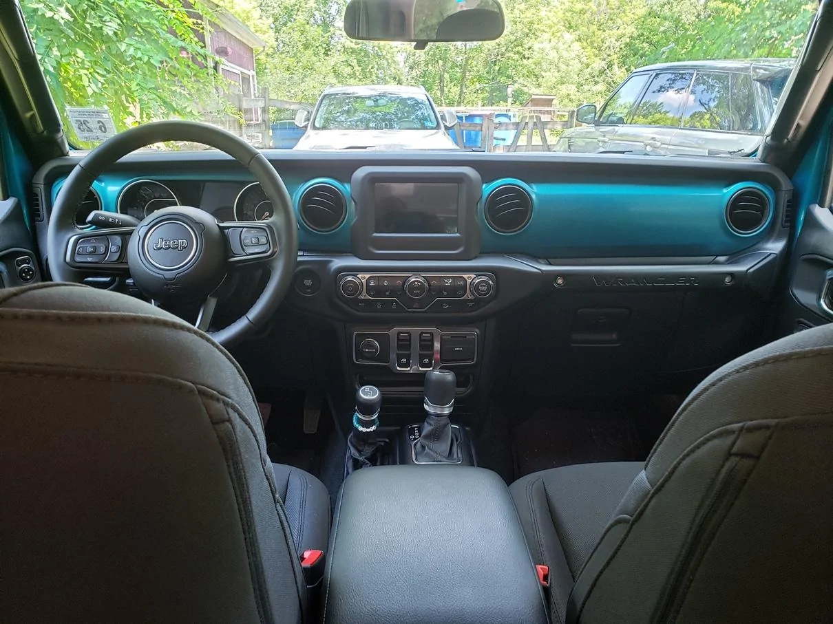

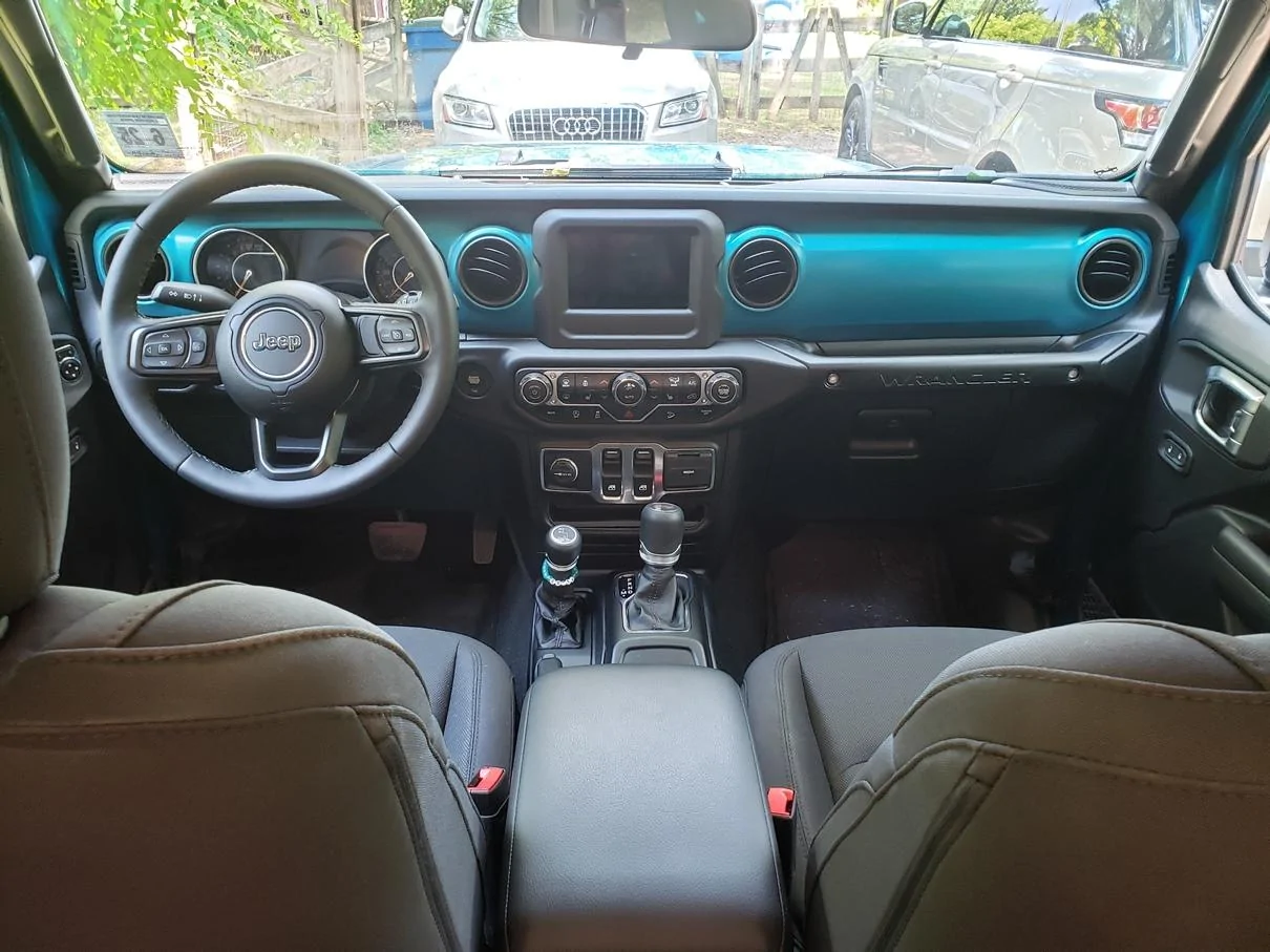

Ocean blue with a mojito dash... Interesting. You should take a wider pic for the color contrast to show up better

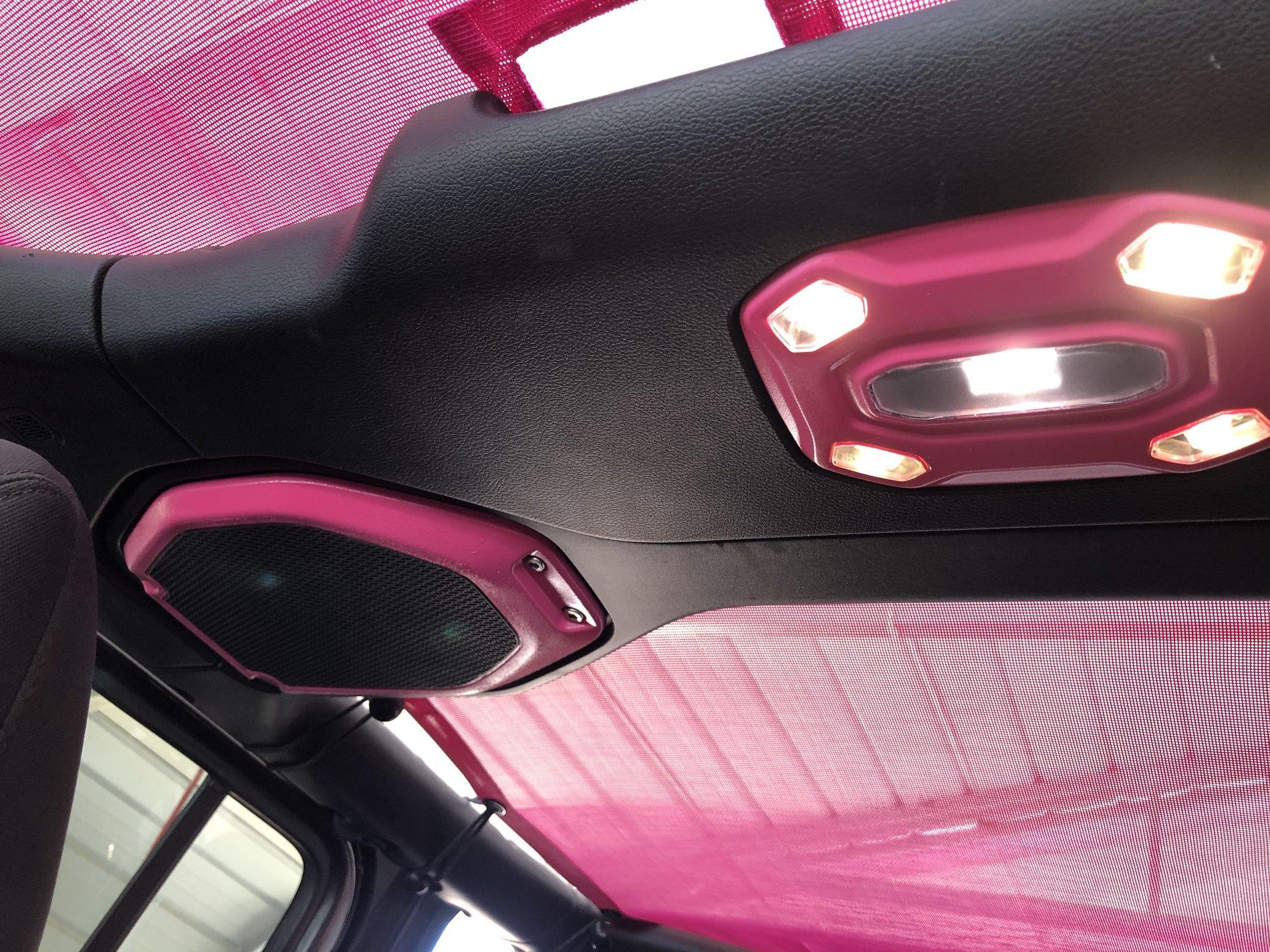

I did the speaker bezels too a few weeks ago
How hard was it to do the speaker bezels? Anything I should know, getting ready to do the dash and I’d like to do them too. Thanks!

Funny you asked that --as originally I told my daughter no way in heck can it be done easily.
Turns out - 4 screws and the covers pop right off. I took my time to tape off the lines, and covered the back side due to overspray potential.
I did 3 steps for all my plastic painting.
1 - Clean using a good cleaner
2 - scotchbright to rough up paintable surface
3 - precoated with a paint adhesion promoter.
I then used 3 coats of paint and put it back up. It was so simple to do all the dash trim, I will be doing it on my Rubicon soon. Right now I have those cheap stick-on plastic red accents. I liked them until I painted my daughters jeep. Now they look cheap to me.
