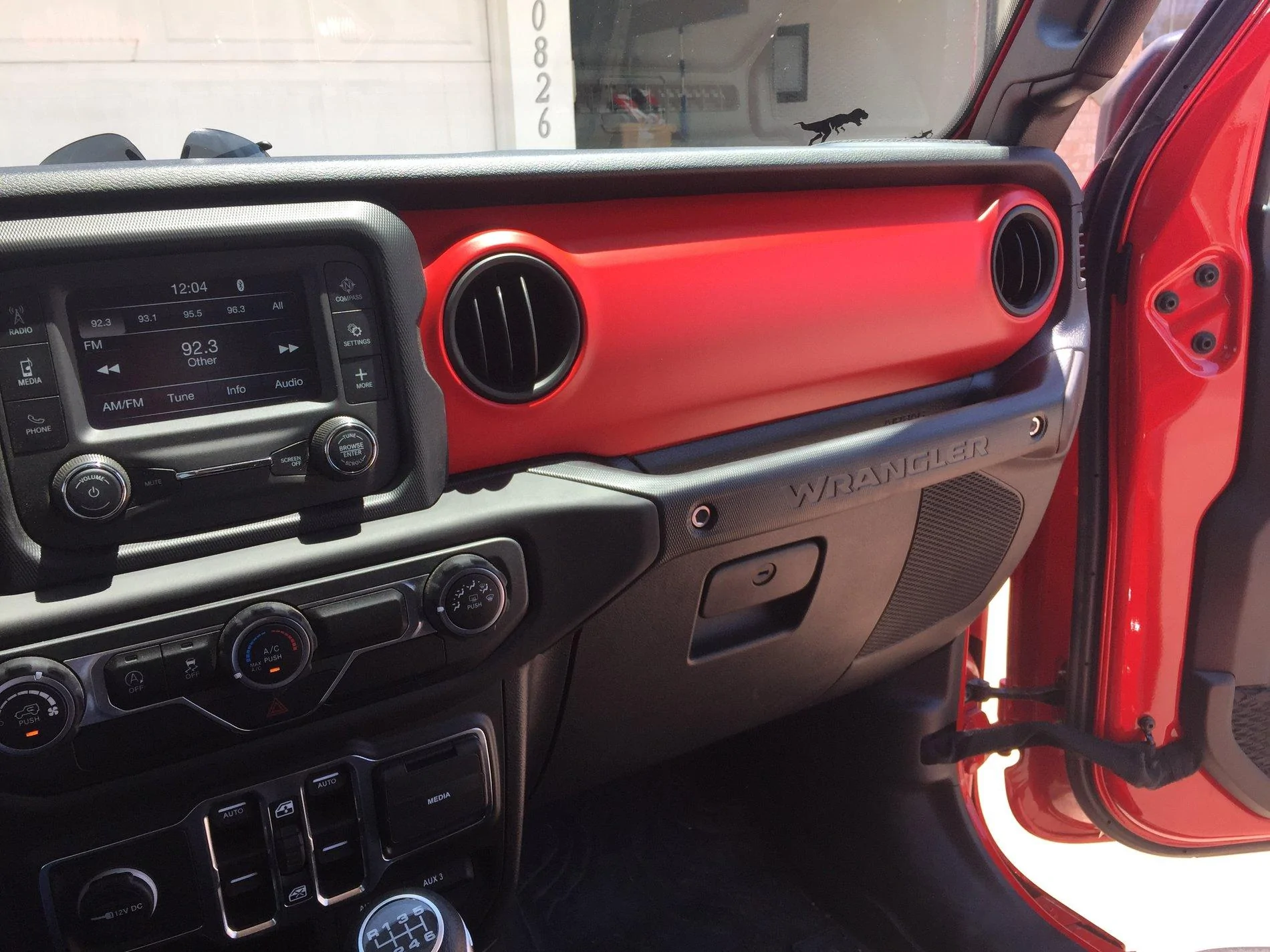

When I had my dash painted I couldn’t find Firecracker red. I took it to a touch up paint shop and the color code cross referenced to Speed Red. Had mine painted and a satin clear finish on it.
Jeep Wrangler JL Show off your DIY painted dash upload_2019-9-15_20-44-23
HTH

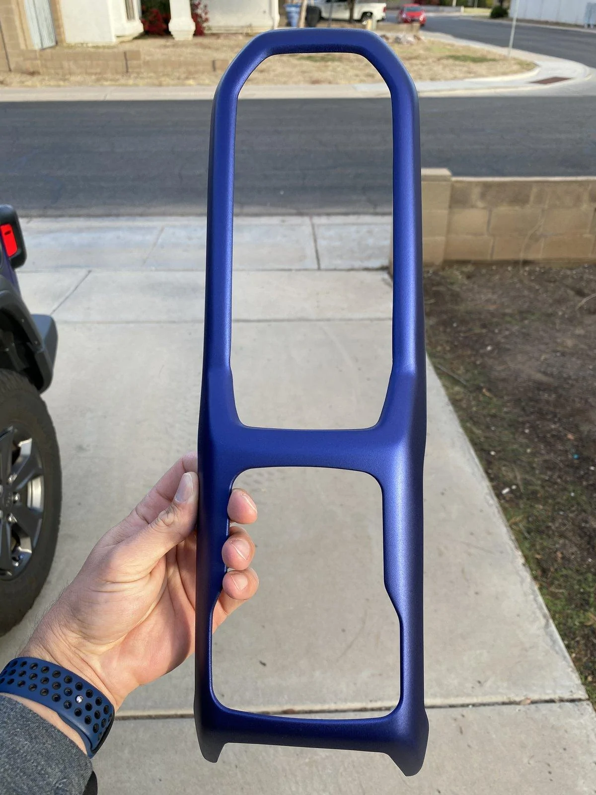

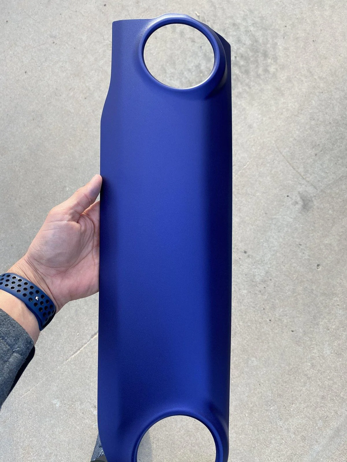

So I bought these trim covers, as I was afraid I’d screw up my factory ones. I wanted to paint them blue. I wanted the color to be just a hair darker than Ocean Blue, so I used Duplicolor Sonic Blue Pearl. I’m happy with the result....but I’ve still got to put a clear coat on it. With the pearl in the duplicolor....I really don’t want it to look glossy. Over a pearl base, how do I get a smoother satin/matte finish? I used a swatch to put a satin clear over it and I thought it looked a little cheap. Any ideas?

A problem with DIY satin is that (as far as I know) you can’t color sand (wet sand) any imperfections. It looks like you have quite a bit of dimpling / orange peel there, which (I think) can only be removed by sanding.
You might want to color sand and see how it comes out.

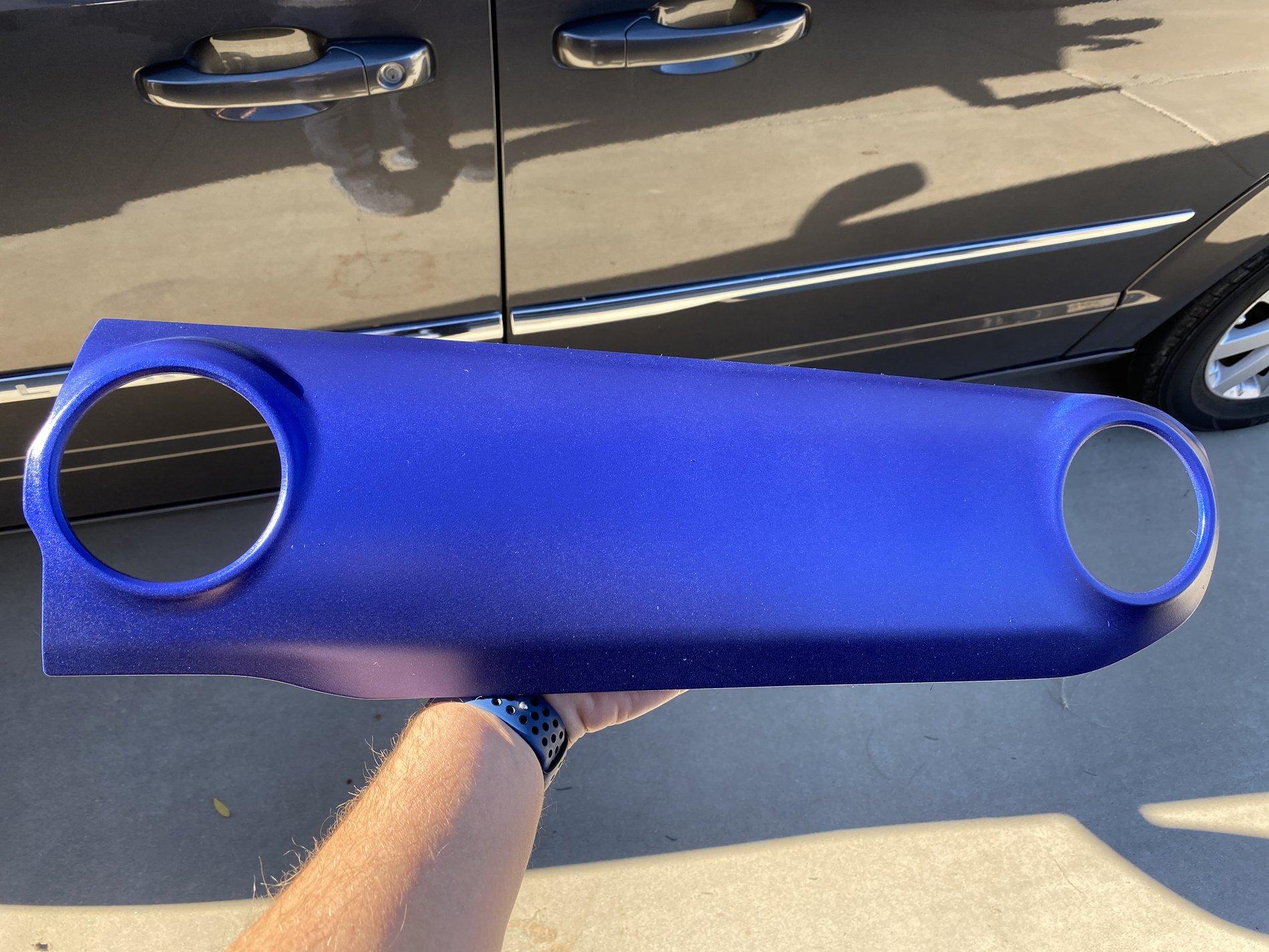

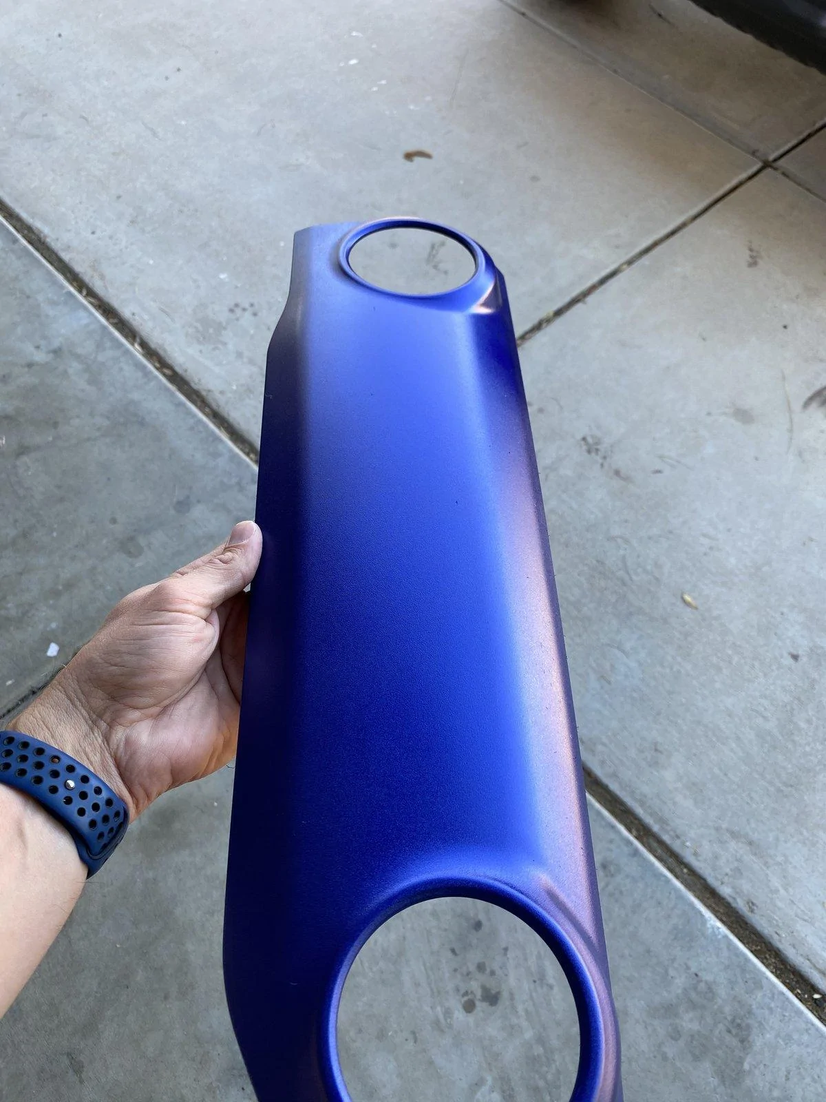

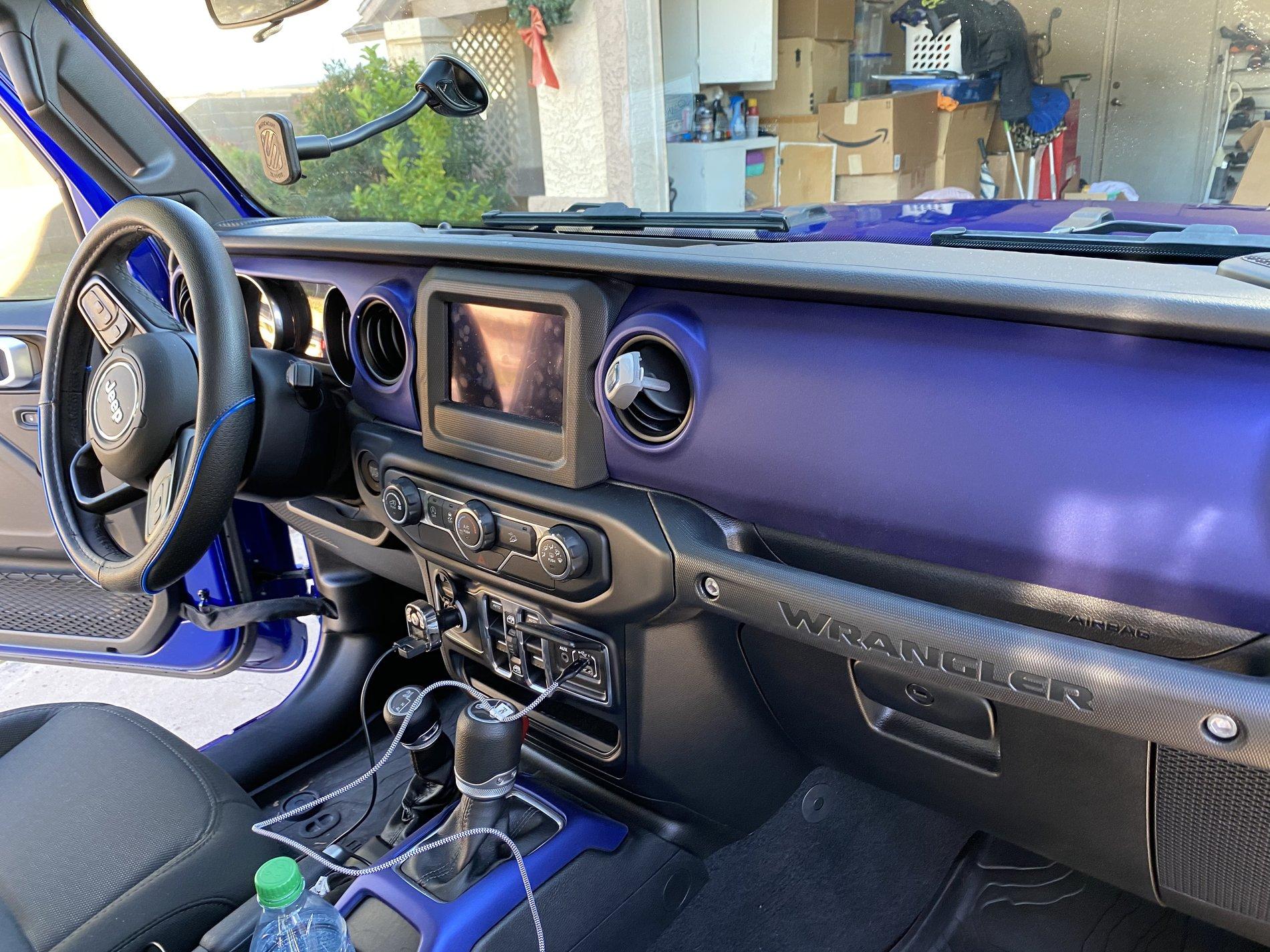

So an update. I re-worked them a bit by sanding and adding 2 coats, then put 3 matte coats on.
