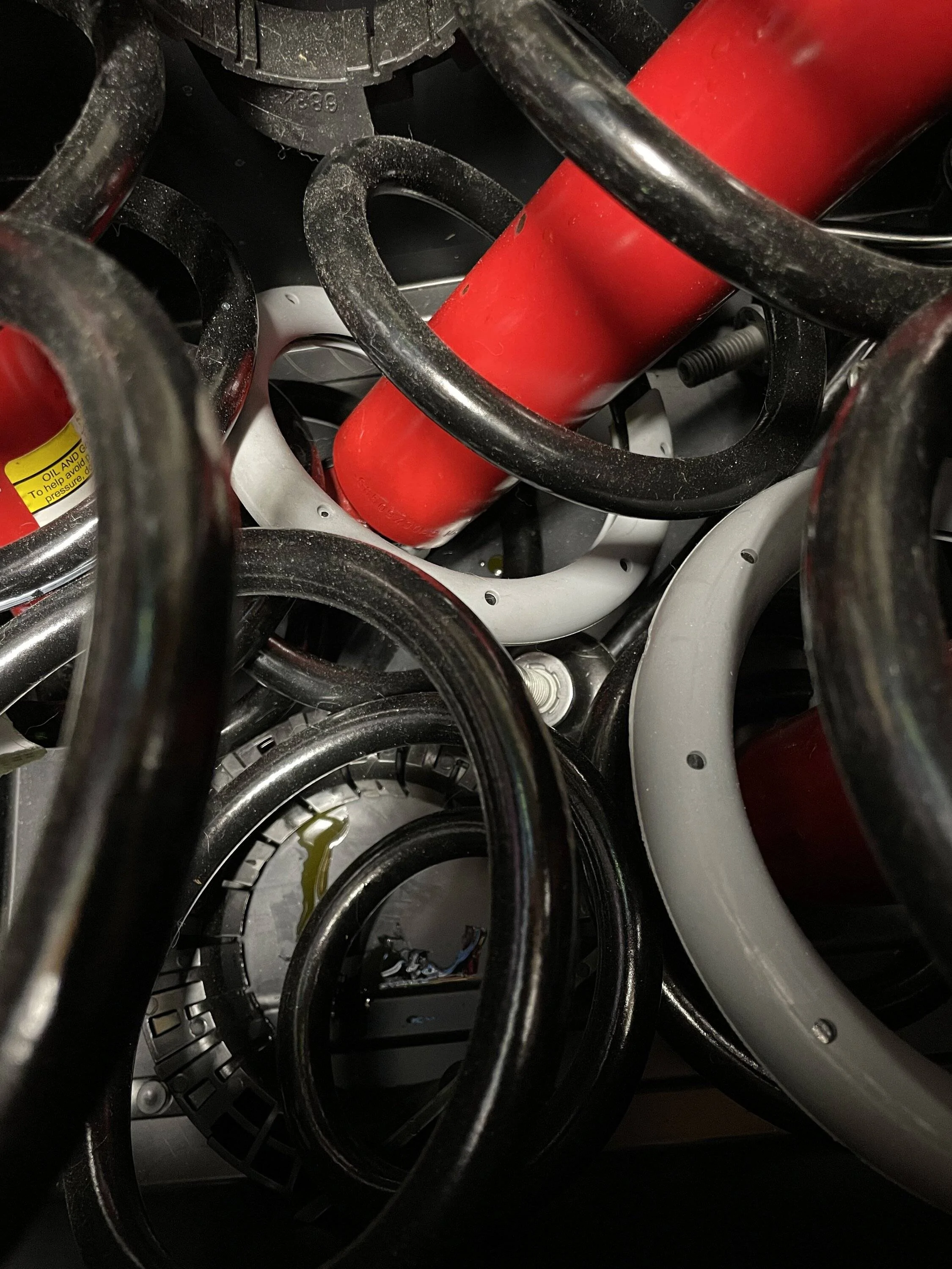

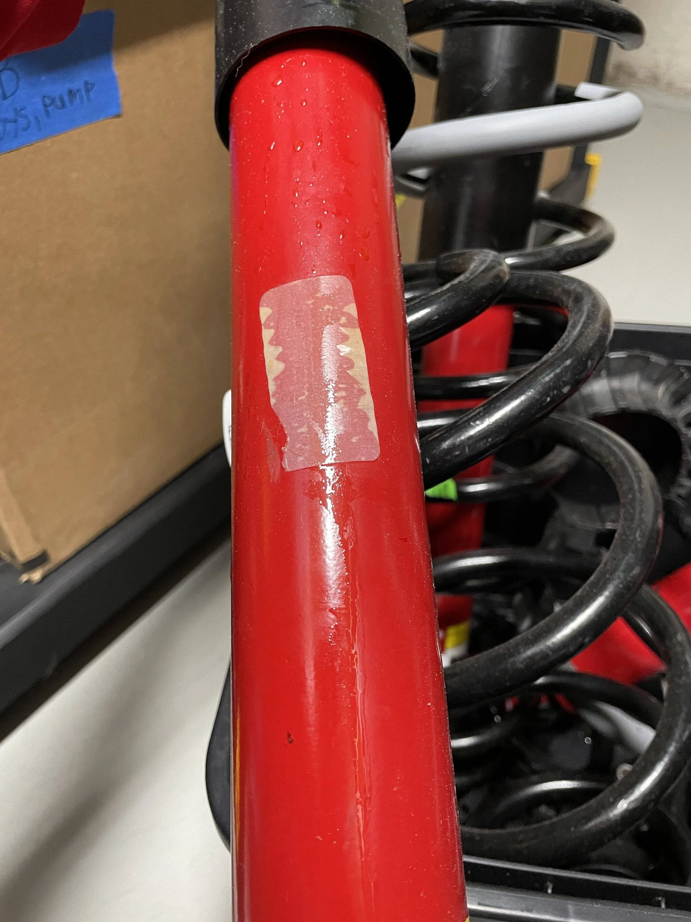

I bought a set of rubicon takeoff suspension parts for my sport s. I ended up letting them sit for about a year, earlier today I decided to try and install them and noticed the shocks may be leaking now. I did not know they were meant to be stored compressed until now. They have just been sitting in a box upright. Would these be considered leaking/unusable?

any sign of oil from the seals and they are toast - regardless of weeping or leaking - shocks don't cry....
That’s unfortunate. Should I just toss these then?
YES they are leaking, CHANGE ASAP!!!!!! You have a shock out of sync with others and this is a free ticket to Tire CUPPING!, buy new shock NOW!
