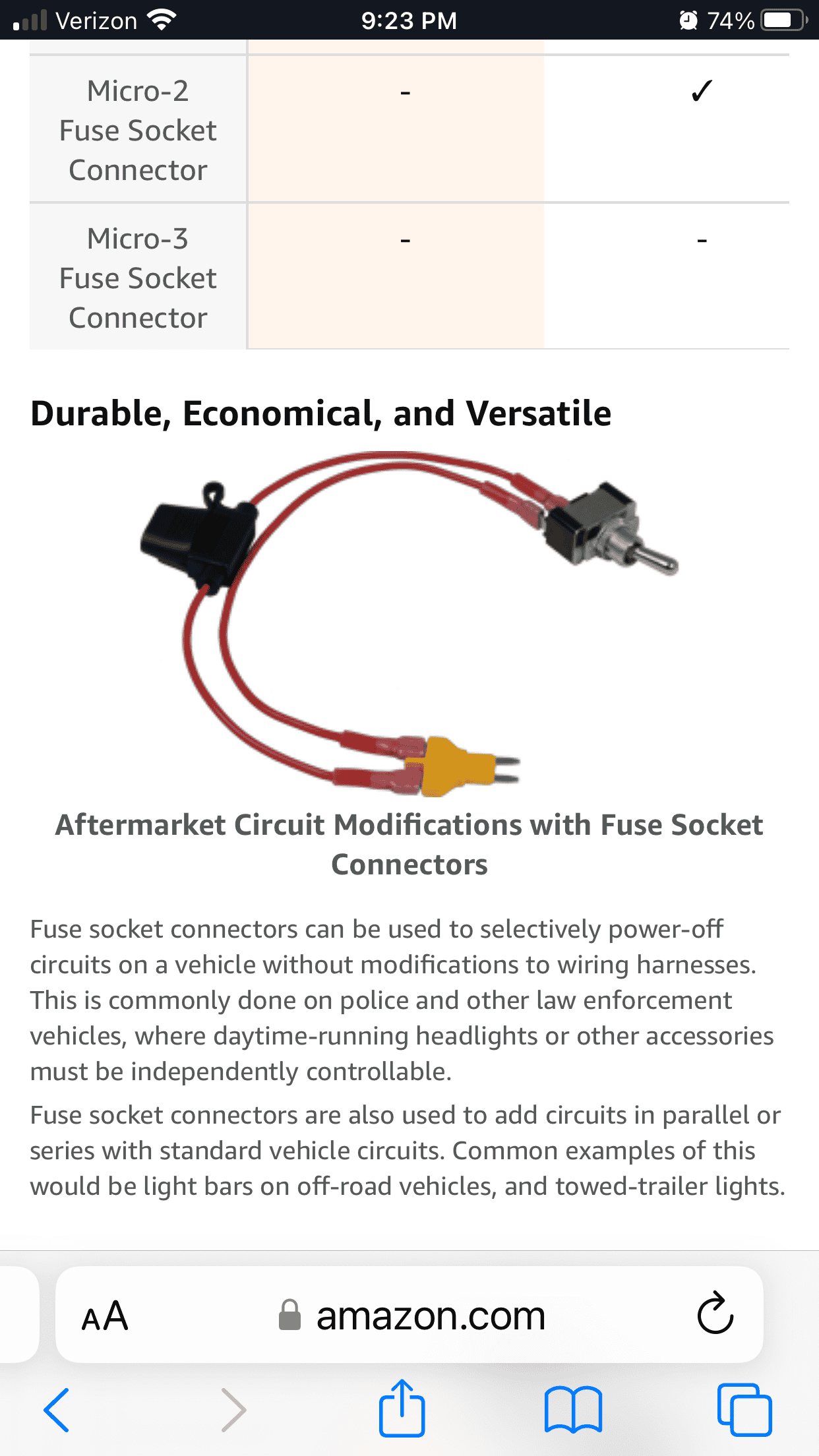

maybe another option, i’m not sure? looks like it might work in theory? what do you guys think? this of course if you had a hood lock that wasn’t pickable but as i understand it, they’re pretty easy to pick
Very interesting option... thank you. I think my original question to the group still applies though, which fuse (starter, fuel pump... etc) would have the least possible negative consequences or risk "bricking" my Jeep computer and leaving me stranded anyway.
I am leaning towards just pulling the starter fuse and locking the hood. Will this work as I believe and just disable the starter if a thief attempts to steal the jeep? Seeing as my Jeep is a manual, would this stop the Jeep from being "old school" push started? Dont know how many car thiefs these days even know what a manual transmission is, but thinking the fuel pump fuse may be better option from that perspective.

if you’re going to pull something, why not pull a fuse or relay to the fuel pump? this would surely answer your question in the negative.
another thought - if they can pick the lock to the door, why couldn’t they pick the lock to the hood?
another thought - couldn’t they just pull the cord in the console to put it in neutral and wheel it away?
