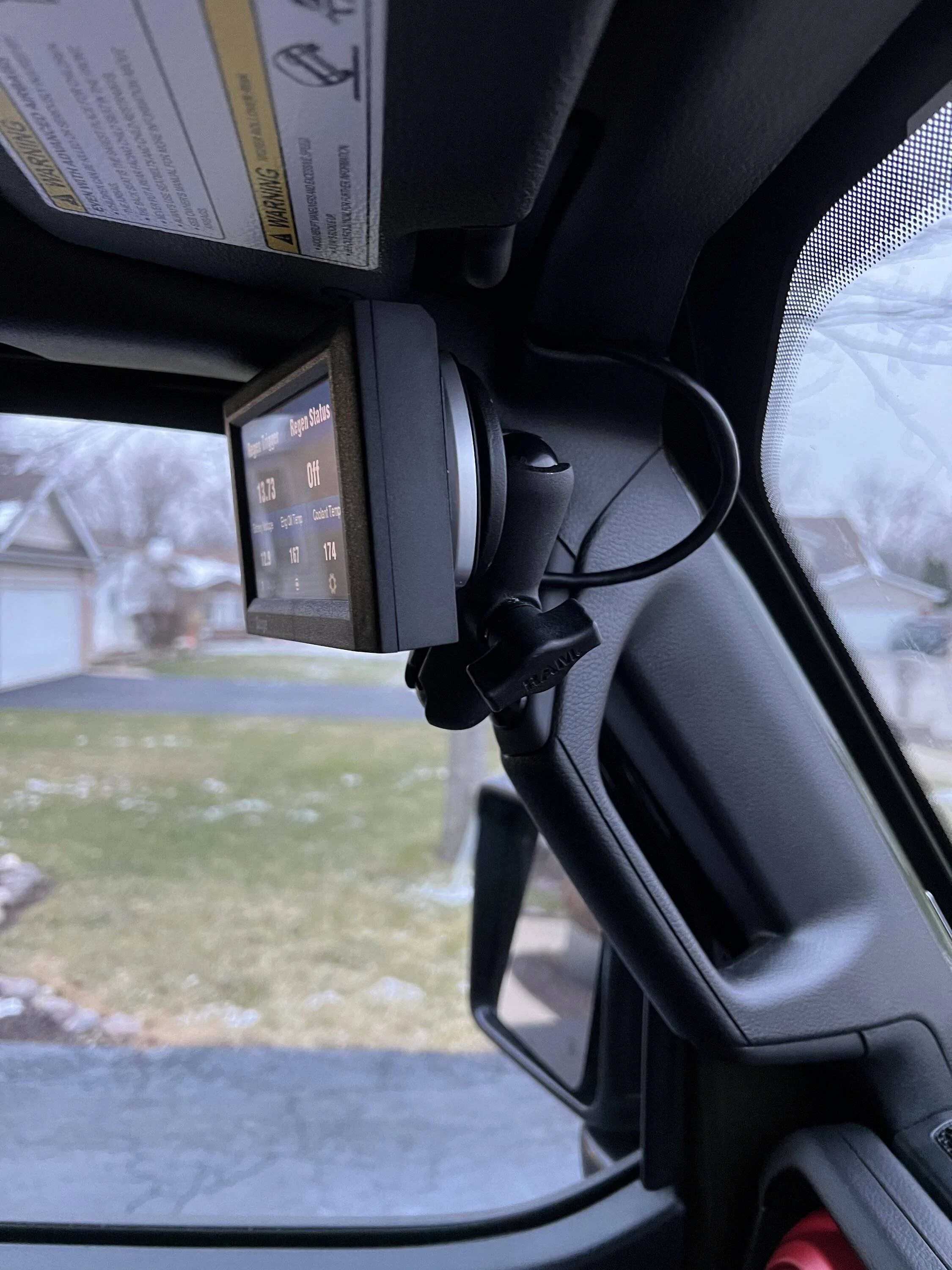

Done, very happy with the mount. Fished the communication cable behind the pillar cover, very clean.

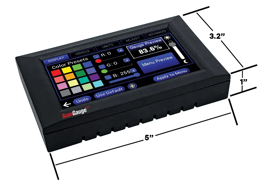

I would say it's about twice the size of the ScanGauge 2. Actually it is pretty much identical to my wife's iPhone 13 Max Pro, but thicker.

Where do you mount it so it doesn't interfere with the sun visor?
It does interfere with the sunvisor when at the top left corner. However, you can still put it down, just not all the way

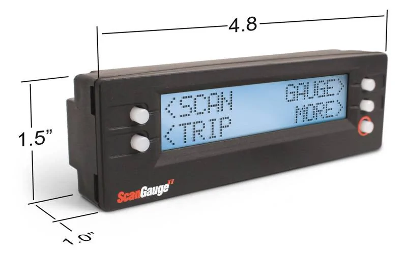

Here is a size comparison, SG2 vs SG3

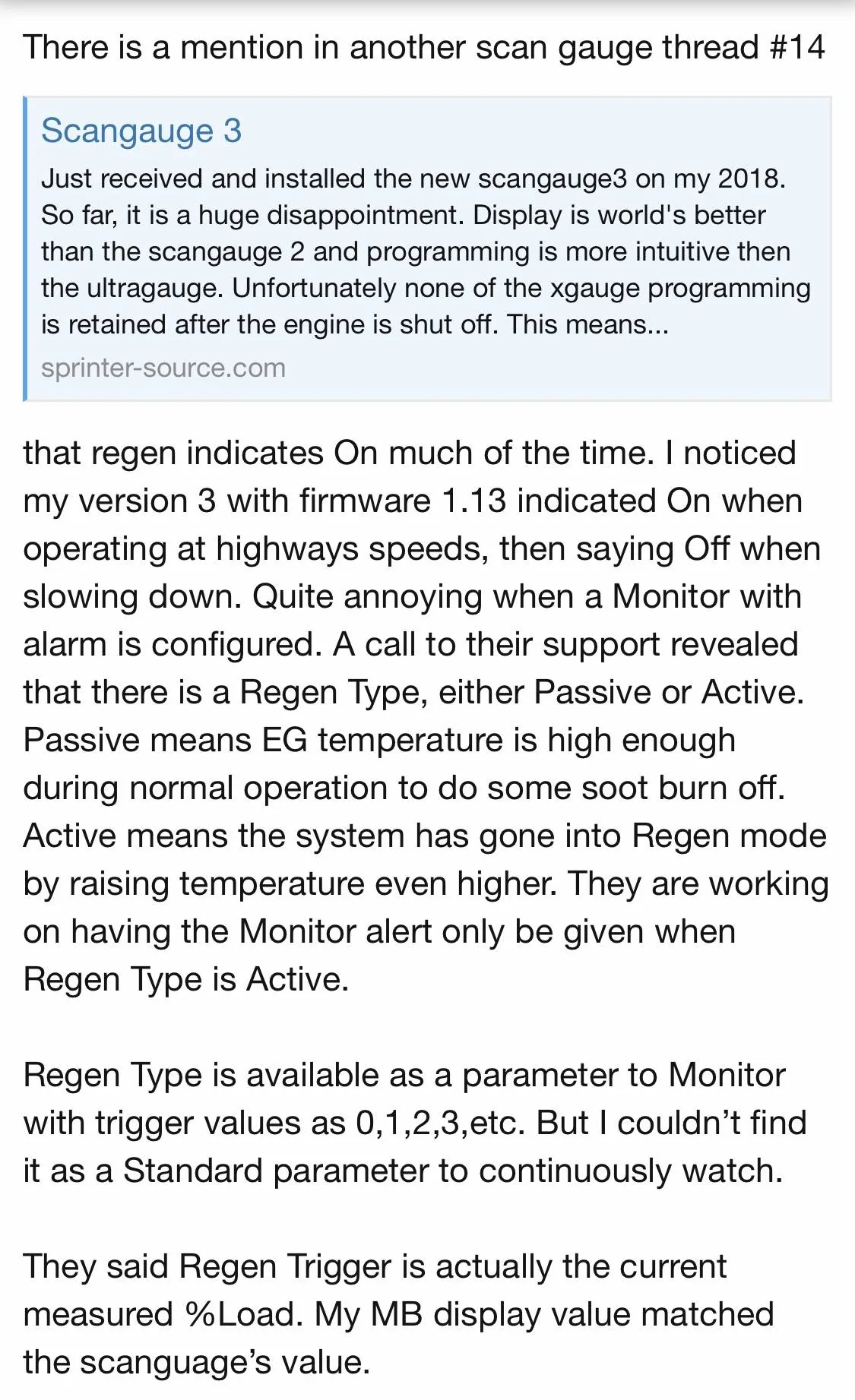

Also found some thread on different forums of other people reporting some issues that apparently the manufacturer is still addressing

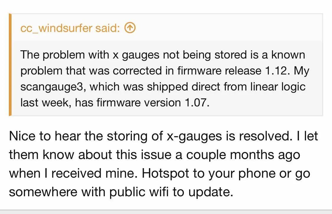

"None of the xgauge programing is retained after the engine is shut off"
How can that possibly be true?

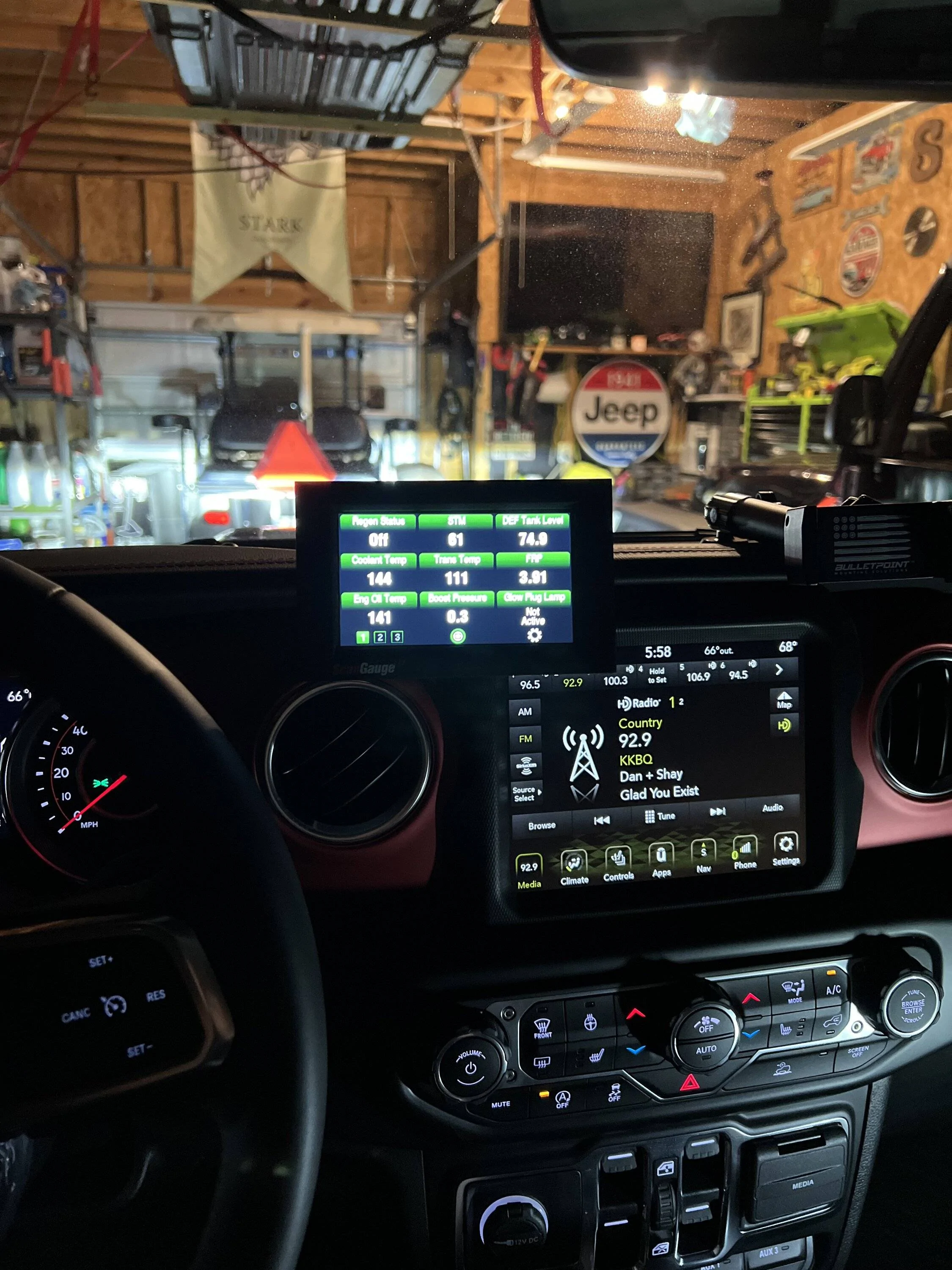

Got it today along with my Bulletpoint magnetic mount, easy install.
How did you end up running the cable.
I used the suction cup and attached it to the lower left of the windshield, running the cablebup the door jam and onto the top of the dash... but it takes on too much heat from the sun so I don't like it.
I have the bulletpoint setup, would like to maybe try it there.
