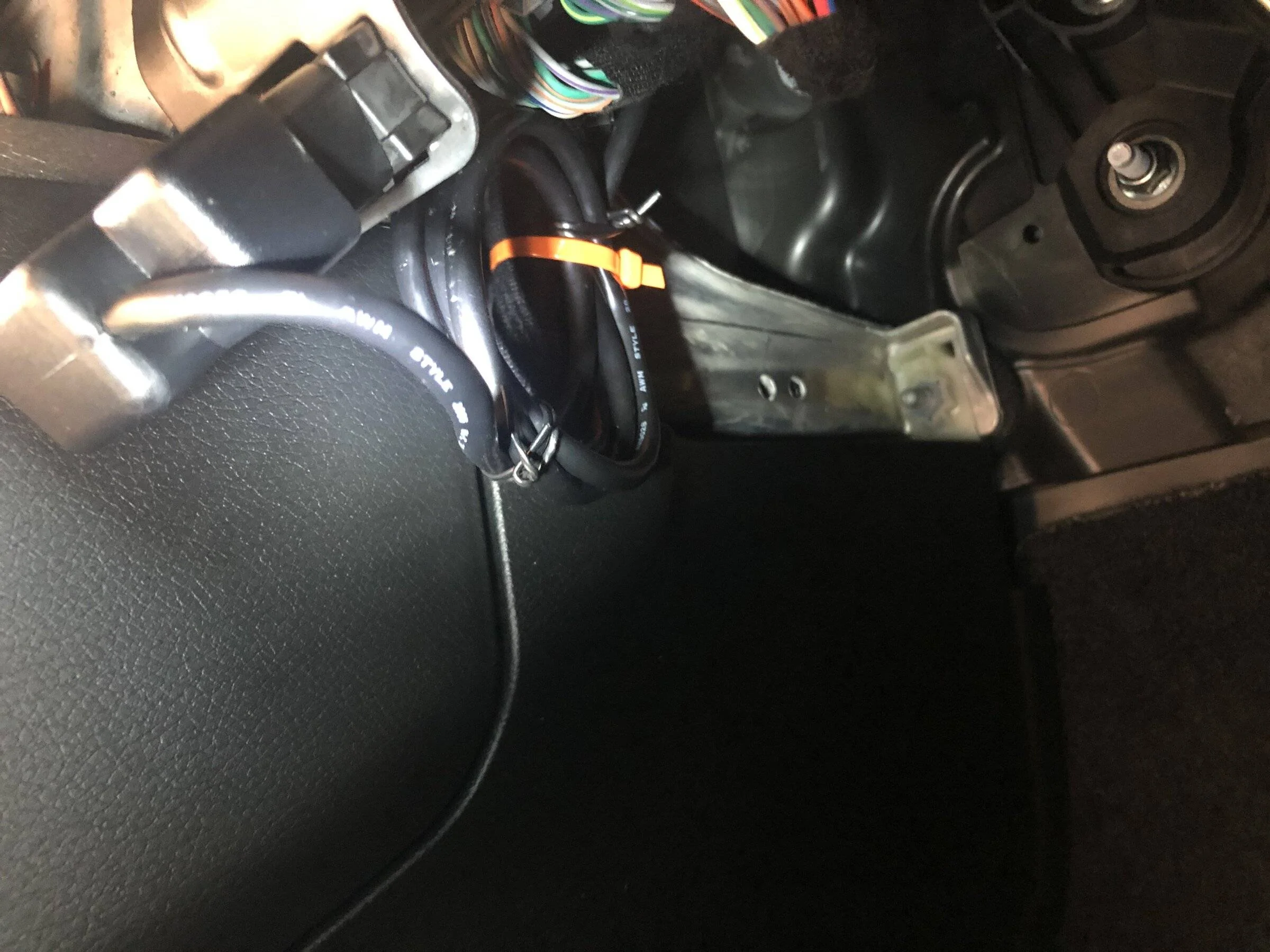

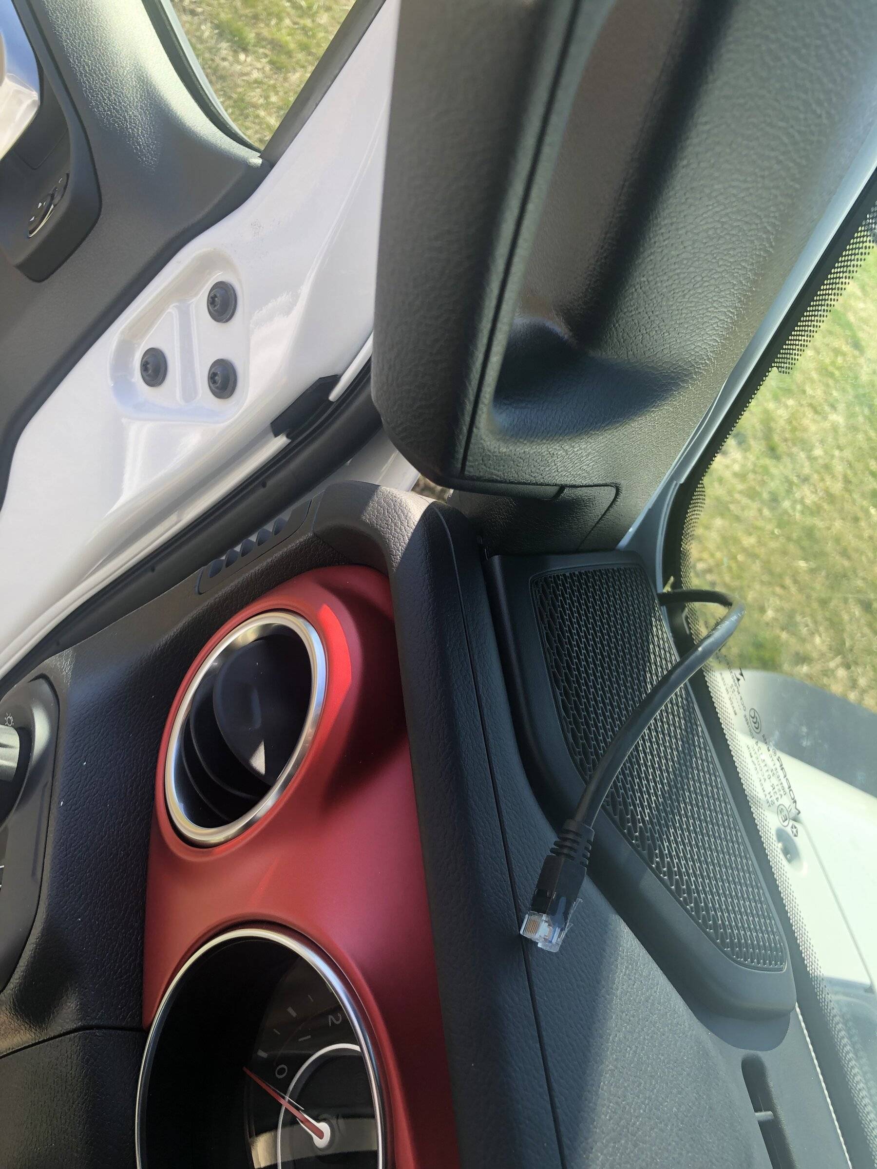

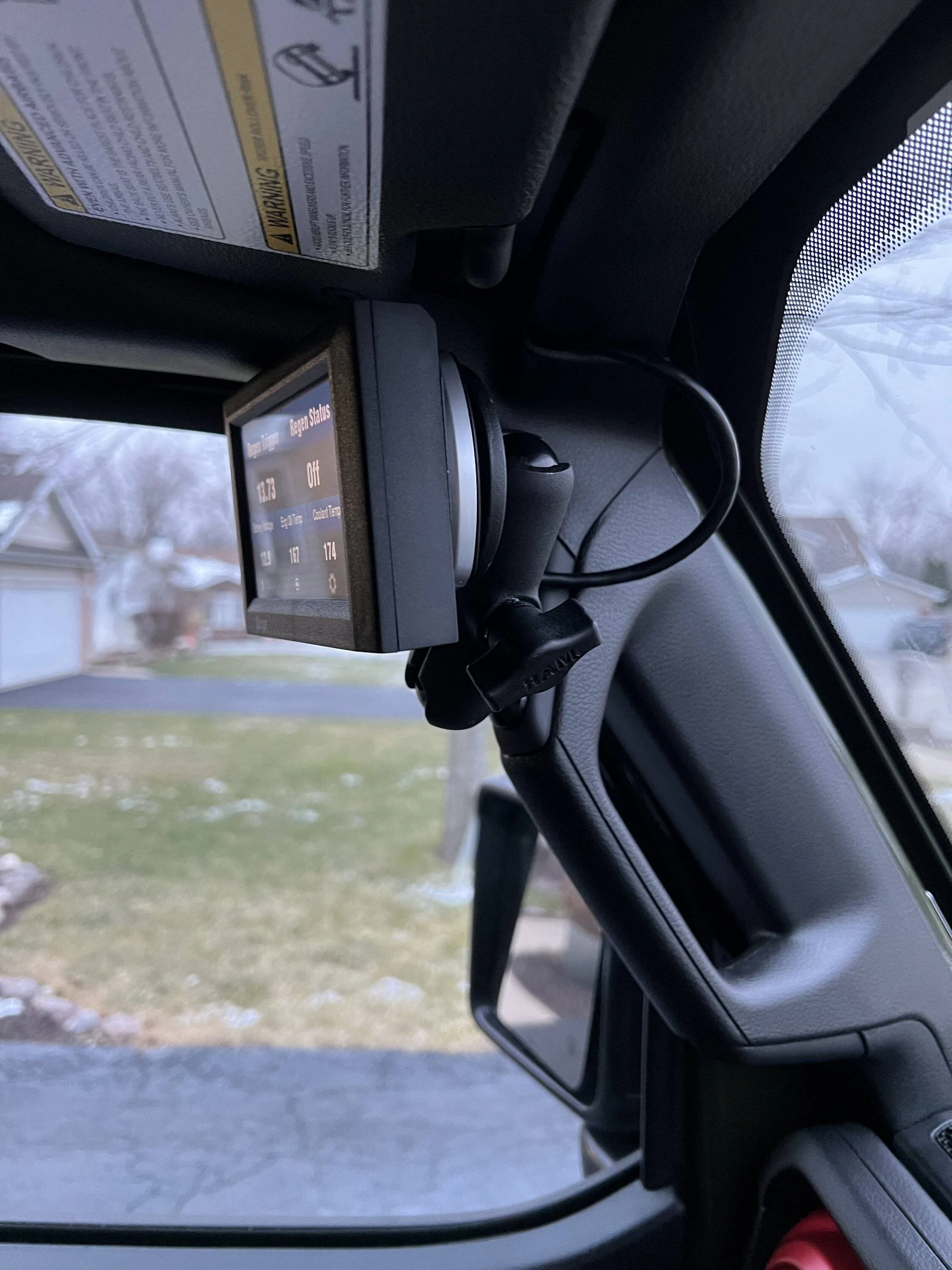

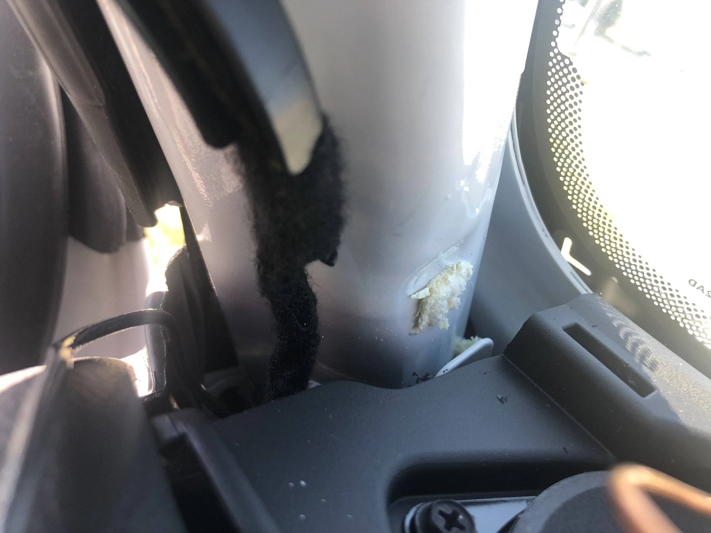

I did the install today following the instructions on this forum thread, took a bit to fish the wire but it was pretty simple other then that, thanks for everyone for posting the photos and explaining the step by step ?

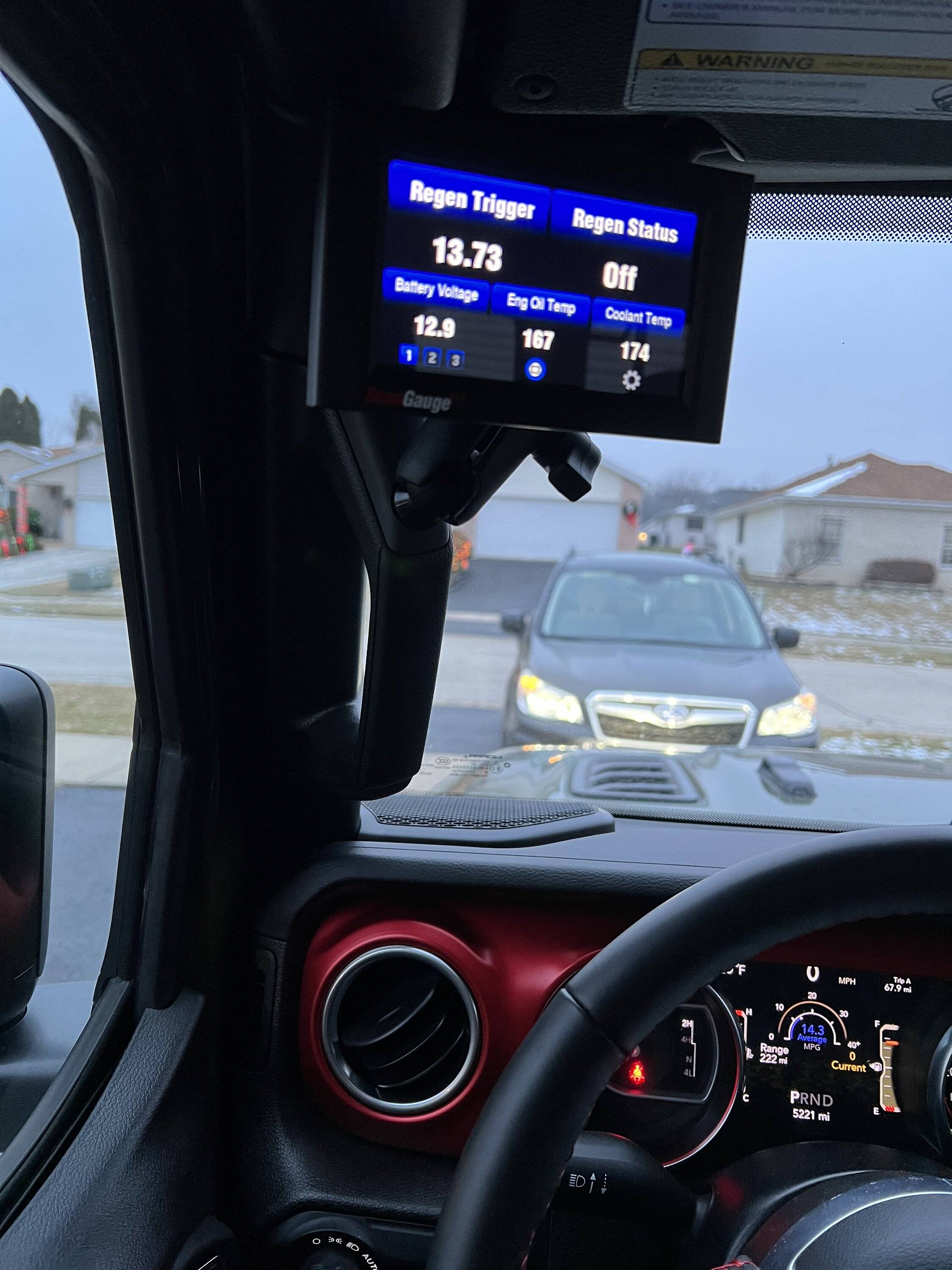

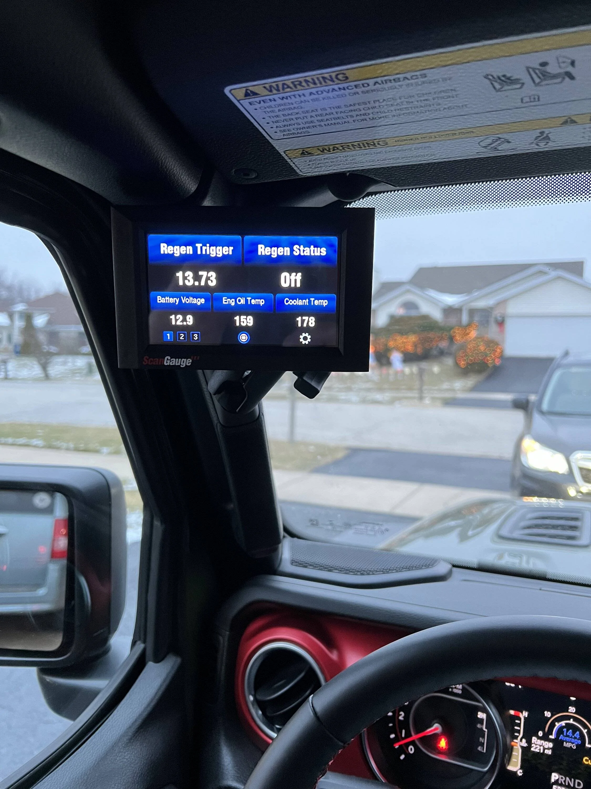

Just finished my ScanGauge 3 mount. Fish the communications wire all the down the pillar to the OBD. Wiring is ran alongside the factory wiring behind the molding.
What is "Regen Trigger"? What does that number 13.73 mean?
