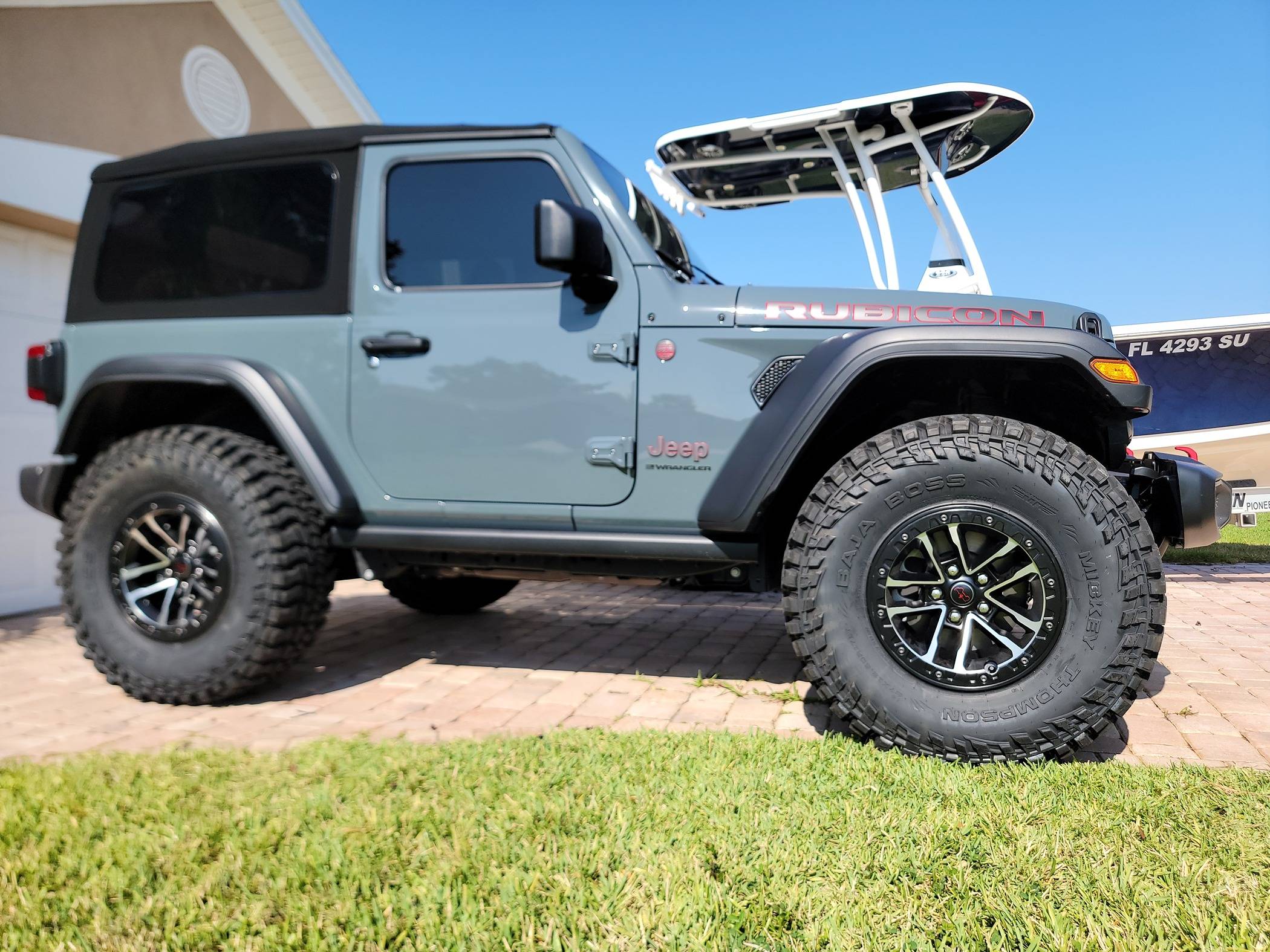

Jeep Wrangler JL Rubicon 35" tire package 20240508_130639

Just got the 37's on. But in my excitement, I forgot to get the stock clearance measurements.
Damn, it Looks Great! Let us know your thoughts with the 37's for ride, handing and acceleration. No suspension mods yet, correct?
I really wanted (still going to try) to stick with 35's on mine this time around but... ?

Thanks. Completely stock right now. So far no rub lock to lock while rolling in a parking lot. Acceleration has been great. Only have about 15 miles around town so far. Getting ready to install the tazer to correct tire size.
