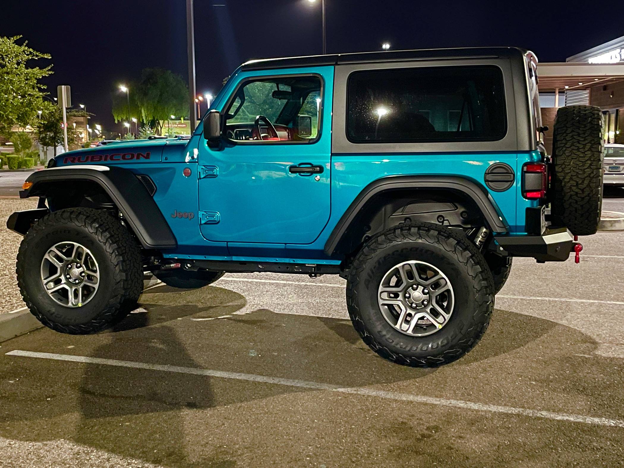

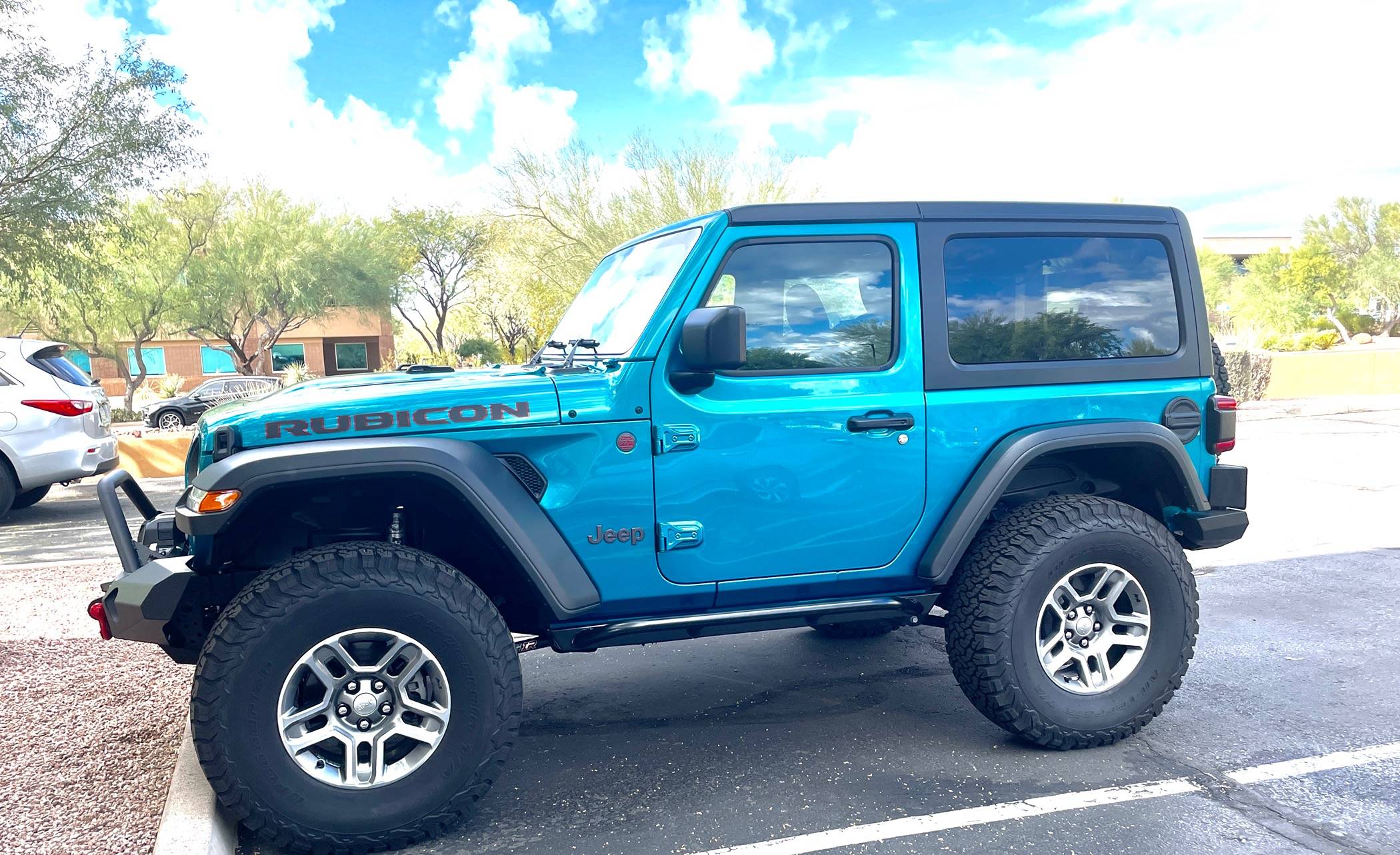

Let us know how that goes, I have the MC 2.5" front springs in my '20 JLR but when I installed the rear MC2.5" springs her ass was all up in the air! I wound up pulling the MC's and after verifying with MetalCloak they were the right part numbers, tried Teraflex rears and settled on Synergy rear springs as the best match with the front MC's.
Here she is with MC2.5" front and rear...
Here she is with MC 2.5" front and Synergy rear...
