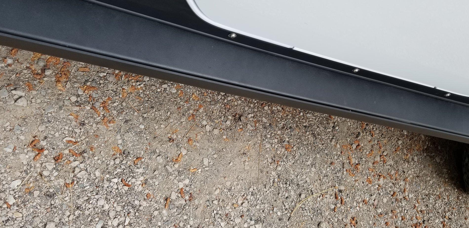

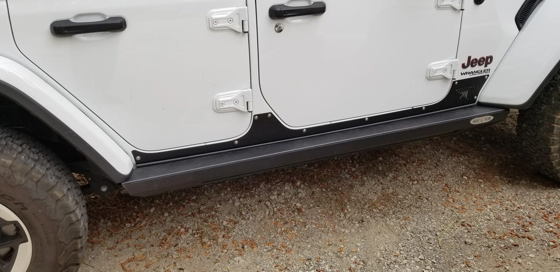

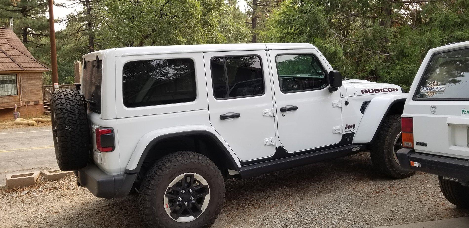

Here is a couple of pictures of the slider with the skid and rock guard.
Jeep Wrangler JL Rock slide Engineering fail 20200913_082039
Jeep Wrangler JL Rock slide Engineering fail 20200913_082110
Jeep Wrangler JL Rock slide Engineering fail 20200913_082133
