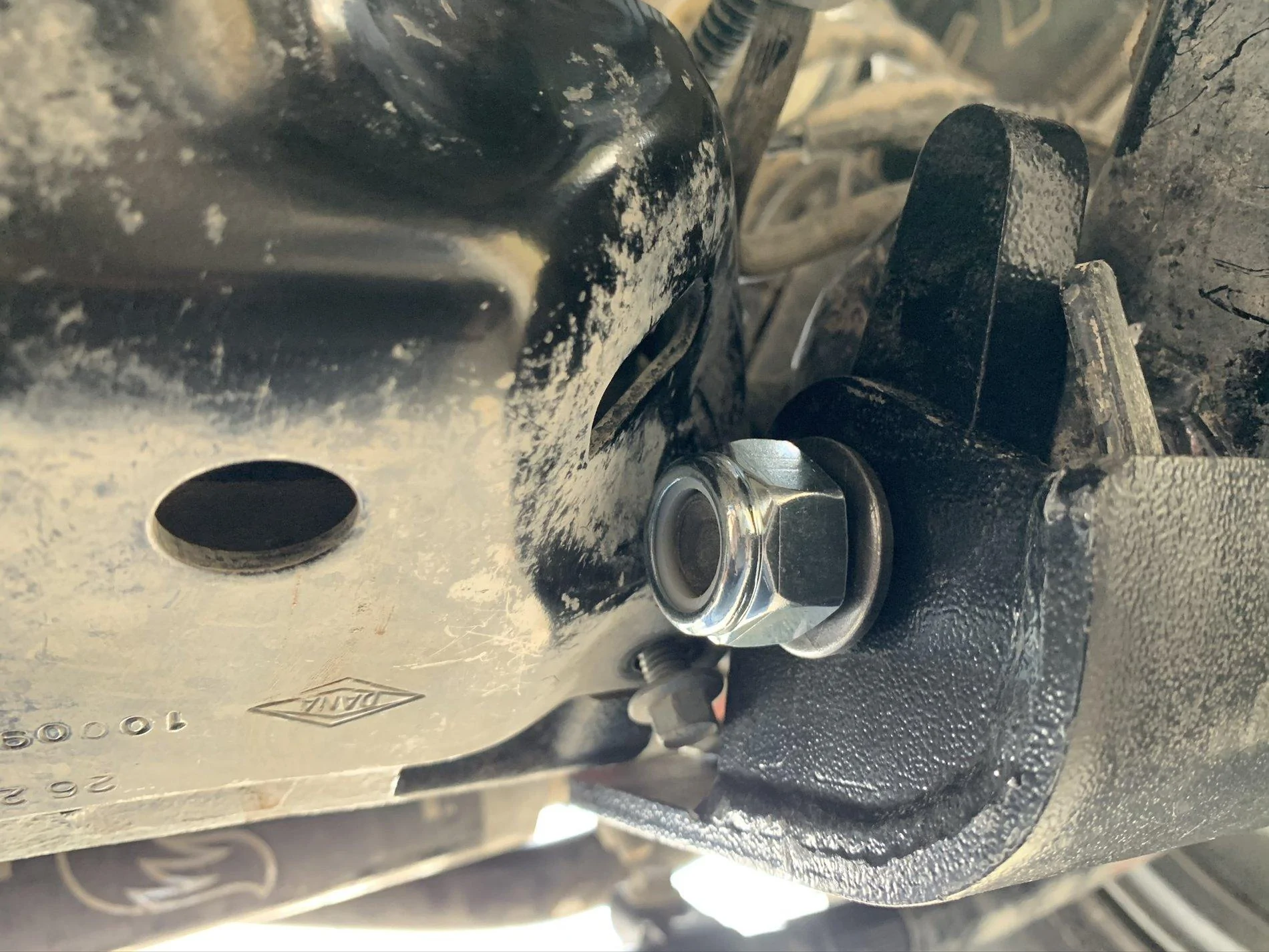

What is the purpose of the tabbed shim?
Are they intended to provide clearance for the shock mounts?
Yes. They’re a spacer between the wall of the skid and the shock mount. Here’s a photo of how they fit.

Could the spacer be welded on the skid to simplify aligning all the pieces parts, or does the spacer(s) need to be loose so that you may clear the shock mounts when installing the skid plate?
It seems difficult to imagine why installing these plates would be any more complicated than installing the control arm, which seems to be affirmed by the Rocksport claim that they install in minutes.
Not trying to argue, just trying to learn more about these parts as they appear to be a useful addition to a Jeep.
Thank you!
Chocolate Thunder
Jeremy
Feb 20, 2018
221
5,353
10,507
I don’t see why you couldn’t tack the shim in place on the skid, but I don’t know why you’d want or need to. They’re not difficult to put into place at all. You’re holding it as you insert the bolt with the other hand, very easy to move it as needed to slip the bolt through.

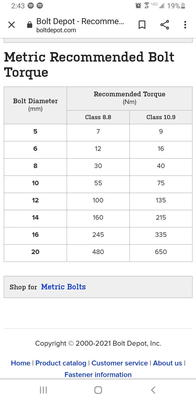

Different bolt than OEM, so different torque spec.
Sounds like this is an issue many have had due to the LCA bolt not being tightened down enough. Seeing that the provided bolt with the kit is 10.9 and 16mm thick, wouldn't the max nm be 335 ( being about 245 ft/lbs max ) ?
Seems like this is a nessasary amount of torque to keep these control arm bushings from creaking and making noise.
