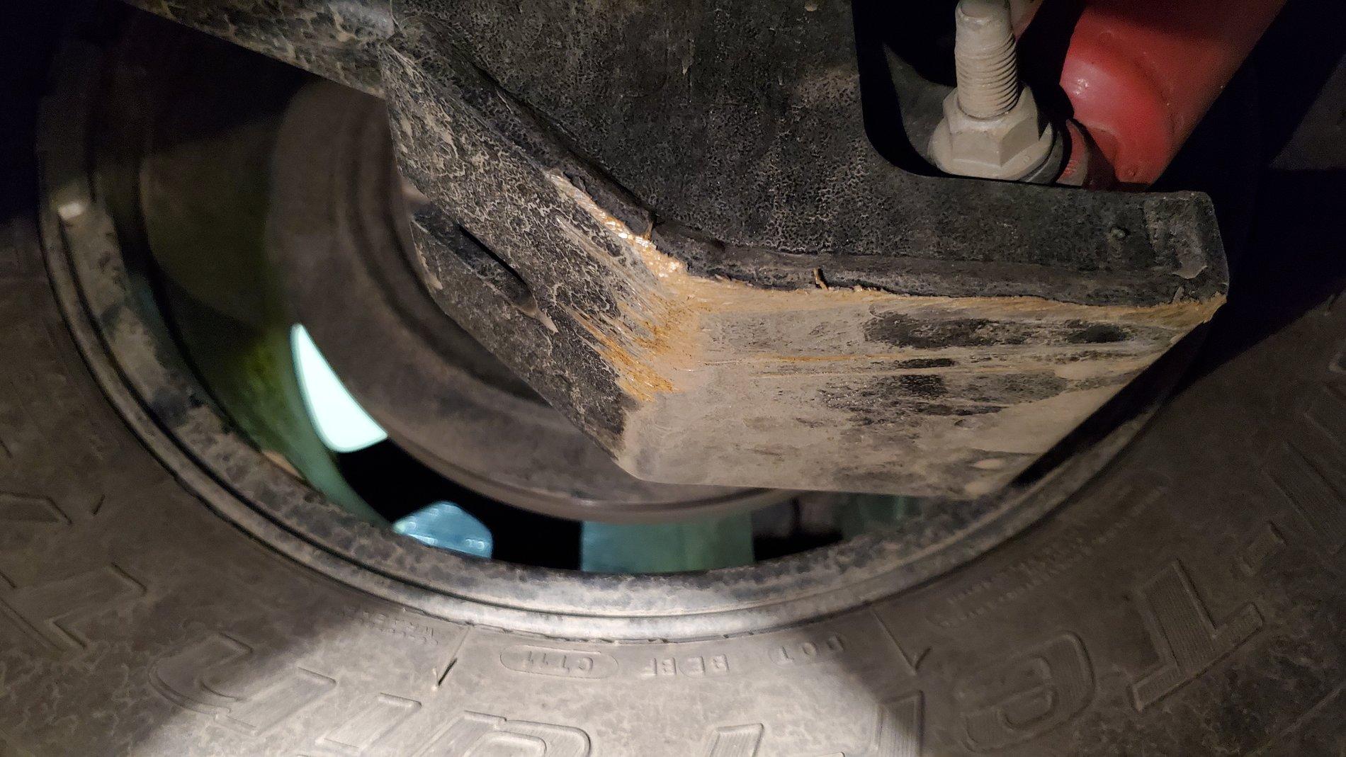

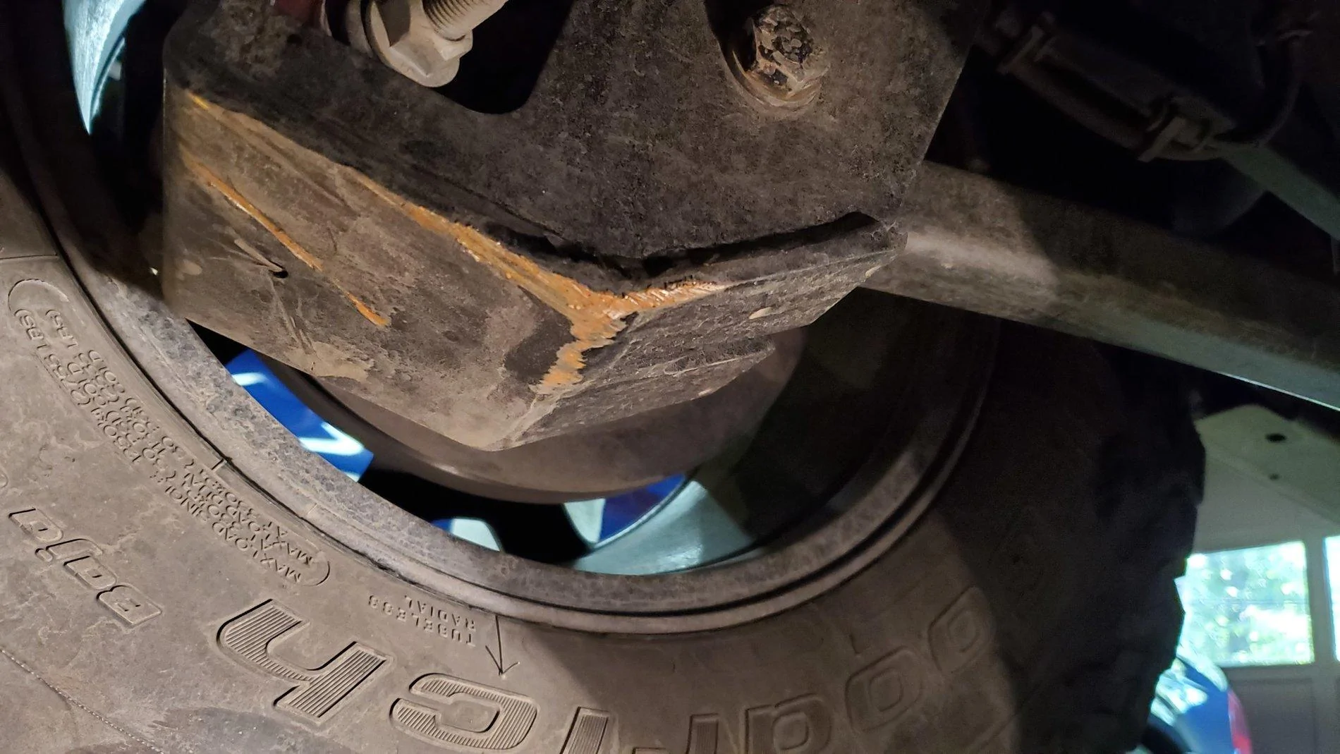

Went off road for the first time last weekend, fronts were unscathed but rears got some action. Very glad I installed
Jeep Wrangler JL ROCK HARD 4X4 Front Control arm skids. 20200908_132110
Jeep Wrangler JL ROCK HARD 4X4 Front Control arm skids. 20200908_132123
Note - I still need to flip the shock bolts so not sticking out, on the list, but got lucky this time
Mine already saw some action too and Im glad I had them. What torque values did you use for front skids?
