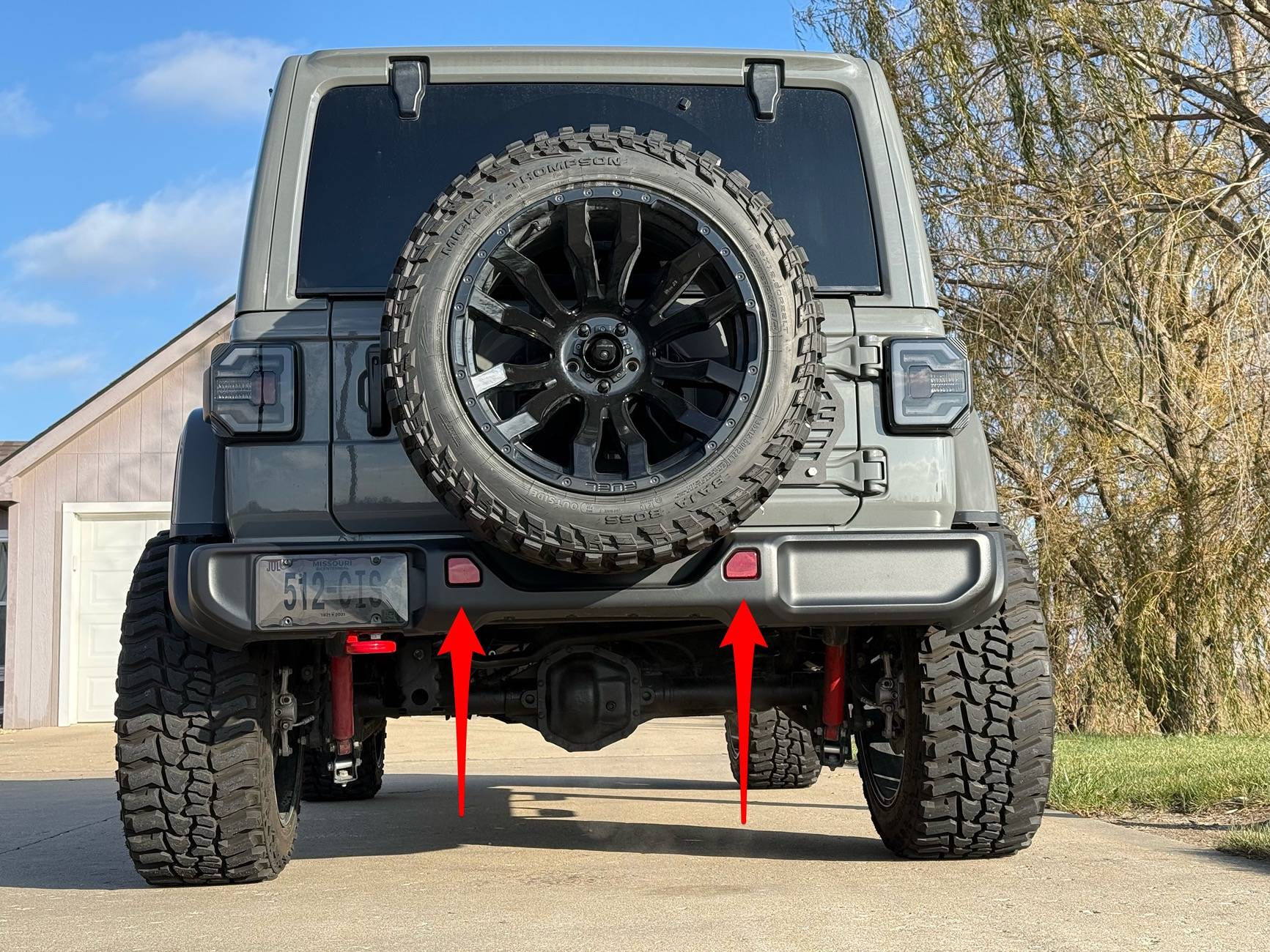

is it possible to install these reverse lights in this position where the reflectors are on the rear bumper? I dont know if there’s anything behind the bumper which wouldn’t allow this.

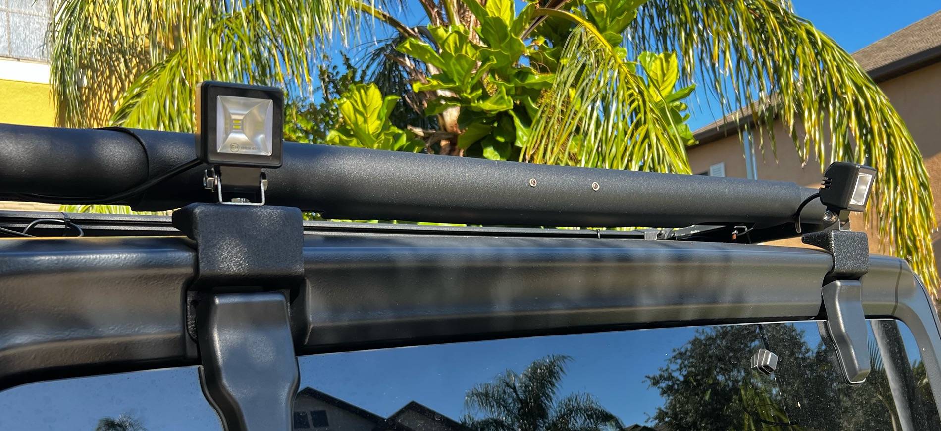

Maybe something different?
Jeep Wrangler JL Reverse lights in rear bumper question IMG_1749 Copy
Jeep Wrangler JL Reverse lights in rear bumper question IMG_1745 Copy

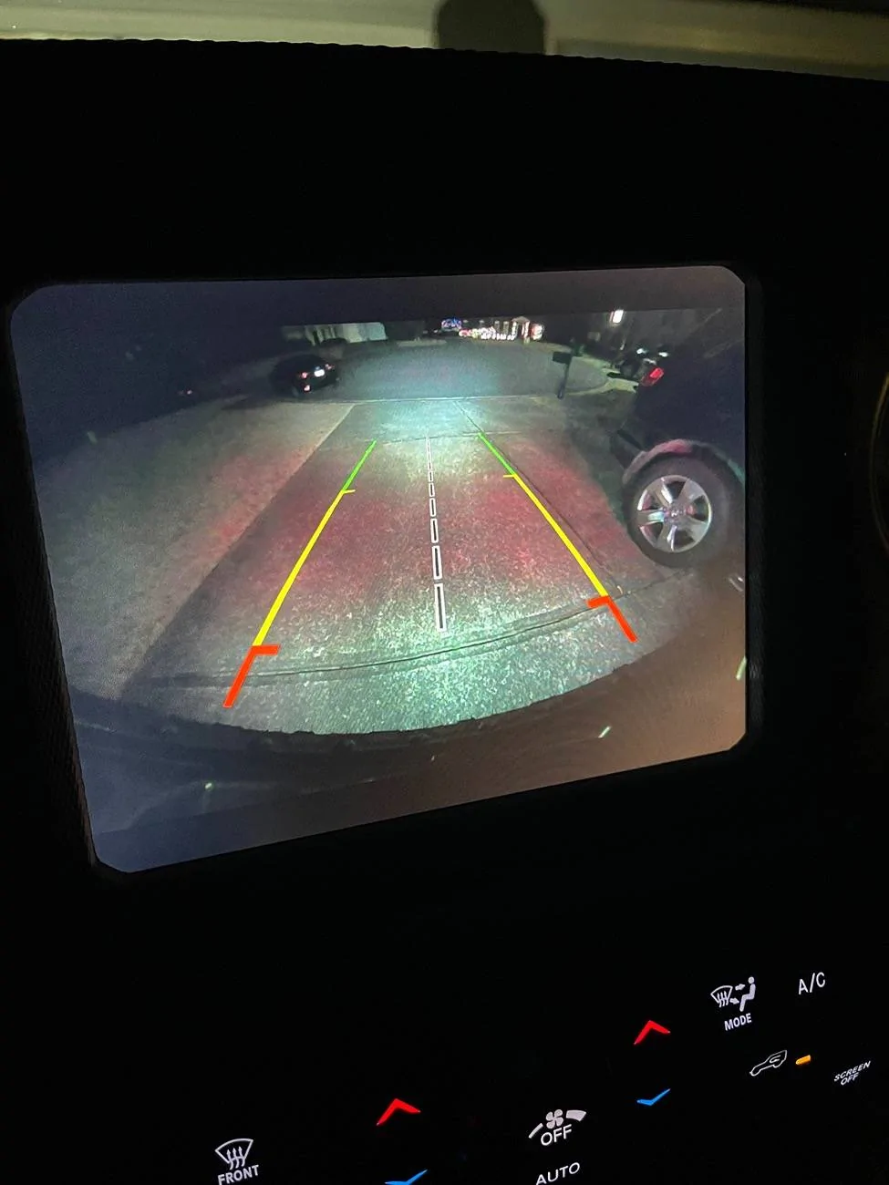

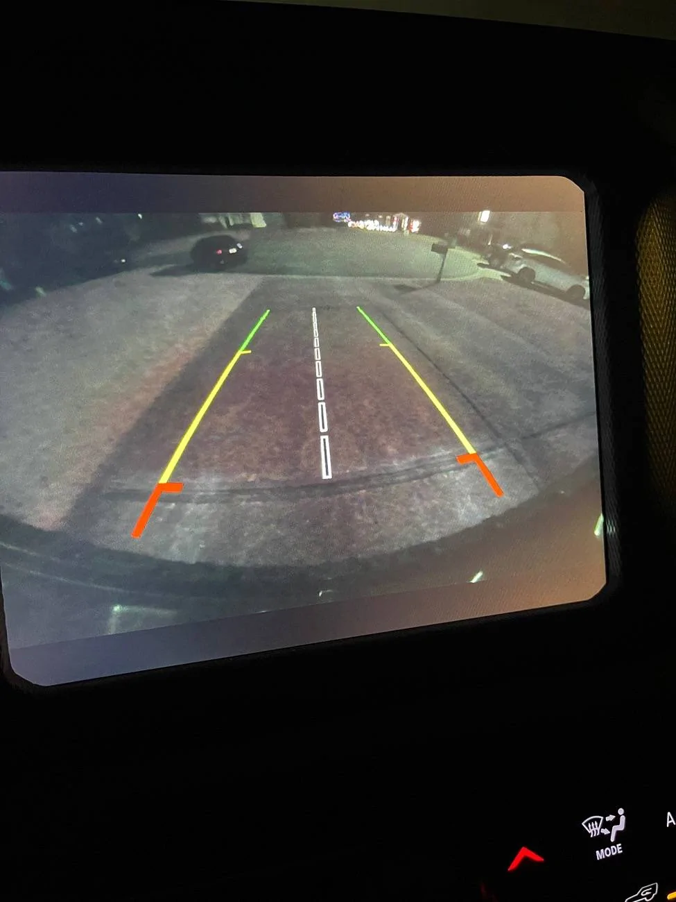

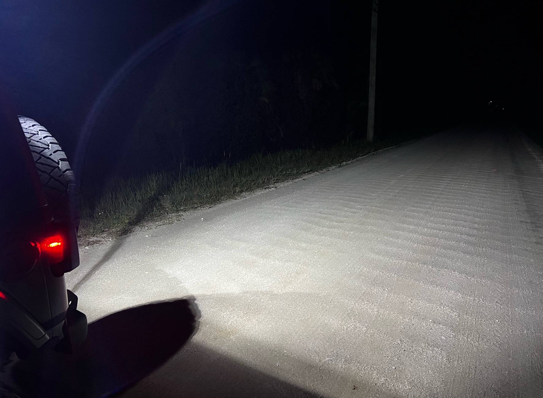

Anyone have any pics of the light output of the Oracles?
Are they a little more light than stock led reverse light or a lot more light?
May be a bit hard to see in the pics due to the cul-de-sac street lights and driveway incline, but they are considerably brighter than OE. No complaints so far, and no issues.
Jeep Wrangler JL Reverse lights in rear bumper question IMG_5154

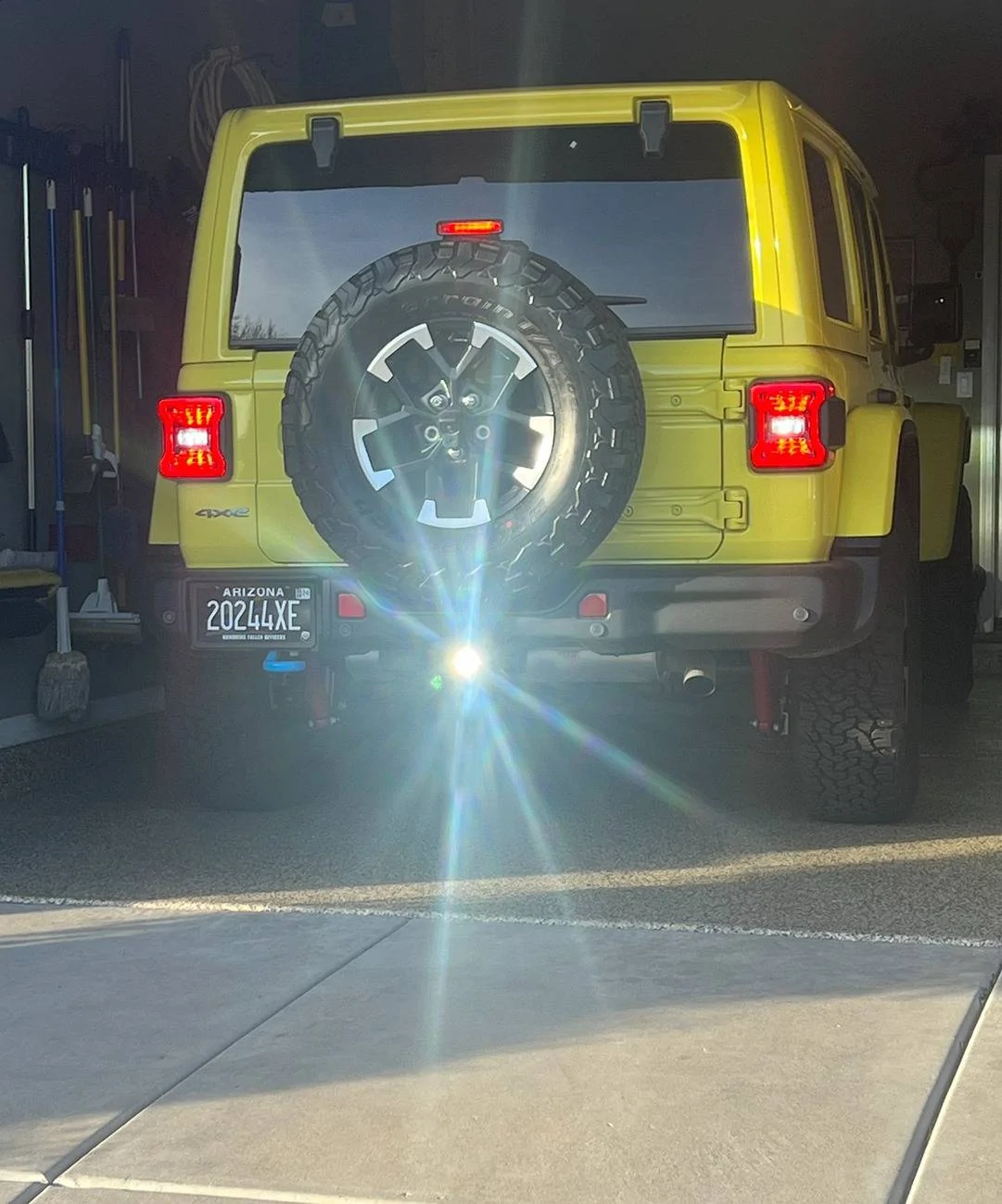

These Baja Designs ones will light up your world with 7,000 lumens.
Jeep Wrangler JL Reverse lights in rear bumper question 2024-12-02_07-38-08
