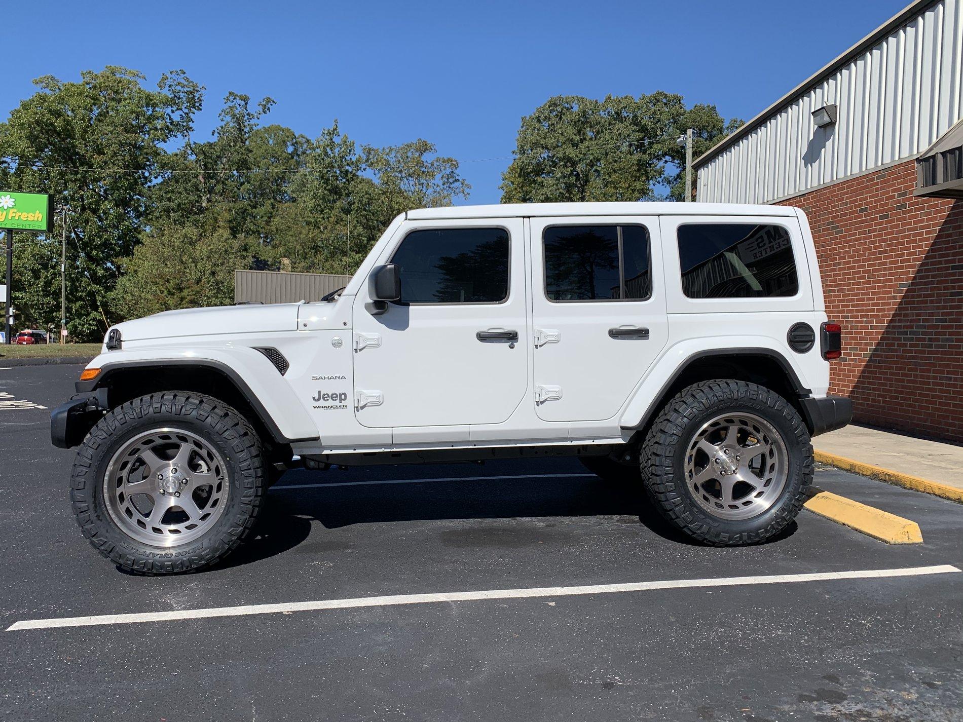

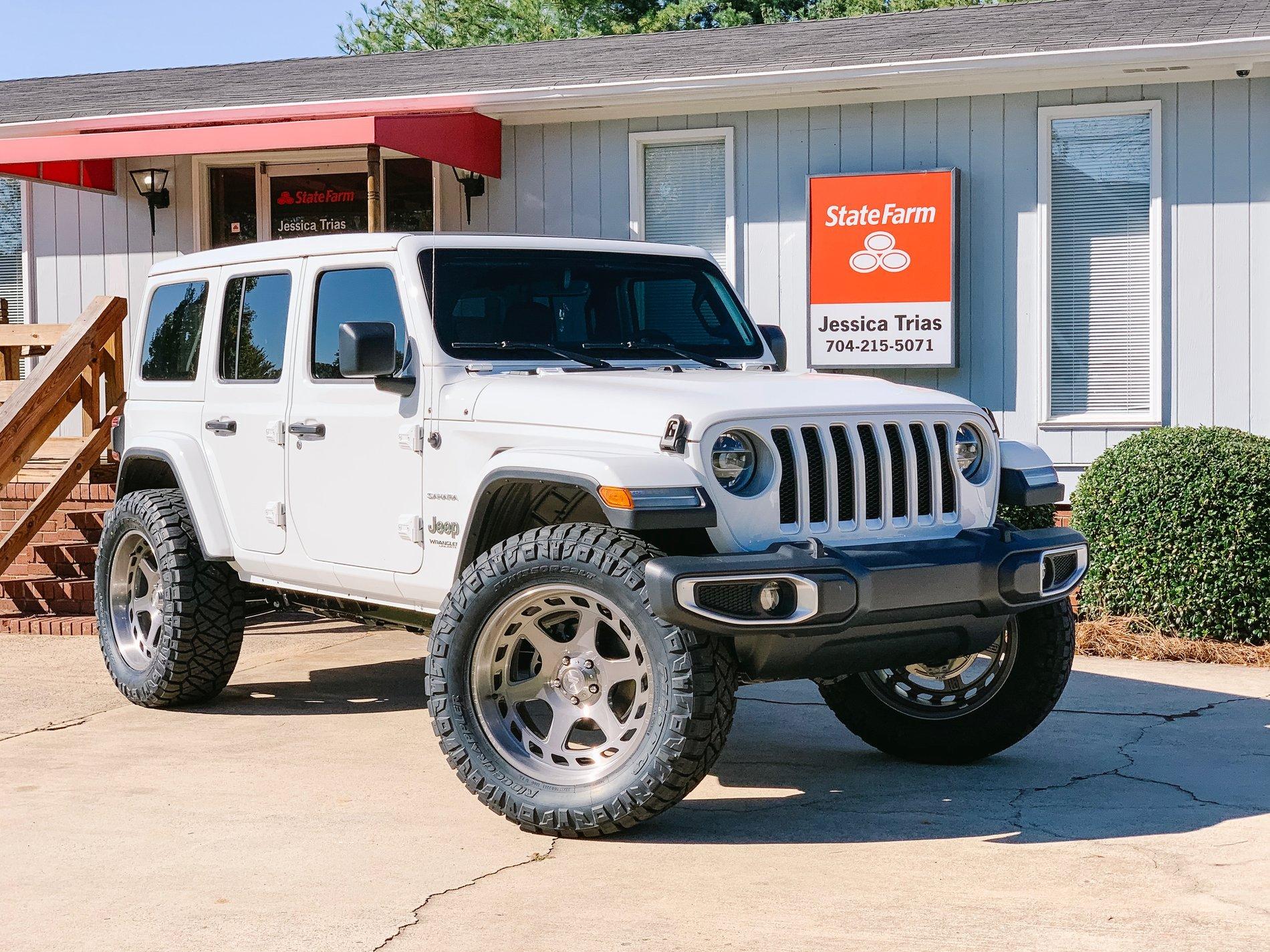

So I had everything installed on Wednesday and so far so good. My mpg is sitting at 19.4 average and I just drive back roads to my office and back. That turbo still has plenty of pop when needed and as long as I don’t hit 75mph+, my mpgs stay around the 18-19 mark. I can live with that. Some of you may not understand the “Florida” thing and that’s ok...there’s a market for everything or they wouldn’t be selling them. Thanks for all of the info and if down the line I feel like I need to regear, I probably will!

im glad you like it, do you care to share any pictures of your build? id like to see the result.

thanks for sharing - its definitely not nearly as obnoxious as some would have made it seem.

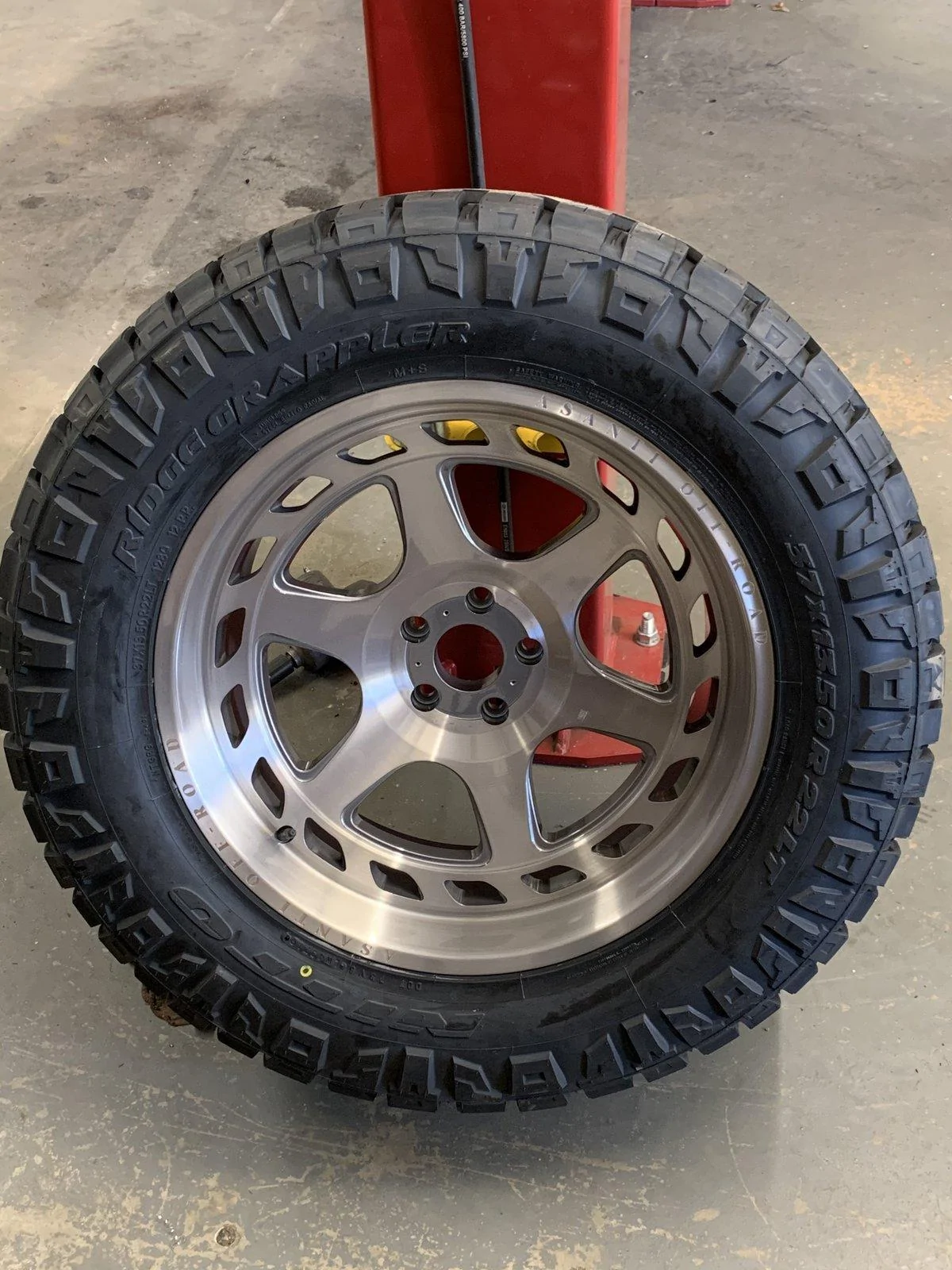

Hey everyone,
My husband and I just purchased a 2020 JL Sahara. This Jeep will be driven as a marketing vehicle back and forth from the office and home with an occasional trail ride. We just purchased a 3.5” lift, 22x10 wheels, along with some 37s. I don’t care if you think big wheels suck, you’re not paying for my additions so move along. I’ve heard and seen multiple people talk about regearing or not needing to but would like to hear more...should we or shouldn’t we? Oh, it’s the 2.0L turbo too...
With 22's it's obviously not going to spend time off road so your gearing probably is fine for cruising around, etc, etc.
