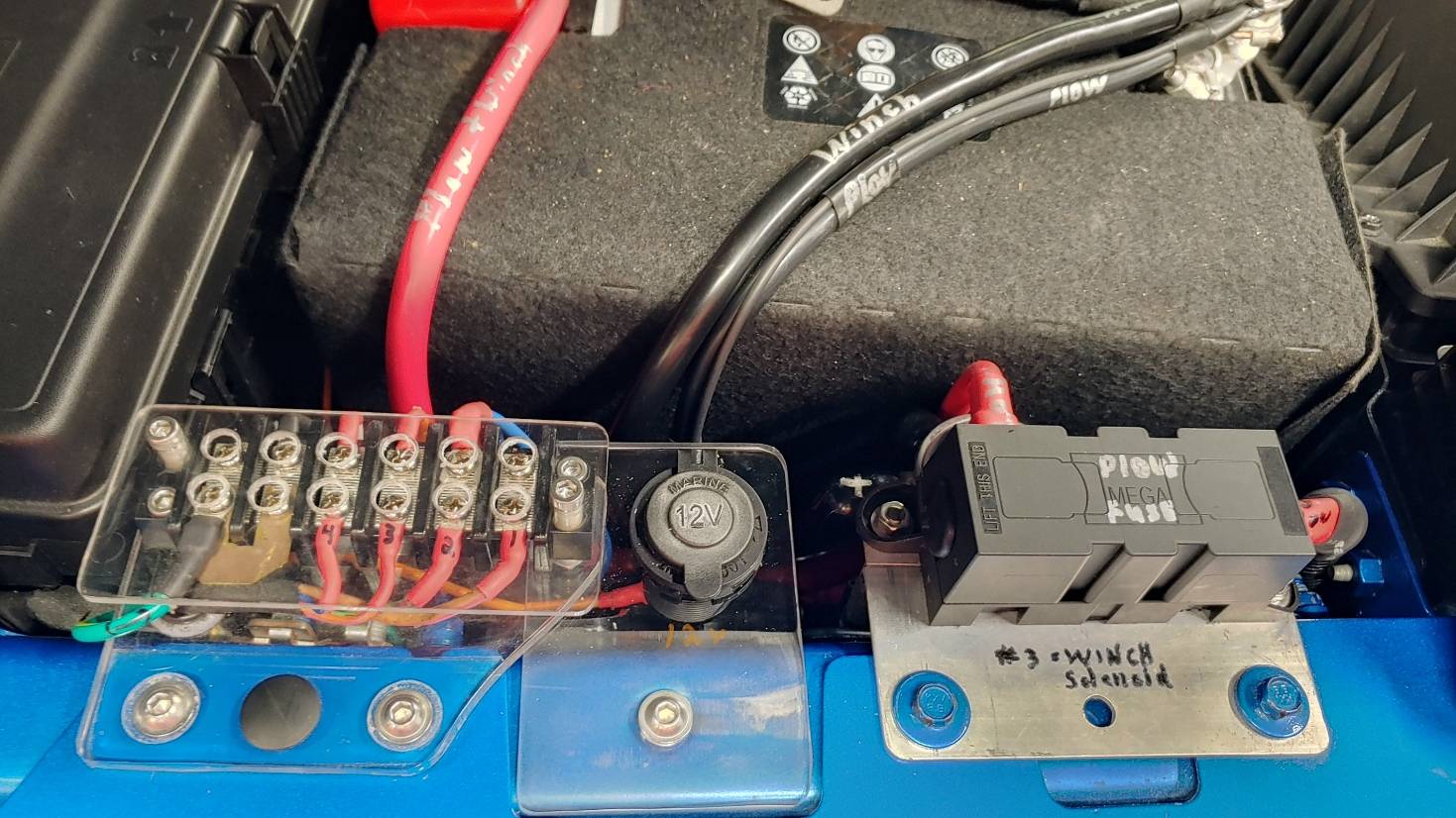

I have their struts on both my 2022 JT and our 2023 JLU 4xe
I did run into clearance issues with a bolt when the acrylic electric panel I made brought the head of the bolt up high enough for the strut body to hit.
In this picture it should be fine because that bracket isn't very thick. But bring that bolt up even a little higher and it will hit. I tested with clay to find out how much clearance there is - and it's not a lot because it does line up with those bolts.
Jeep Wrangler JL Redline Tuning Hood Struts 1696636114563
My solution was to countersink bolts with smaller heads into my acrylic for clearance with the cylinders. (winch solenoid is mounted on the aluminum bracket below the snow plow fuse)
I could not use the stock bolts with the tall heads on the acrylic - they hit the cylinder body.
