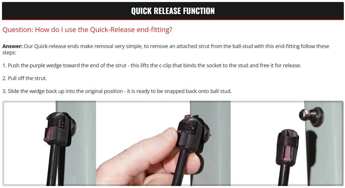

Took me way too long to figure out that you have to push down on the little red tab to release the lower part of the strut. For some reason this seemed counterintuitive to me. Pushing down should lock it in place, but instead, it spreads the clip inside.

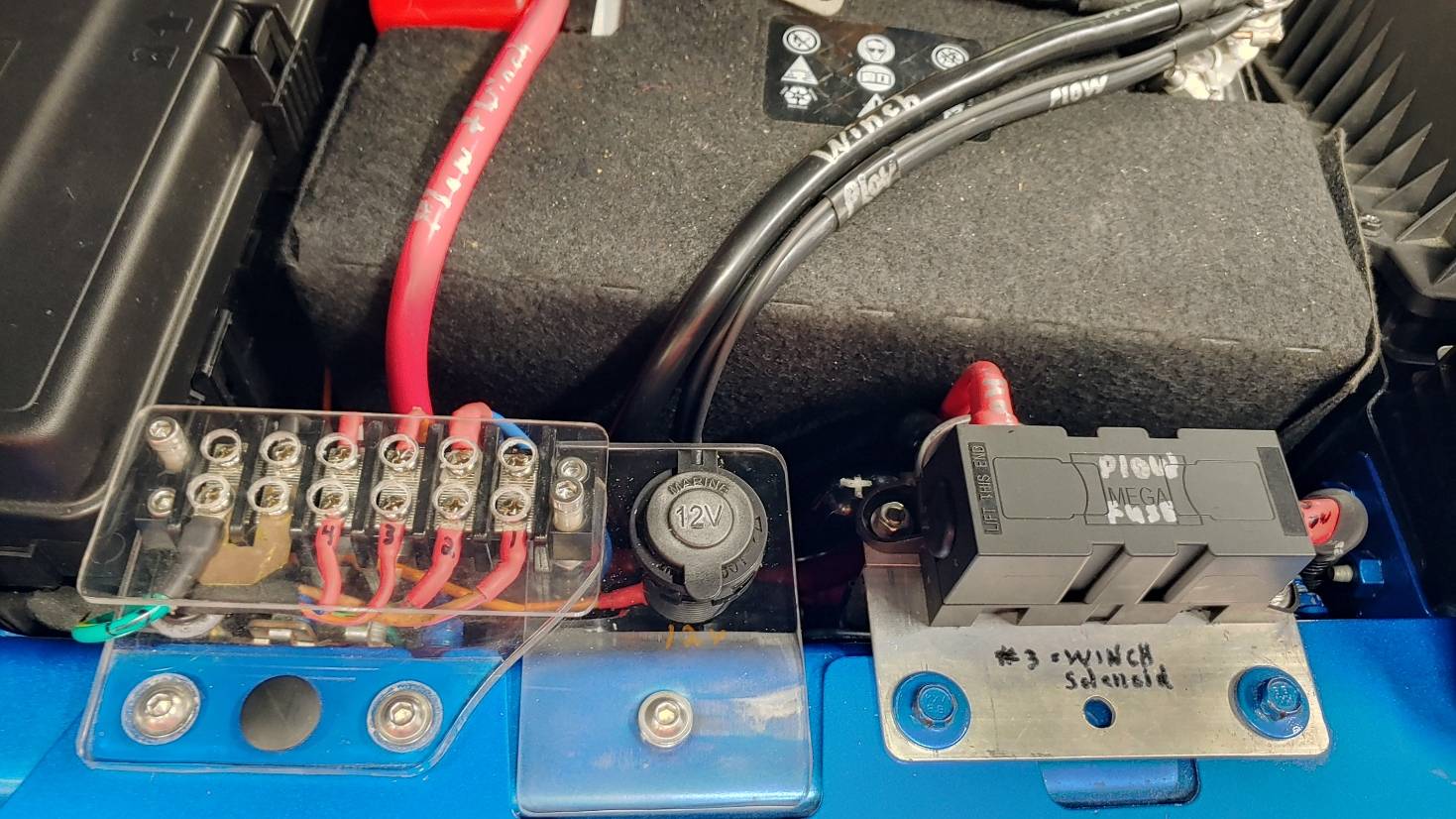

FYI, I can attest that the redline tuning struts do not interfere with locating the Warn winch solenoid next to the battery. Best mod I have made to my Jeep.
Won't interfere as long as you keep the bolt heads LOW. I had trouble and had to counter-sink the screws that hold my terminal strip and such - otherwise it would hit the bolt heads.
The acrylic I used was thick and it raised the bolts/screws up to just touch the struts.

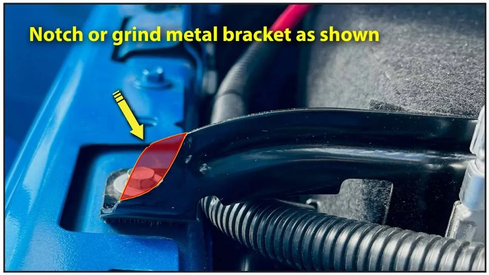

Did you have to trim one of the brackets under the hood? I think it’s on the passenger side. I’ve seen where one person on the 392 forum say they didn’t need to and another did.
I don't know if I HAD to but I trimmed that sucker up just in case. Been awhile since I cut anything on a Jeep so I was feeling a bit frisky. ?
Clears with a bunch of space all the way around. 2 minutes with a dremel and a sharpie and it is good to go!
For reference there is an FAQ on our website:
Jeep Wrangler JL Redline Tuning Hood Struts Quick Release Ends
Only for the Rubicon 392 do you need to trim away a small portion of this bracket on the passenger side to make clearance for the gas spring. All other Wrangler variants bolt in with zero modifications.
Jeep Wrangler JL Redline Tuning Hood Struts Jeep 392 bracket modification
