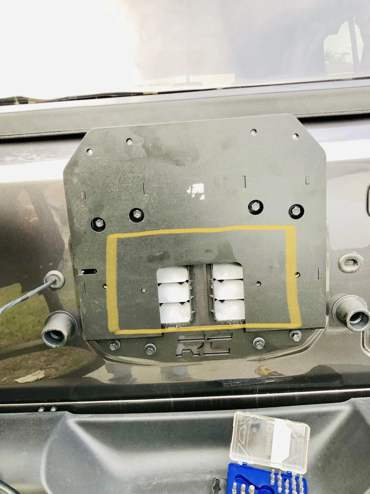

If you remove your spare and spare tire carrier you will see the vents there. I only know this because I had to install a spare tire relocation bracket. I may have taken photos let me check. I hope this helps!
Well I didn’t take photos of it bare, only after I put the relocation bracket on for some dumb reason but you can see the vent though. It’s about as big as the square I drew from what I remember..
Jeep Wrangler JL Rear side window just broke 61D505CE-2C30-44D5-BFC8-EF305F124303
Yes, I have 35s mounted and also a relocation bracket, had that installed with the lift. Not looking forward to take the spare off... :LOL::lipssealed::LOL:
