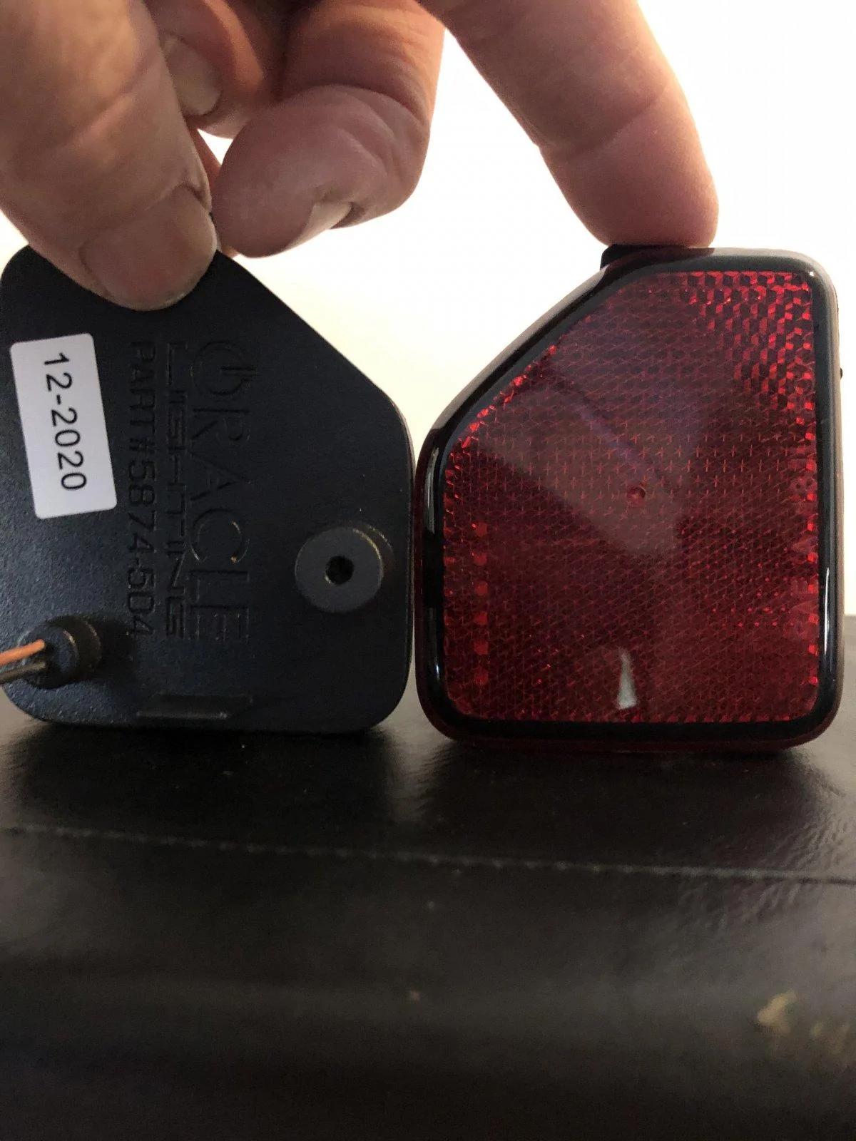

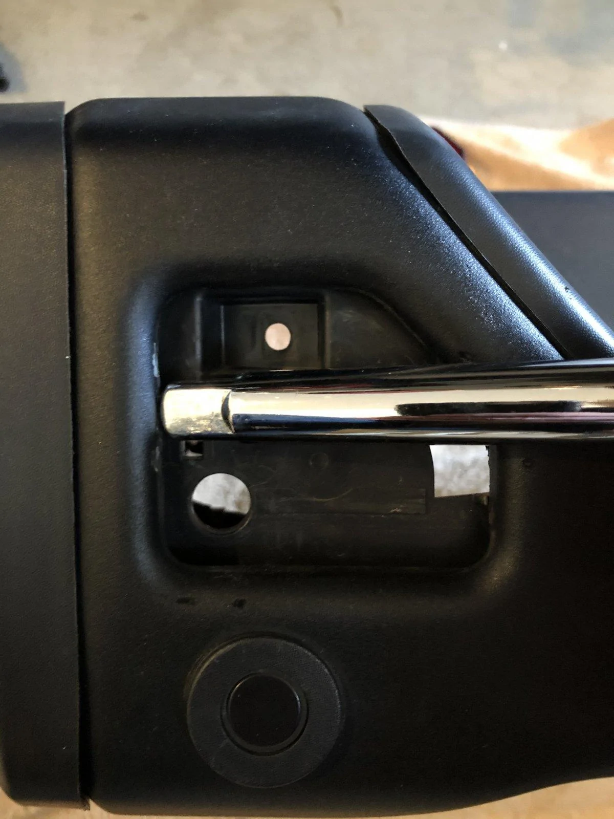

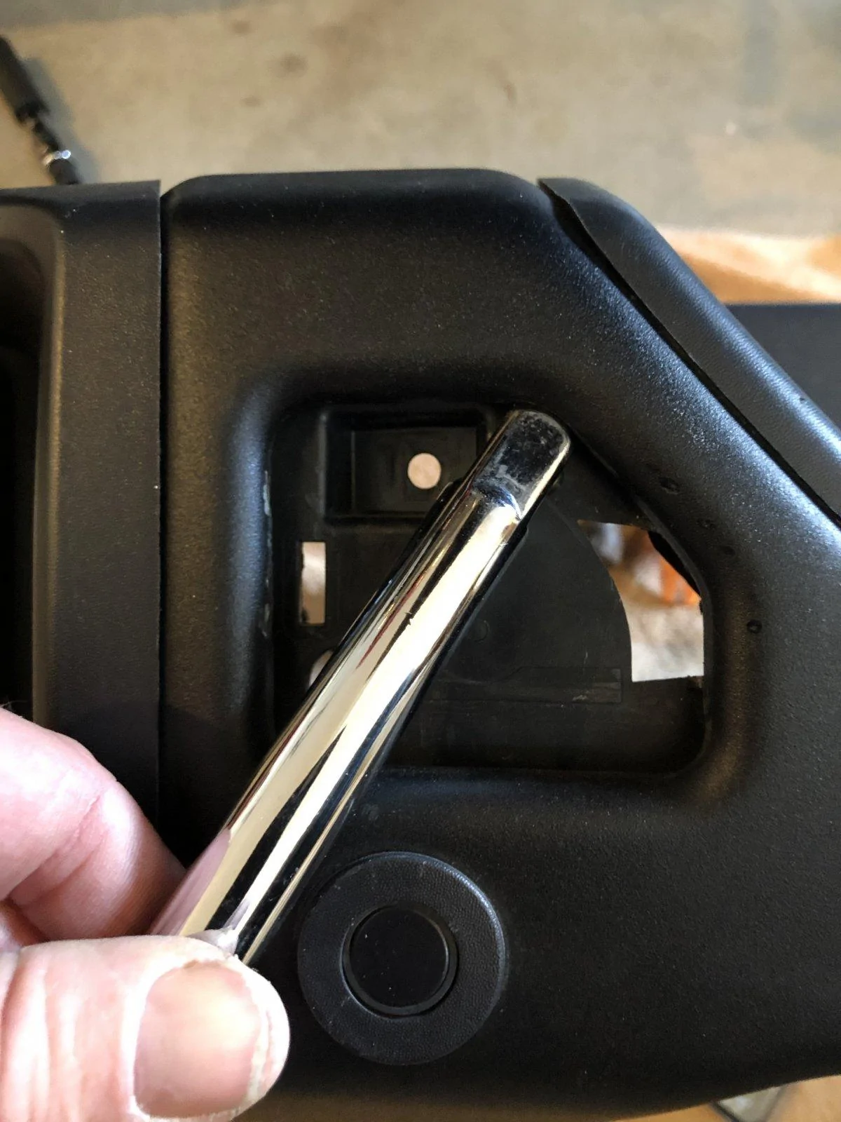

Trying to install mine at the moment. Passenger side went in with a snap. Driver's side, however, doesn't want to go. The Oracle's top width/shape is wider than OE reflector as you can see. I do not want to force it as the light will give before the steel bumper does. Anyone else see this?
Not sure the bumper opening can be spread but will give it a shot or two with persuader.
Update: gave opening corner and side a few solid shots with socket extension and hammer and managed to get it on. Time for a like touchup paint.

I had this issue also - I put lubricant on the metal bumper where they were hanging up and gave the lights a solid hit with my palm....they snapped in.

I had the exact same issue. Palm of my hand as well I was worried about the light cracking but so far so good.

I tried to get mine in using soapy water but it was not going and I was concerned about damaging the seal around the new light by hitting it hard. As it turned out, drivers side looks good BUT the passenger side, which snapped in easily, is fogged up. Sadly, it had only seen one water event and that was me washing the rig by hand, no power washer.
