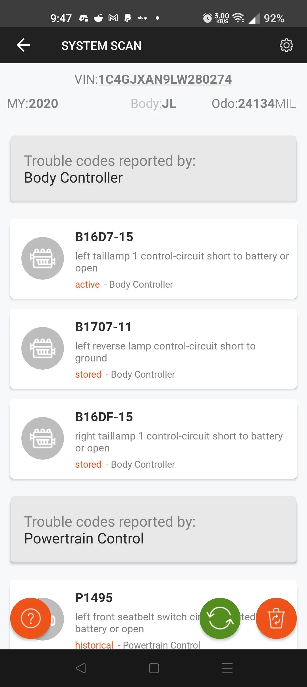

Well, this is what Jscan is telling me - care to comment @ORACLElights ?

Double check that each T-tap is fully seated and making sold connection. If all connections are solid, then take a moment to fill out our online warranty request here: https://www.oraclelights.com/RMA and someone from our customer service department will be in contact with you shortly. Thank you! DM us with your email address so I can follow up with our customer support team.
If the team gets back with any other steps, I'll post here.
