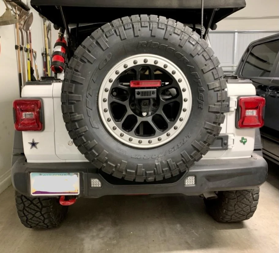

I installed mine last night. I was able to remove the reflectors but I wasn’t able to contort my hands to put the lights in. After 30 minutes of trying I decided to remove the bumper. 10-15 minutes and 10 16mm bolts later the bumper was off. 2 minutes later I got the lights bolted in and the bumper reinstalled in another 15-20 minutes. The lights work great a definite improvement. I wired mine directly to the reverse lights but will probably add a diode in the future so I can hook them to my auxiliary switches.
Knowing what I know now I would plan to go in planning to remove the bumper and it would have saved me time.

No I didn't remove the bumper, probably would have made life easier if I did. I did wire them to the reverse lights on both sides, which was pretty easy

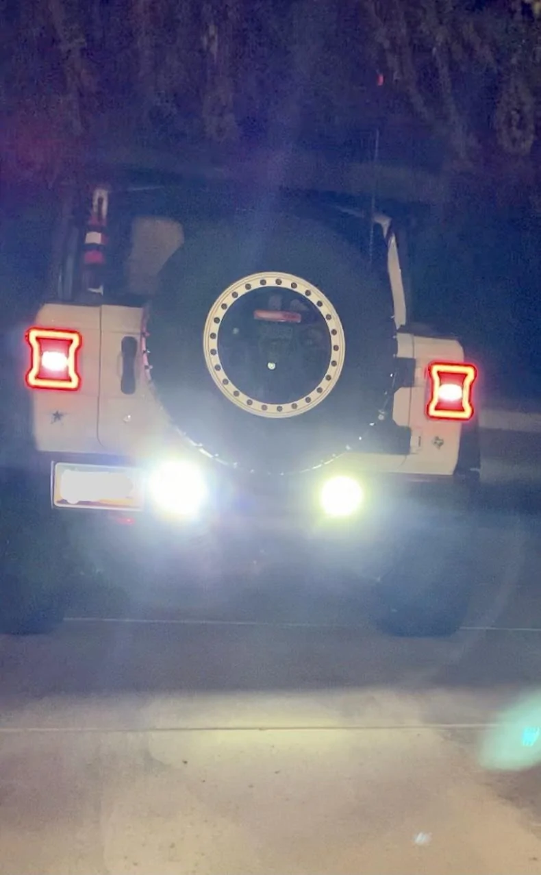

Has anyone stood behind these when they are on and seen if they are blinding to other people or if they point more at the ground? I don't want them blinding people as I back out of a parking space.

I did, and unless your Jeep is ultra lifted or the person behind you is super low it shouldn't be a direct shot to the eye. No denying they are bright, but I don't feel like it will be a common occurance to blind someone.
