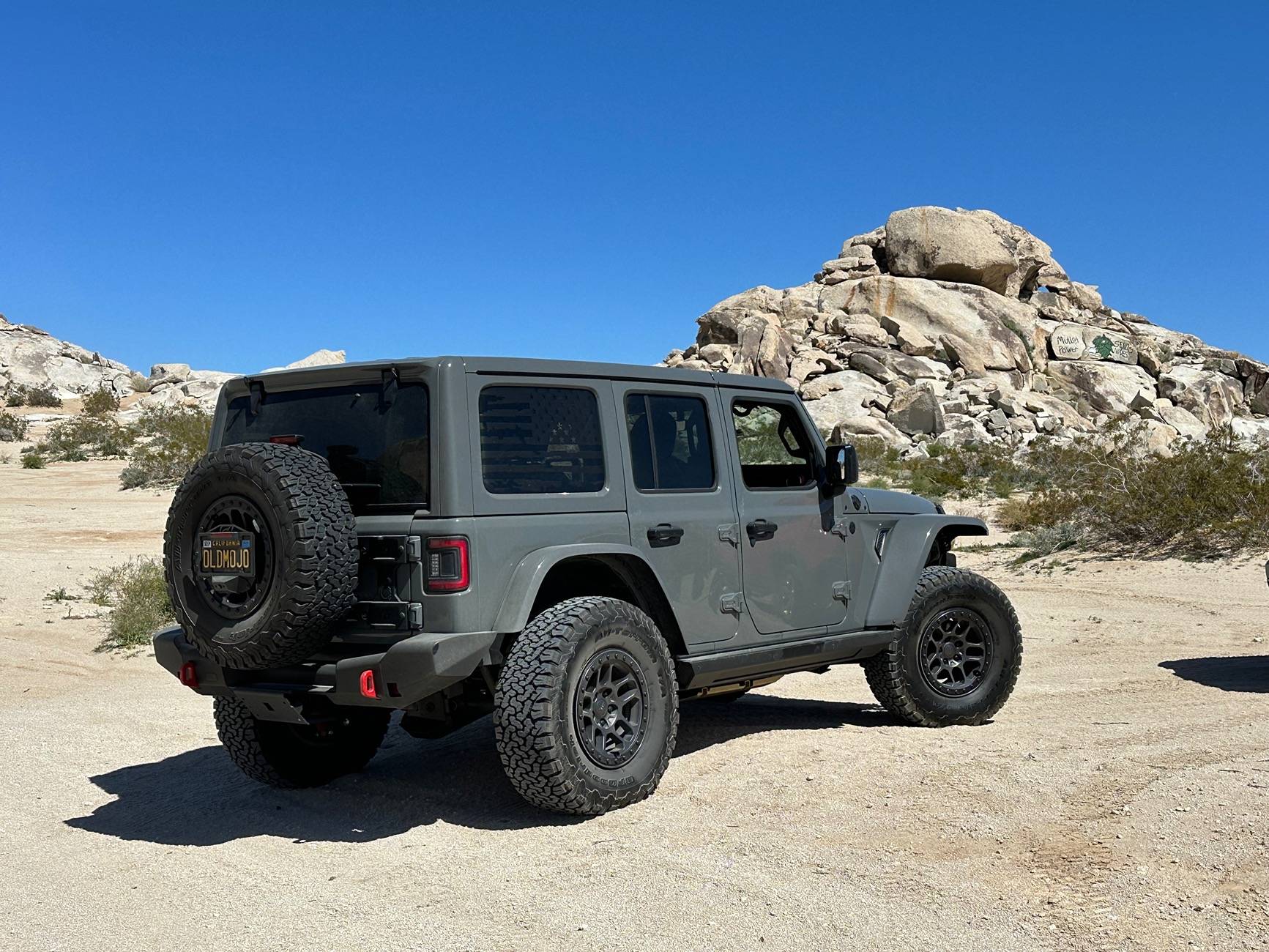

I really like the MetalCloak full width rear bumper, it's not only very robust with drastically improved departure angles but it's modular design and textured finish is a great aesthetic match to the OEM steel front bumper. (Once you ditch the gold bolts for black button head bolts that is!)

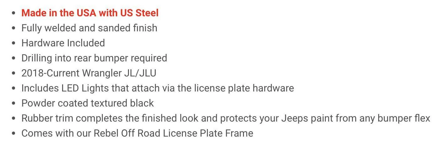

The mount is the Rebel rear mount for Jeep JL's and comes with two lights that also act as top license plate bolts, I chose not to use those as it has never been an issue around here, surprisingly there seems to be enough 'splash' lighting in this area to illuminate our reflective plates.
As for mounting the plate mount, I carefully measured and marked its location on the bumper and then drilled the bumper and installed nutserts for ease of installation and adjustment. I also used some small rubber stick-on bushings between the mount and bumper to insure just a bit of flex and eliminate any chance of rattles. Made in USA and sells for $100 dollars.
When I installed the bumper I opened and re-taped the bumper harness as needed and coiled up the license plate wiring below the bumper under the plate area for easy access if I ever do have to add them. I also have a thin profile license plate frame with a center light just in case,,,
Rebel Off Road JL Plate Mount:
